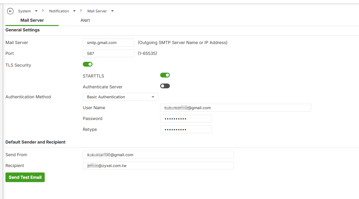

The user can navigate to System > Notification > Mail Server to complete the necessary configuration and ensure that emails can be sent normally.

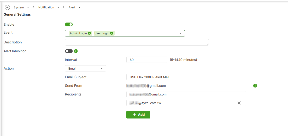

Then navigate to System > Notification > Alert to enable the setting. Select the “Admin Login” and “User Login” events, configure the email subject, specify the sender email address, and add the recipients.

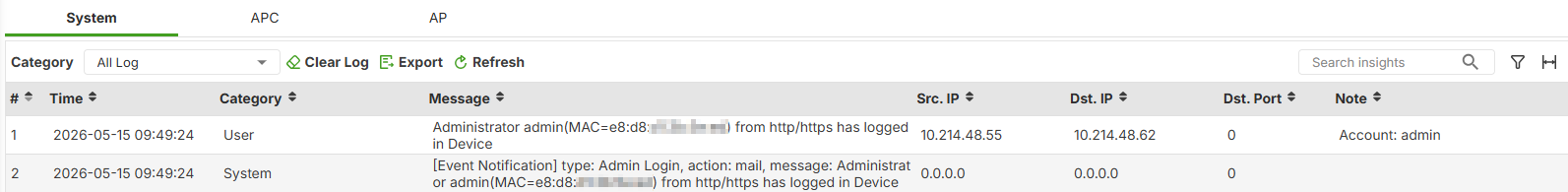

When a user login successfully, check the Log/Event section, which will display the corresponding log.

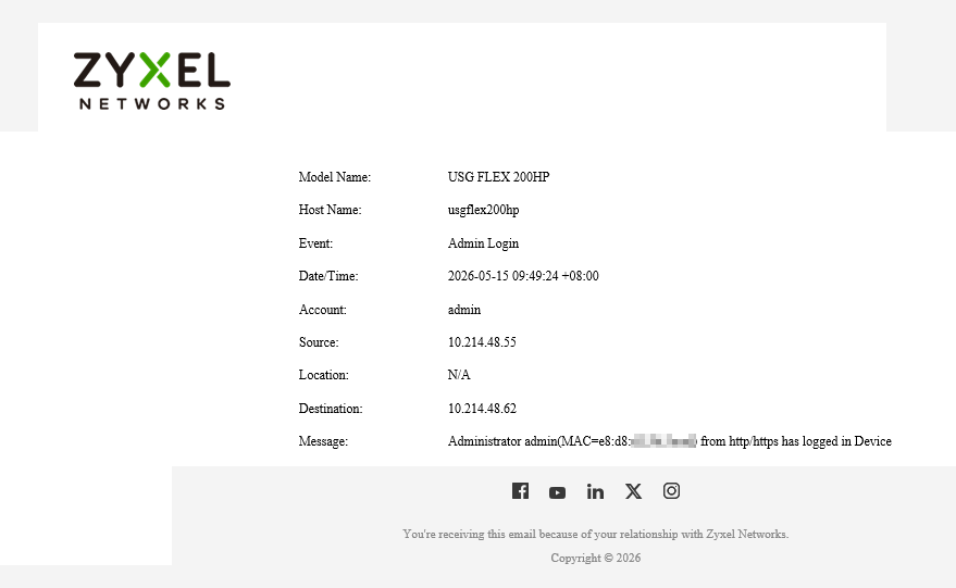

Then the recipient will receive the alert email.
