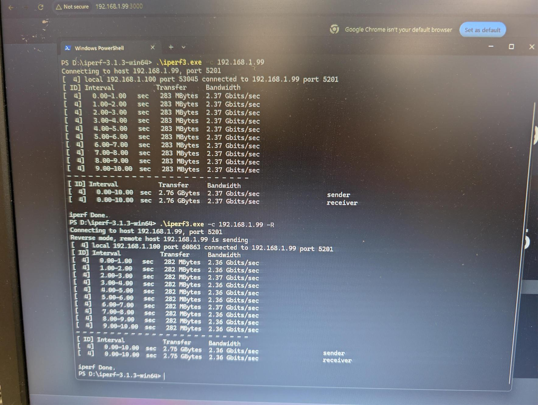

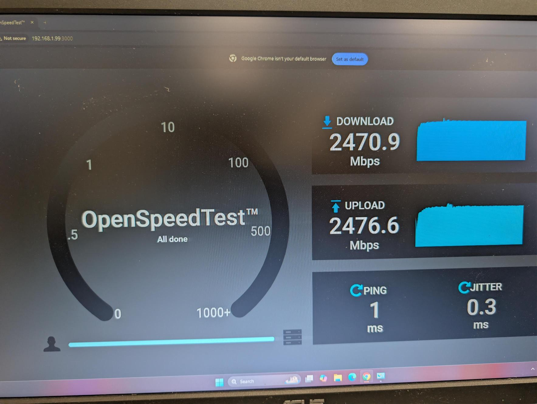

    Thanks for the information. I tested in my lab with two Windows 11 PCs, one is in 2.5G link and one is in 10G link to switch with SFP10G-T. Here are my results:
    Open speed test and iperf are both reaching 2.5G. SMB test is also around 270MB/s when downloading from the server. Therefore, your issue is more likely on the client side (HyperV Server). Please check your client's settings. Thanks!
