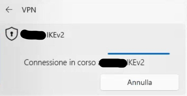

- when i launch the connection it hangs on "connection in progress" and never connects, nor gives error message

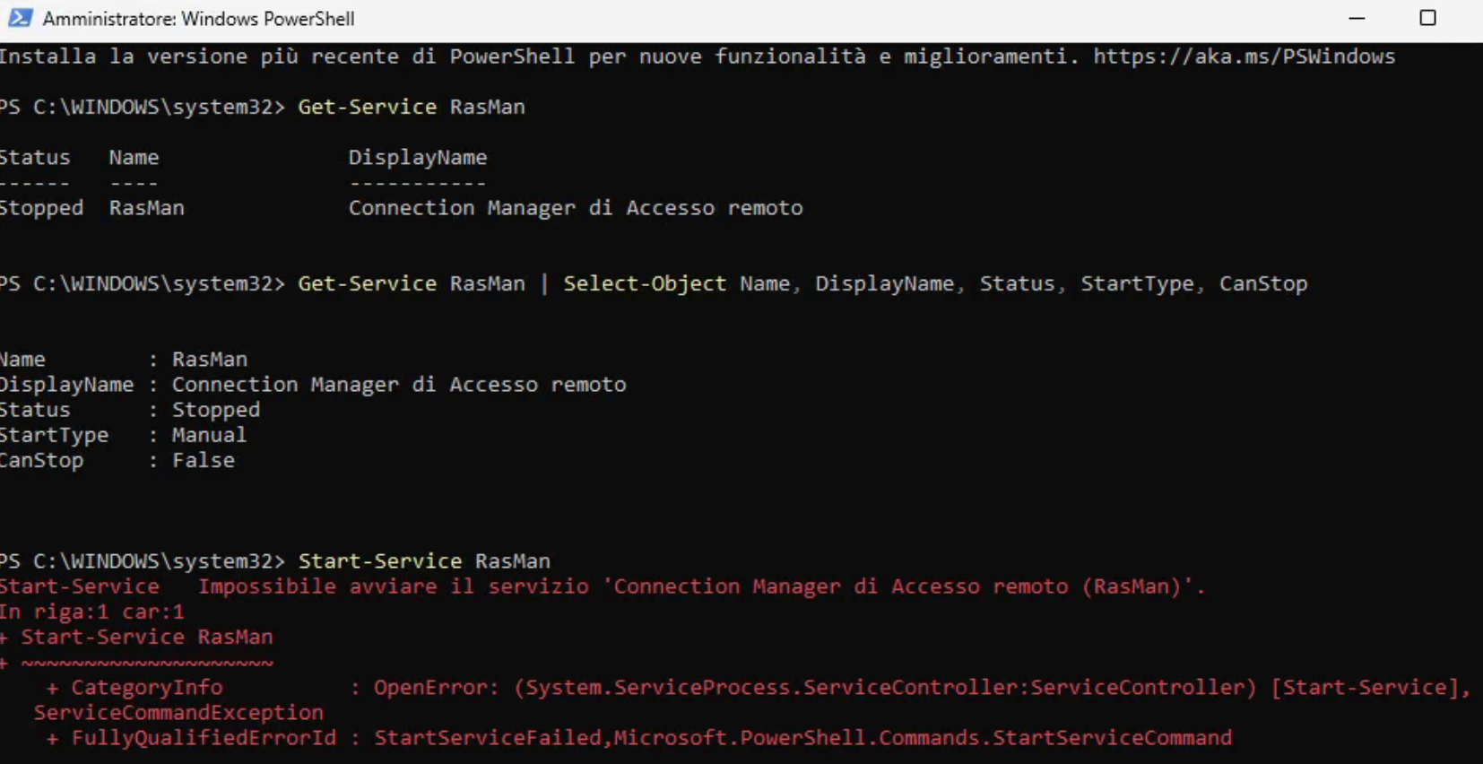

- RASMAN service is stopped and i cannot run it

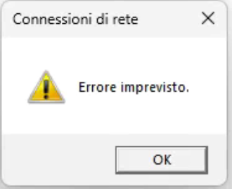

- if i right click proprierties on a connection in control panel i get a "unknown error" (errore imprevisto)
- even if a create any new VPN connection with the windows wizard (just inserting and ip user a password) when i right click proprierties i get "unknown error"

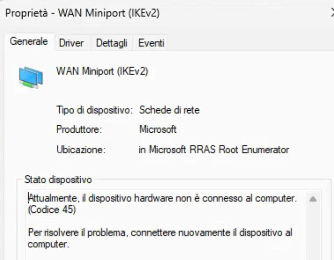

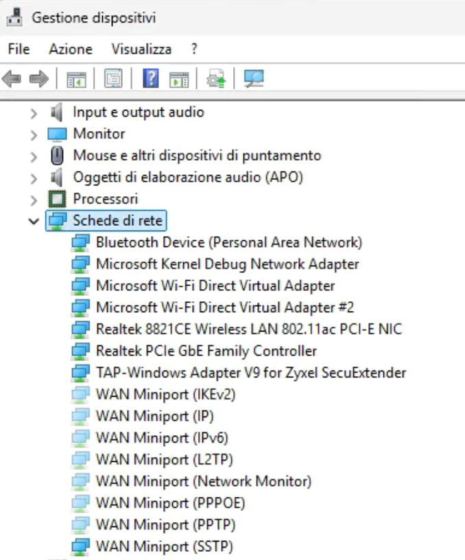

in device management i have almost all the miniports WAN in gray and with error code 45 (device disconnected)

if i delete the miniports wan in device management I am not able to reinstall them in any way

Checked the events log: 7023 Servizio Connection Manager di Accesso remoto terminato con l'errore: Impossibile trovare il file specificato. Remote Access Service Connnection Manager terminated with error: unable to find the specified file

    i have resetted TCP/IP but this didn't solve the issue. I still cannot run rasman service. (error 2)
