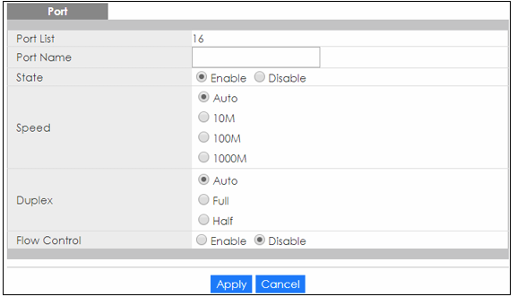

Please log in to the web interface and navigate to Configuration > Port > Port, then select the port showing 100M. Ensure the Speed/Duplex setting is configured to Auto. If a port is manually set to 100M, it will not negotiate to a higher speed.

All ports are set to speed/duplex auto. If I change port x (delivering 100M) from auto to 1G, the connection is dropped entirely.
