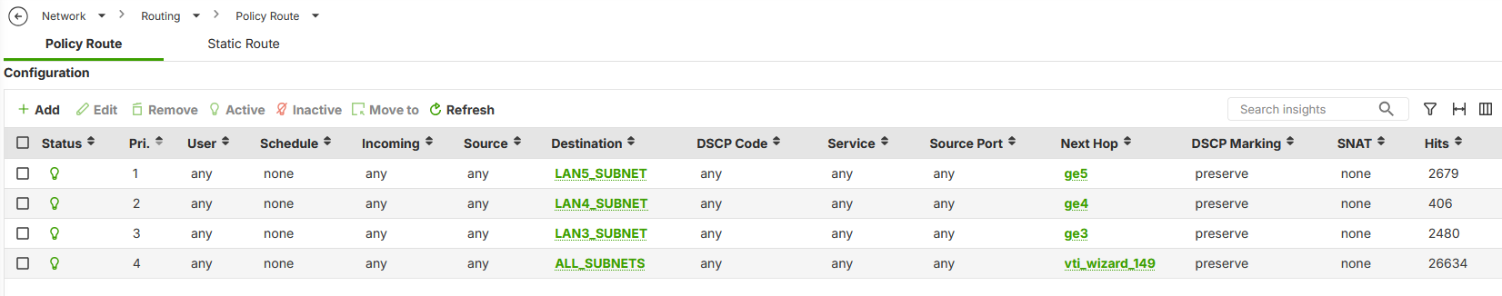

    Create the Bypass Policy Route (Rule 1)
    1. Navigate to Network > Routing > Policy Route.
    2. Click Add to create a new rule at the top of your policy routing table:
      • Source Address: 192.168.105.0/24 (LAN3)
      • Destination Address: Local_Exclusion_Subnets (the group you created in Step 1)
      • Next Hop > Type: ge4/ge5 (The interface of your destination address)
    Configure/Verify the VPN Policy Route (Rule 2)
    Make sure your VPN policy route is positioned below the bypass rule you created in Step 2.
    • Destination Address: Any (0.0.0.0/0)
    • Next Hop > Type: IPSec VPN Tunnel
    • IPSec VPN Tunnel: [Select your VPN Tunnel]
    With this configuration, any packet originating from LAN3 heading to LAN4 or LAN5 will hit the first rule and bypass the tunnel. All other traffic (including Internet traffic) will miss the first rule, hit the second rule, and successfully route through your IPSec VPN tunnel.
    Hope this helps!

    @Zyxel_Tina :
    I did as you explained, except in the Policy Route (Rule 1) I put directly LAN4_SUBNET (192.168.107.0/24) for the Destination Address (and ge4 interface for Next Hop)
    I'm afraid this Zywall doesn't seem to work like that.
    Computer 1 gets answers from computer 2 whether Rule 1 is active or not.
    If Rule 2 is inactive I have internet (from local internet connection according to whatsmyip - which is logical)
    If Rule 2 is active ... I don't have internet access anymore.
    Note: If I put back 0.0.0.0/0 as the remote subnet for the IPSec VPN, I have internet, and whatsmyip gives the ip address of the remote site - which is what I want.

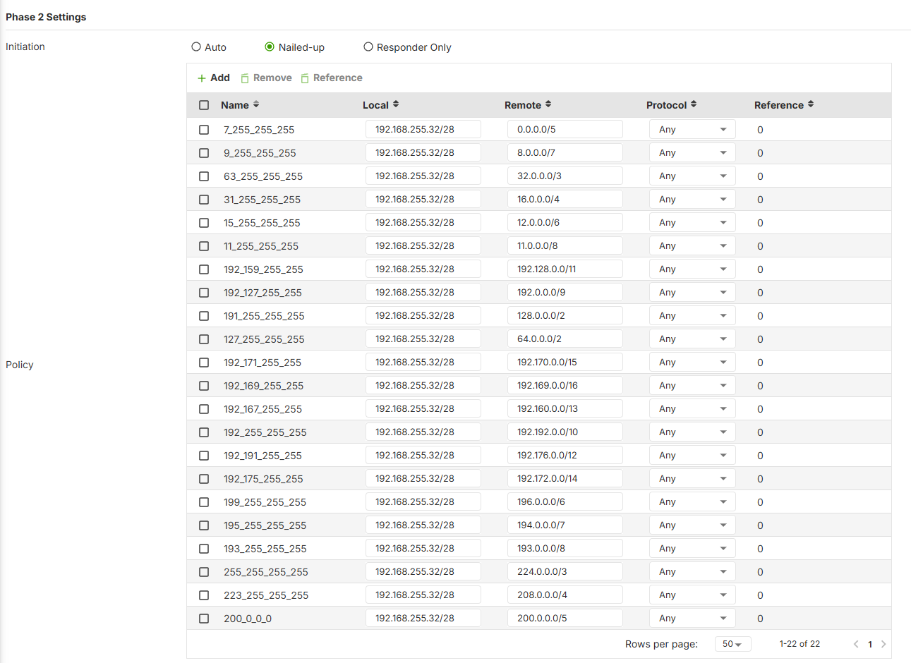

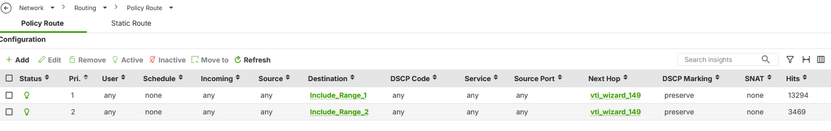

    So there is a way round this but not pretty by doing this
    exclude 10.0.0.0/8 and 192.168.0.0/16
    problem is both ends need to support many subnet Policy
    So you don't have to have the other end do all these policies but the FLEX 200H has a limit of 10 where as the FLEX700H can do many more as shown.
    / vrf "main" ike vpn "testvpn" security-policy "7_255_255_255"

    / vrf "main" ike vpn "testvpn" security-policy "192_127_255_255" local-ts "subnet" "192.168.255.32/28"
    / vrf "main" ike vpn "testvpn" security-policy "192_127_255_255" remote-ts "subnet" "192.0.0.0/9"
    / vrf "main" ike vpn "testvpn" security-policy "192_127_255_255" "action" "esp"
    / vrf "main" ike vpn "testvpn" security-policy "192_127_255_255" "mode" "tunnel"
    / vrf "main" ike vpn "testvpn" security-policy "192_127_255_255" "priority" "0"
    / vrf "main" ike vpn "testvpn" security-policy "192_127_255_255" "vti-mark-in" "0"
    / vrf "main" ike vpn "testvpn" security-policy "192_127_255_255" "vti-mark-out" "0"
    / vrf "main" ike vpn "testvpn" security-policy "191_255_255_255"
    / vrf "main" ike vpn "testvpn" security-policy "191_255_255_255" local-ts "subnet" "192.168.255.32/28"
    / vrf "main" ike vpn "testvpn" security-policy "191_255_255_255" remote-ts "subnet" "128.0.0.0/2"
    / vrf "main" ike vpn "testvpn" security-policy "191_255_255_255" "action" "esp"
    / vrf "main" ike vpn "testvpn" security-policy "191_255_255_255" "mode" "tunnel"
    / vrf "main" ike vpn "testvpn" security-policy "191_255_255_255" "priority" "0"
    / vrf "main" ike vpn "testvpn" security-policy "191_255_255_255" "vti-mark-in" "0"
    / vrf "main" ike vpn "testvpn" security-policy "191_255_255_255" "vti-mark-out" "0"
    / vrf "main" ike vpn "testvpn" security-policy "127_255_255_255"
    / vrf "main" ike vpn "testvpn" security-policy "127_255_255_255" local-ts "subnet" "192.168.255.32/28"
    / vrf "main" ike vpn "testvpn" security-policy "127_255_255_255" remote-ts "subnet" "64.0.0.0/2"
    / vrf "main" ike vpn "testvpn" security-policy "127_255_255_255" "action" "esp"
    / vrf "main" ike vpn "testvpn" security-policy "127_255_255_255" "mode" "tunnel"
    / vrf "main" ike vpn "testvpn" security-policy "127_255_255_255" "priority" "0"
    / vrf "main" ike vpn "testvpn" security-policy "127_255_255_255" "vti-mark-in" "0"
    / vrf "main" ike vpn "testvpn" security-policy "127_255_255_255" "vti-mark-out" "0"
    / vrf "main" ike vpn "testvpn" security-policy "192_171_255_255"
    / vrf "main" ike vpn "testvpn" security-policy "192_171_255_255" local-ts "subnet" "192.168.255.32/28"
    / vrf "main" ike vpn "testvpn" security-policy "192_171_255_255" remote-ts "subnet" "192.170.0.0/15"
    / vrf "main" ike vpn "testvpn" security-policy "192_171_255_255" "action" "esp"
    / vrf "main" ike vpn "testvpn" security-policy "192_171_255_255" "mode" "tunnel"
    / vrf "main" ike vpn "testvpn" security-policy "192_171_255_255" "priority" "0"
    / vrf "main" ike vpn "testvpn" security-policy "192_171_255_255" "vti-mark-in" "0"
    / vrf "main" ike vpn "testvpn" security-policy "192_171_255_255" "vti-mark-out" "0"
    / vrf "main" ike vpn "testvpn" security-policy "192_169_255_255"
    / vrf "main" ike vpn "testvpn" security-policy "192_169_255_255" local-ts "subnet" "192.168.255.32/28"
    / vrf "main" ike vpn "testvpn" security-policy "192_169_255_255" remote-ts "subnet" "192.169.0.0/16"
    / vrf "main" ike vpn "testvpn" security-policy "192_169_255_255" "action" "esp"
    / vrf "main" ike vpn "testvpn" security-policy "192_169_255_255" "mode" "tunnel"
    / vrf "main" ike vpn "testvpn" security-policy "192_169_255_255" "priority" "0"
    / vrf "main" ike vpn "testvpn" security-policy "192_169_255_255" "vti-mark-in" "0"
    / vrf "main" ike vpn "testvpn" security-policy "192_169_255_255" "vti-mark-out" "0"
    / vrf "main" ike vpn "testvpn" security-policy "192_167_255_255"
    / vrf "main" ike vpn "testvpn" security-policy "192_167_255_255" local-ts "subnet" "192.168.255.32/28"
    / vrf "main" ike vpn "testvpn" security-policy "192_167_255_255" remote-ts "subnet" "192.160.0.0/13"
    / vrf "main" ike vpn "testvpn" security-policy "192_167_255_255" "action" "esp"
    / vrf "main" ike vpn "testvpn" security-policy "192_167_255_255" "mode" "tunnel"
    / vrf "main" ike vpn "testvpn" security-policy "192_167_255_255" "priority" "0"
    / vrf "main" ike vpn "testvpn" security-policy "192_167_255_255" "vti-mark-in" "0"
    / vrf "main" ike vpn "testvpn" security-policy "192_167_255_255" "vti-mark-out" "0"
    / vrf "main" ike vpn "testvpn" security-policy "192_255_255_255"
    / vrf "main" ike vpn "testvpn" security-policy "192_255_255_255" local-ts "subnet" "192.168.255.32/28"
    / vrf "main" ike vpn "testvpn" security-policy "192_255_255_255" remote-ts "subnet" "192.192.0.0/10"
    / vrf "main" ike vpn "testvpn" security-policy "192_255_255_255" "action" "esp"
    / vrf "main" ike vpn "testvpn" security-policy "192_255_255_255" "mode" "tunnel"
    / vrf "main" ike vpn "testvpn" security-policy "192_255_255_255" "priority" "0"
    / vrf "main" ike vpn "testvpn" security-policy "192_255_255_255" "vti-mark-in" "0"
    / vrf "main" ike vpn "testvpn" security-policy "192_255_255_255" "vti-mark-out" "0"
    / vrf "main" ike vpn "testvpn" security-policy "192_191_255_255"
    / vrf "main" ike vpn "testvpn" security-policy "192_191_255_255" local-ts "subnet" "192.168.255.32/28"
    / vrf "main" ike vpn "testvpn" security-policy "192_191_255_255" remote-ts "subnet" "192.176.0.0/12"
    / vrf "main" ike vpn "testvpn" security-policy "192_191_255_255" "action" "esp"
    / vrf "main" ike vpn "testvpn" security-policy "192_191_255_255" "mode" "tunnel"
    / vrf "main" ike vpn "testvpn" security-policy "192_191_255_255" "priority" "0"
    / vrf "main" ike vpn "testvpn" security-policy "192_191_255_255" "vti-mark-in" "0"
    / vrf "main" ike vpn "testvpn" security-policy "192_191_255_255" "vti-mark-out" "0"
    / vrf "main" ike vpn "testvpn" security-policy "192_175_255_255"
    / vrf "main" ike vpn "testvpn" security-policy "192_175_255_255" local-ts "subnet" "192.168.255.32/28"
    / vrf "main" ike vpn "testvpn" security-policy "192_175_255_255" remote-ts "subnet" "192.172.0.0/14"
    / vrf "main" ike vpn "testvpn" security-policy "192_175_255_255" "action" "esp"
    / vrf "main" ike vpn "testvpn" security-policy "192_175_255_255" "mode" "tunnel"
    / vrf "main" ike vpn "testvpn" security-policy "192_175_255_255" "priority" "0"
    / vrf "main" ike vpn "testvpn" security-policy "192_175_255_255" "vti-mark-in" "0"
    / vrf "main" ike vpn "testvpn" security-policy "192_175_255_255" "vti-mark-out" "0"
    / vrf "main" ike vpn "testvpn" security-policy "199_255_255_255"
    / vrf "main" ike vpn "testvpn" security-policy "199_255_255_255" local-ts "subnet" "192.168.255.32/28"
    / vrf "main" ike vpn "testvpn" security-policy "199_255_255_255" remote-ts "subnet" "196.0.0.0/6"
    / vrf "main" ike vpn "testvpn" security-policy "199_255_255_255" "action" "esp"
    / vrf "main" ike vpn "testvpn" security-policy "199_255_255_255" "mode" "tunnel"
    / vrf "main" ike vpn "testvpn" security-policy "199_255_255_255" "priority" "0"
    / vrf "main" ike vpn "testvpn" security-policy "199_255_255_255" "vti-mark-in" "0"
    / vrf "main" ike vpn "testvpn" security-policy "199_255_255_255" "vti-mark-out" "0"
    / vrf "main" ike vpn "testvpn" security-policy "195_255_255_255"
    / vrf "main" ike vpn "testvpn" security-policy "195_255_255_255" local-ts "subnet" "192.168.255.32/28"
    / vrf "main" ike vpn "testvpn" security-policy "195_255_255_255" remote-ts "subnet" "194.0.0.0/7"
    / vrf "main" ike vpn "testvpn" security-policy "195_255_255_255" "action" "esp"
    / vrf "main" ike vpn "testvpn" security-policy "195_255_255_255" "mode" "tunnel"
    / vrf "main" ike vpn "testvpn" security-policy "195_255_255_255" "priority" "0"
    / vrf "main" ike vpn "testvpn" security-policy "195_255_255_255" "vti-mark-in" "0"
    / vrf "main" ike vpn "testvpn" security-policy "195_255_255_255" "vti-mark-out" "0"
    / vrf "main" ike vpn "testvpn" security-policy "193_255_255_255"
    / vrf "main" ike vpn "testvpn" security-policy "193_255_255_255" local-ts "subnet" "192.168.255.32/28"
    / vrf "main" ike vpn "testvpn" security-policy "193_255_255_255" remote-ts "subnet" "193.0.0.0/8"
    / vrf "main" ike vpn "testvpn" security-policy "193_255_255_255" "action" "esp"
    / vrf "main" ike vpn "testvpn" security-policy "193_255_255_255" "mode" "tunnel"
    / vrf "main" ike vpn "testvpn" security-policy "193_255_255_255" "priority" "0"
    / vrf "main" ike vpn "testvpn" security-policy "193_255_255_255" "vti-mark-in" "0"
    / vrf "main" ike vpn "testvpn" security-policy "193_255_255_255" "vti-mark-out" "0"
    / vrf "main" ike vpn "testvpn" security-policy "255_255_255_255"
    / vrf "main" ike vpn "testvpn" security-policy "255_255_255_255" local-ts "subnet" "192.168.255.32/28"
    / vrf "main" ike vpn "testvpn" security-policy "255_255_255_255" remote-ts "subnet" "224.0.0.0/3"
    / vrf "main" ike vpn "testvpn" security-policy "255_255_255_255" "action" "esp"
    / vrf "main" ike vpn "testvpn" security-policy "255_255_255_255" "mode" "tunnel"
    / vrf "main" ike vpn "testvpn" security-policy "255_255_255_255" "priority" "0"
    / vrf "main" ike vpn "testvpn" security-policy "255_255_255_255" "vti-mark-in" "0"
    / vrf "main" ike vpn "testvpn" security-policy "255_255_255_255" "vti-mark-out" "0"
    / vrf "main" ike vpn "testvpn" security-policy "223_255_255_255"
    / vrf "main" ike vpn "testvpn" security-policy "223_255_255_255" local-ts "subnet" "192.168.255.32/28"
    / vrf "main" ike vpn "testvpn" security-policy "223_255_255_255" remote-ts "subnet" "208.0.0.0/4"
    / vrf "main" ike vpn "testvpn" security-policy "223_255_255_255" "action" "esp"
    / vrf "main" ike vpn "testvpn" security-policy "223_255_255_255" "mode" "tunnel"
    / vrf "main" ike vpn "testvpn" security-policy "223_255_255_255" "priority" "0"
    / vrf "main" ike vpn "testvpn" security-policy "223_255_255_255" "vti-mark-in" "0"
    / vrf "main" ike vpn "testvpn" security-policy "223_255_255_255" "vti-mark-out" "0"
    / vrf "main" ike vpn "testvpn" security-policy "200_0_0_0"
    / vrf "main" ike vpn "testvpn" security-policy "200_0_0_0" local-ts "subnet" "192.168.255.32/28"
    / vrf "main" ike vpn "testvpn" security-policy "200_0_0_0" remote-ts "subnet" "200.0.0.0/5"
    / vrf "main" ike vpn "testvpn" security-policy "200_0_0_0" "action" "esp"
    / vrf "main" ike vpn "testvpn" security-policy "200_0_0_0" "mode" "tunnel"
    / vrf "main" ike vpn "testvpn" security-policy "200_0_0_0" "priority" "0"
    / vrf "main" ike vpn "testvpn" security-policy "200_0_0_0" "vti-mark-in" "0"
    / vrf "main" ike vpn "testvpn" security-policy "200_0_0_0" "vti-mark-out" "0"

    I tried the route-based vpn tunnel you suggested .
    This time the Zywall used the static routes I defined.
    I tried creating static routes with destination on the remote network, with the vti_wizard_xxx interface as next hop, it worked, I got answers. Internet works. Computer 2 replies to computer 1.
    If I do a tracert from computer 1 to a remote ip address, it shows the remote vti adress in the path so I guess it's configured correctly.
    So there is progress.
    Except that as soon as I create a static route with a destination 0.0.0.0/0 (to send all traffic through the vpn tunnel, including internet, as I want), the zywall stops routing anything. I don't get any reply anymore, not even the one I got so far with the other still present static routes (which are, btw, of higher priority). I don't even have internet access anymore. Computer 2 doesn't even ping its GW ! So not even local routing !
    If I remove this route, everything works again. Except it's NOT how I want it.
    So, I'm sorry, it still doesn't work ...

    Yes what I said works but its a silly way due to the FLEX H strict routeing when it comes to VPN policies like I said the old ZLD models don't have this limitation logic as I believe they auto exclude all subnets on the USG when using 0.0.0.0/0.
    so really Zyxel does need to look into this, the uOS is still new and Zyxel may make changes for the better but cause a limitation I get their target is security with the uOS hardware its also performance but I see no issue with auto exclude all subnets on the USG when using 0.0.0.0/0 for policy routes for VPN.
    The only other thing that can be done due to Zyxel putting a limit on number of policy routes on lower models is IP ranges
    edit
    In fact ranges on ZLD models is a supported thing so Zyxel could look to add it to uOS you would just do like:
    local 192.168.255.32/28 remote 0.0.00-9.255.255.255
    local 192.168.255.32/28 remote 11.0.0.0-192.167.255.255
    local 192.168.255.32/28 remote 192.169.0.0-255.255.255.255
    plus any other routes you need to add
    not sure of the FLEX 50H has lower limits on policy routes adding for VPN

    A minor correction to what I said previously: with a static route destination 0.0.0.0/0, Computer 2 still pings its GW and even replies to computer 1 so local routing is still working (I had forgotten the security policy). But it's the only thing still working (I checked again) and it doesn't change the problem.
    @PeterUK :
    I agree with you about local subnets being excluded when using 0.0.0.0/0. That's the initial problem I have. Frankly, I find silly to send away (through the VPN tunnel) traffic for local, directly connect subnets. I don't understand the reason.
    To use a metaphor, it's like when you're in your living room and want to go to your bedroom, you don't go out of your house and in the street.
    It's a good idea to use range … except the Zywall 50H doesn't accept ranges in static routes (only subnets and hosts).
    And I want the private subnets (rfc 1918) to be sent through the tunnel too. Absolutely everything except the local directly connects ones.
