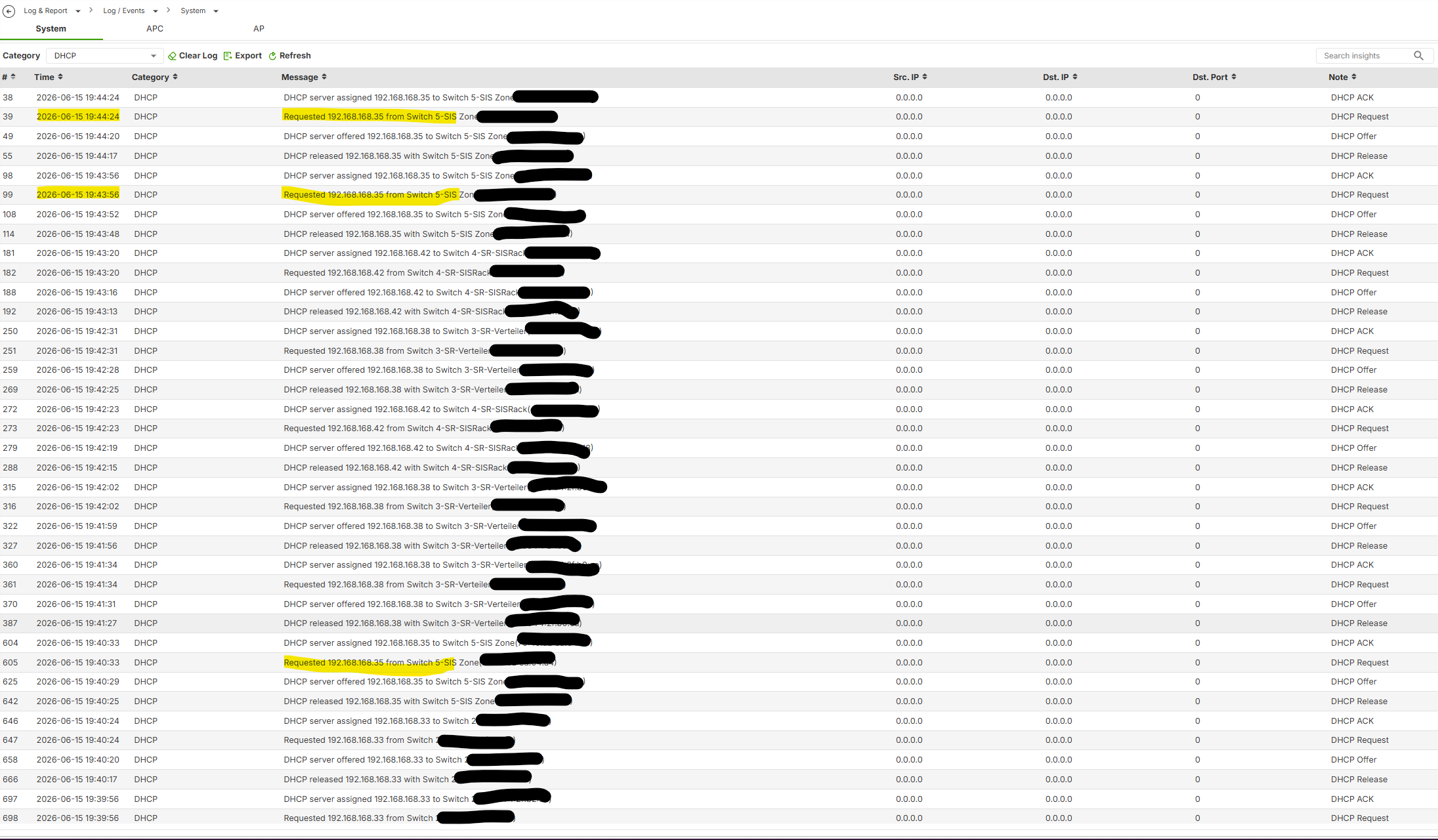

I have the problem that from some moment on the DHCP for my MGMT Interface (VLAN 168) is no longer working correctly with DHCP, or maybe the zyxel switches like XMG2230 or XMG1915 lost control of DHCP.
What i remember is that i have set TTL to 30 days and i have tried to add a Reservation for one other device.
Not sure if this is the reason the problem began.
Have someone had the same experience?
Since approx. 8 hours i have the same entries the whole day and nebula does not show any useful information about Portstatus of those switches (it also does not show the local ip, or sometimes for a short moment).
Before it worked for approx 6 days without problem.

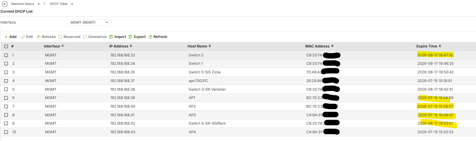

Screenshot of the DHCP Table for MGMT Network:

    Really it best not to use DHCP for switches in a 192.168.168.0/24 its best to put static IP device at the high end and then limit the DHCP IP pool to not over lap.
    What might of happened is a Rogue device has the IP

    Hallo,
    i think that this could correlate. The interesting stuff is why "nebula" seems to have an impact on the Switch requesting again and again a DHCP request.
    I can imagine that a device like a switch is "telling" Nebula which IP he got fails (because of nebula incident), but why is the switch in this scenario forced to once again requesting a new ip (i could also find a answer for that, but i think there should be something like a MessageQueue inside the device which is trying to send from time to time the queued messages like "i got a new ip via DHCP")?
    Around the time you mentioned really the DHCP stop doing this enless loop of requesting DHCP.
    Thx.
    Its always good to know that it was not the local administrators fault. I spent 2 hours searching for the problem because for around one week everything was working totally normal.
