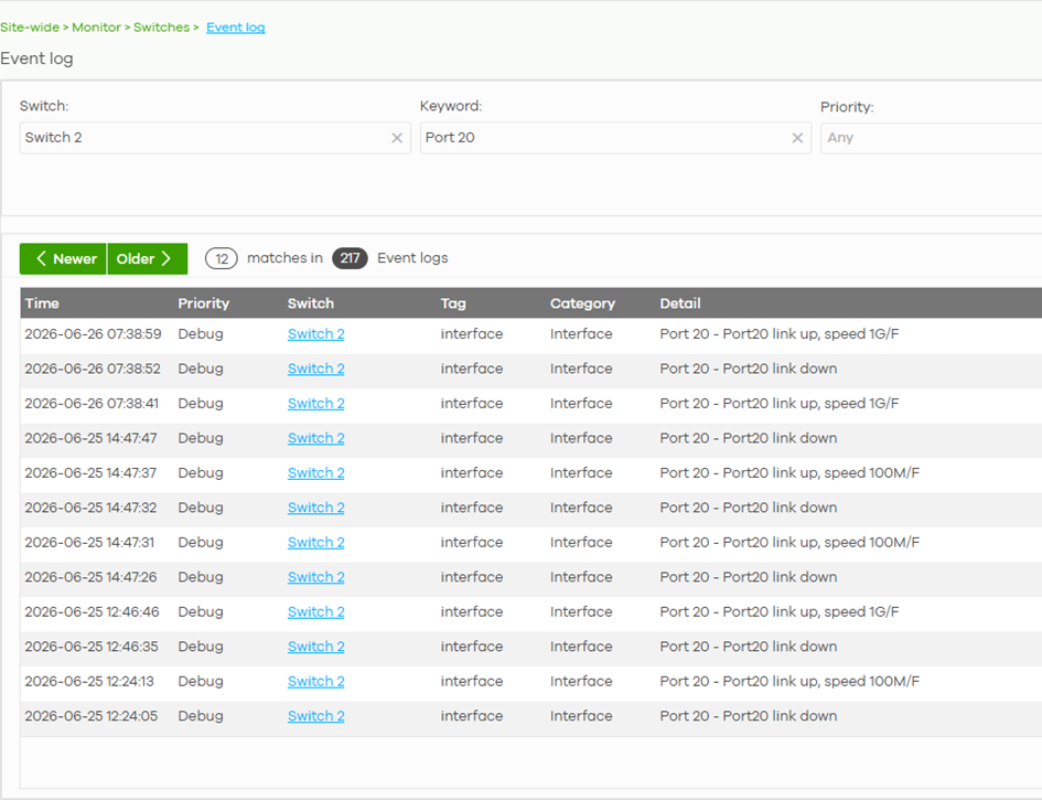

i have problems on my new network with the XMG2230 switches that some older HP Dockingstations seems to have problems with network connection.
From time to time the network port goes up and down many times.

The other reason could be a bad port on the switch or device so test port 20 to another known working device and cable
0 -
There is a time gap between each link down and link up. Perhaps, port 20 is connecting to a PC or printer and went into dormant or power saving mode with 100M link speed and then woke up with 1G link speed.
