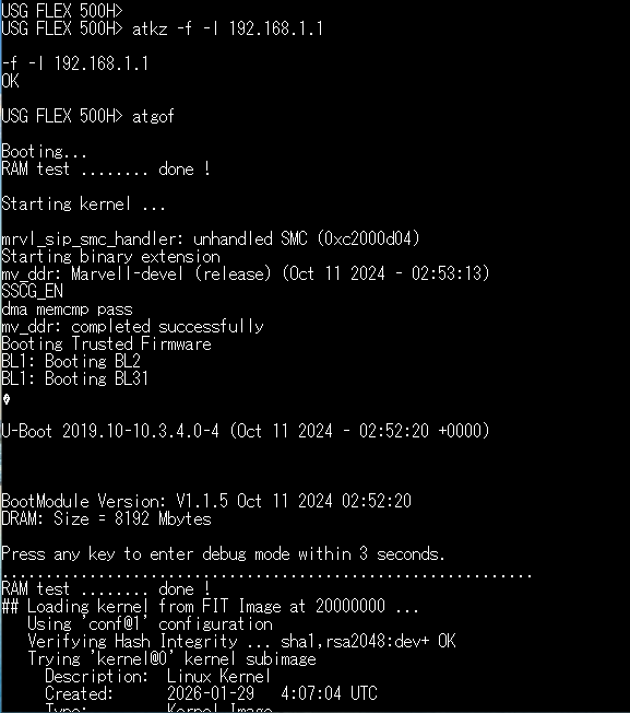

    I tested the recovery procedure as follows:
    atkz -f -l 192.168.1.1
    The command returns:
    OK
    Then I executed:
    atgof
    However, the firewall does not enter FTP recovery mode. Instead, it immediately starts booting again and falls back into the same boot loop.
    Log.PNG 27.4K

    hi @Zyxel_Judy
    I would also like to add that after running:
    atgof
    the message:
    Connect a computer to port 1 and FTP to 192.168.1.1 to upload the new file.
    never appears. The firewall immediately continues the normal boot sequence and enters the same boot loop.
    As a result, I am unable to access the firewall through port 1 (or any Ethernet port) to perform the FTP recovery procedure.

    Hi @Zyxel_Melen ,
    I followed the procedure exactly as described:
    1. Entered Debug Mode.
    2. atkz -f -l 192.168.1.1The command returned OK.
    3. Configured my PC with the static IP address 192.168.1.2/24.
    4. Connected the PC directly to port 1 of the USG FLEX 500H.
    However, I am unable to access the firewall via FTP. The message:
    never appears on the console, and I cannot establish an FTP connection to 192.168.1.1.
    Is there any additional command required to enable the FTP recovery server ?
    Thank you
