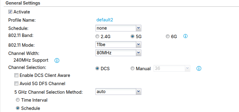

    Internet speed test (any usually give similar results, ookla, google, cloud flare, etc ) ; which is very consistent; 5Ghz, auto channel selection enabled (DCS see pic).

    Regarding the throughput drop issue, from the logs, we found that your AP's 5GHz channel bandwidth dropped from 80MHz to 20MHz, which was triggered by Wireless Health. This typically indicates that the environment isn't ideal — for example, a noisy RF environment or signal interference.
    [2026-07-28 03:08:57] wlan: [21359:I:ANY] chan: 153, tbtt: 5, ch_width: 80, band: 0, freq: 5765
    [2026-07-28 03:09:07] wlan: [21575:I:ANY] chan: 153, tbtt: 5, ch_width: 20, band: 0, freq: 5765
    As shown in the following screenshot, the AP did many attempts to recover the bandwidth. However, since there were clients connected and transmitting packets at the time, the AP held off on taking action to avoid impacting service, resulting in "no action."
    Based on this, we'd recommend switching to 40MHz first and testing to see whether the issue improves, or whether the bandwidth still drops down to 20MHz.

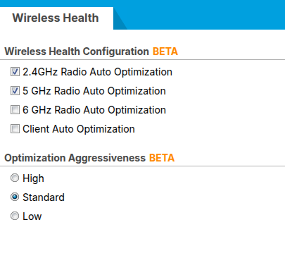

    If the issue persists, please kindly share a screenshot of the Configuration > Wireless > Wireless Health settings page. This will help us check whether any further adjustments are needed.

    Anything I can do to prevent it from dropping to 20? Seems correct currently.
    Not much here to change. Would "Client Auto Optimization" help or hurt?
