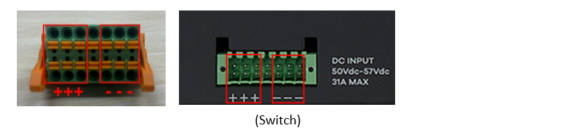

Step 3 Detail
The 14-pin DC terminal block and Switch DC connector have six positive conductors and six negative conductors.
Caution
1.Do not connect any wires to the center 2-pin of the DC terminal block.
2.For grounding purpose, connect the grounding cable to the grounding screw on the rear panel of the switch.
Step4 Detail
Before inserting the DC terminal block into the Switch DC connector, lift the levers on both sides.

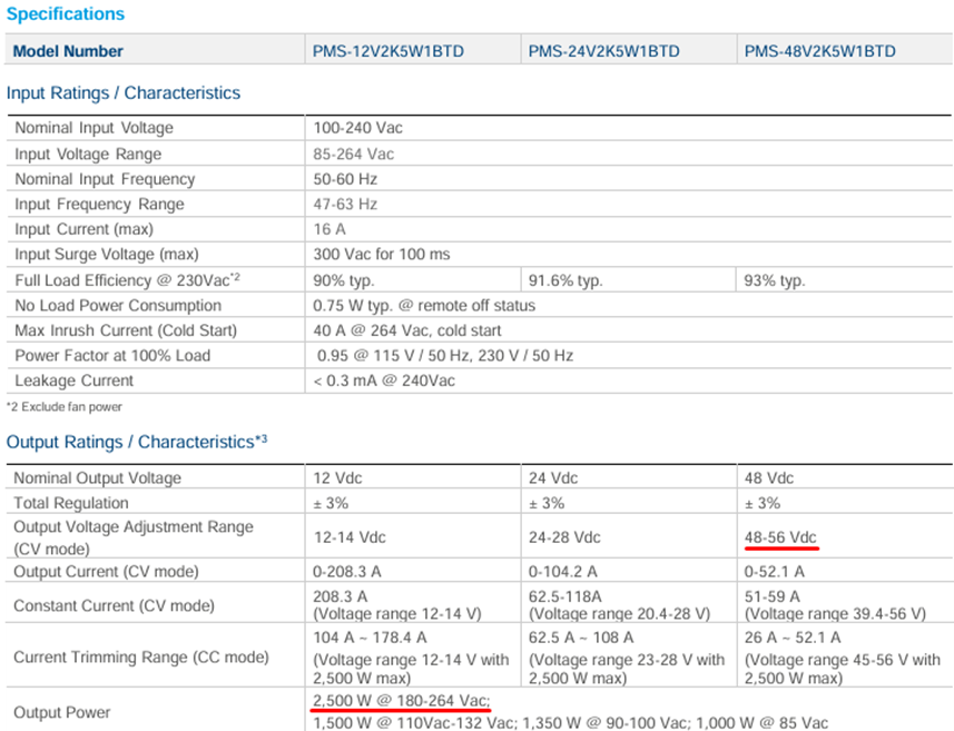

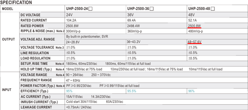

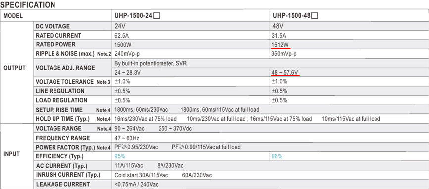

6 Recommended External DC PSU Models
Delta: PMS 2,500 W series / PMS-□V2K5W1BTD
Meanwell: UHP-1500 series
Meanwell: UHP-2500 Series
