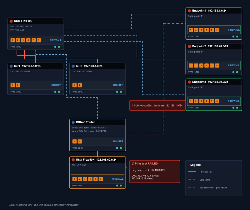

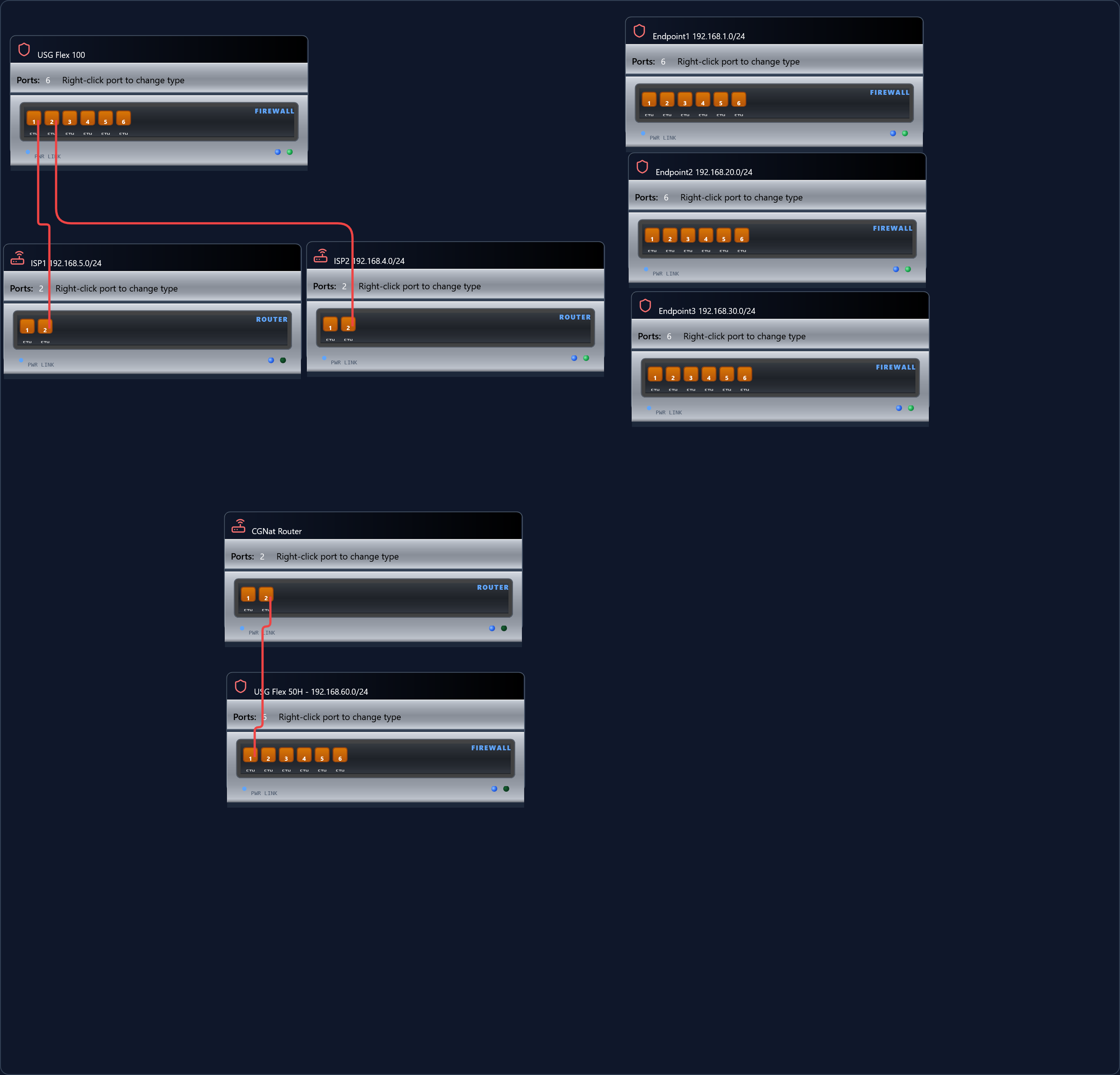

Thanks to @PeterUK and Base44 for allowing me to produce this network diagram. Take some time for have a look, then read the following experience.
USG Flex 100 have several IPSEC site-to-site VPNs working. Most of thems are ZLD 5.0 devices (USG Flex 50 and USG Flex 100) with one USG 20 ZLD 3.0 endpoint (behind a CGNAT connection, Site to Site with dynamic peer.

Some things I noticed about network diagram your using router for ISP where I have a device listing Internet Source I guess you can use it any way you want if just simple layout also the export canvas is bigger then it should be I fix that at some point.🙃also did you know you can right click on the ports to configure?

I did not reported all the endpoints having a site-to-site VPN using public static IP to USG Flex 100 on 192.168.10.0/24 , but I reported the one that's using 192.168.1.0/24 as remote network.
When USG Flex 50 H on 192.168.60.0/24 had wan configuration on 192.168.1.0/24 address, VPN could be established, but i was not able to ping gateways (192.168.60.1 on USG Flex H side, 192.168.10.1 on USG Flex 100 side) or devices on the subnet. Restoring 192.168.4.0 as wan subnet for USG Flex 50 H, VPN worked again as expected.

Hi @mMontana,
Thanks for your update!
To make sure we're aligned before going further, could you please confirm whether the attached topology matches your current setup and the issue you're experiencing?
Regarding your comment — "IMVHO what's ambiguous is the behavior of the different firmwares" — along with the screenshot showing the static IPs 192.168.1.2 and 192.168.30.1: do you mean that, on a non-H (ZLD) setup, both addresses fall within subnets already used elsewhere in the network (192.168.1.0/24 and 192.168.30.0/24), yet no IP/subnet conflict or packet loss occurred there?
