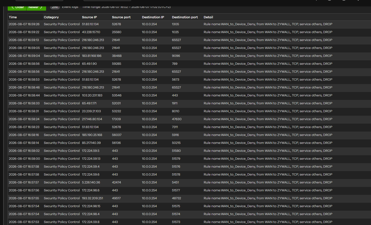

After updating to 1.39, we noticed, particularly on the 200H models but also on some 100H models, a significant increase in "log deny wan-to-device" entries. Specifically, I’ve noticed that the destination IP is my public IP, and the source always appears to be legitimate websites.
Since the destination port is always an ephemeral port, I suspect this is related to an issue with HTTPS sessions.
Has anyone else encountered this behavior?

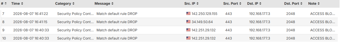

    I have narrowed the issue down to it being UDP show wrong blocked logs

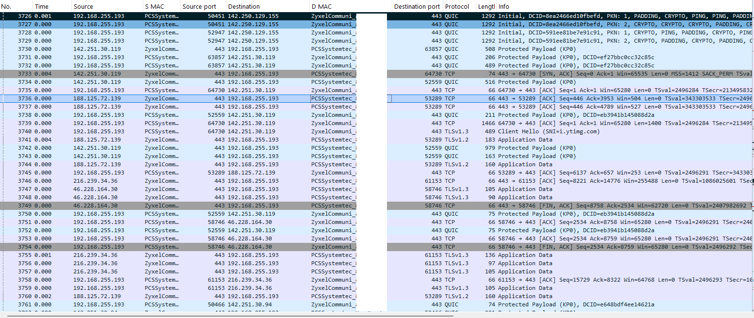

    hmm this is odd…let me think about what I'm seeing in packet capture

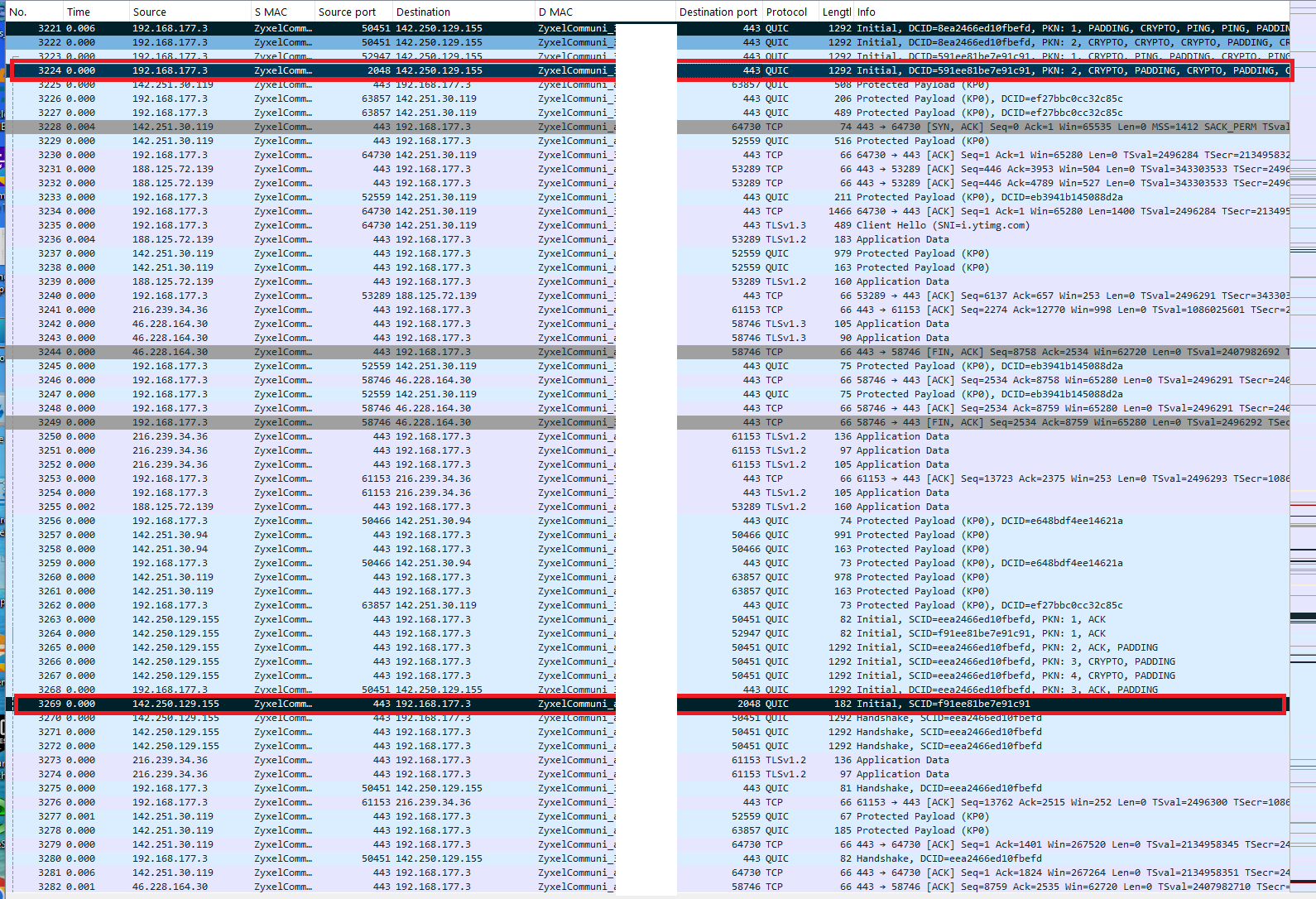

    so on my FLEX 200H I have a test WAN as 192.168.177.3 Ge3 and LAN Ge4 192.168.255.243/26
    this is what the client sends
    and this the the WAN FLEX send
    but why is this traffic being sent out in red?

    nope I think this is just UDP if you firewall on client for doing TCP only and allow DNS I don't see the issue I'm not sure if it just QUIC or might happen to other UDP traffic.

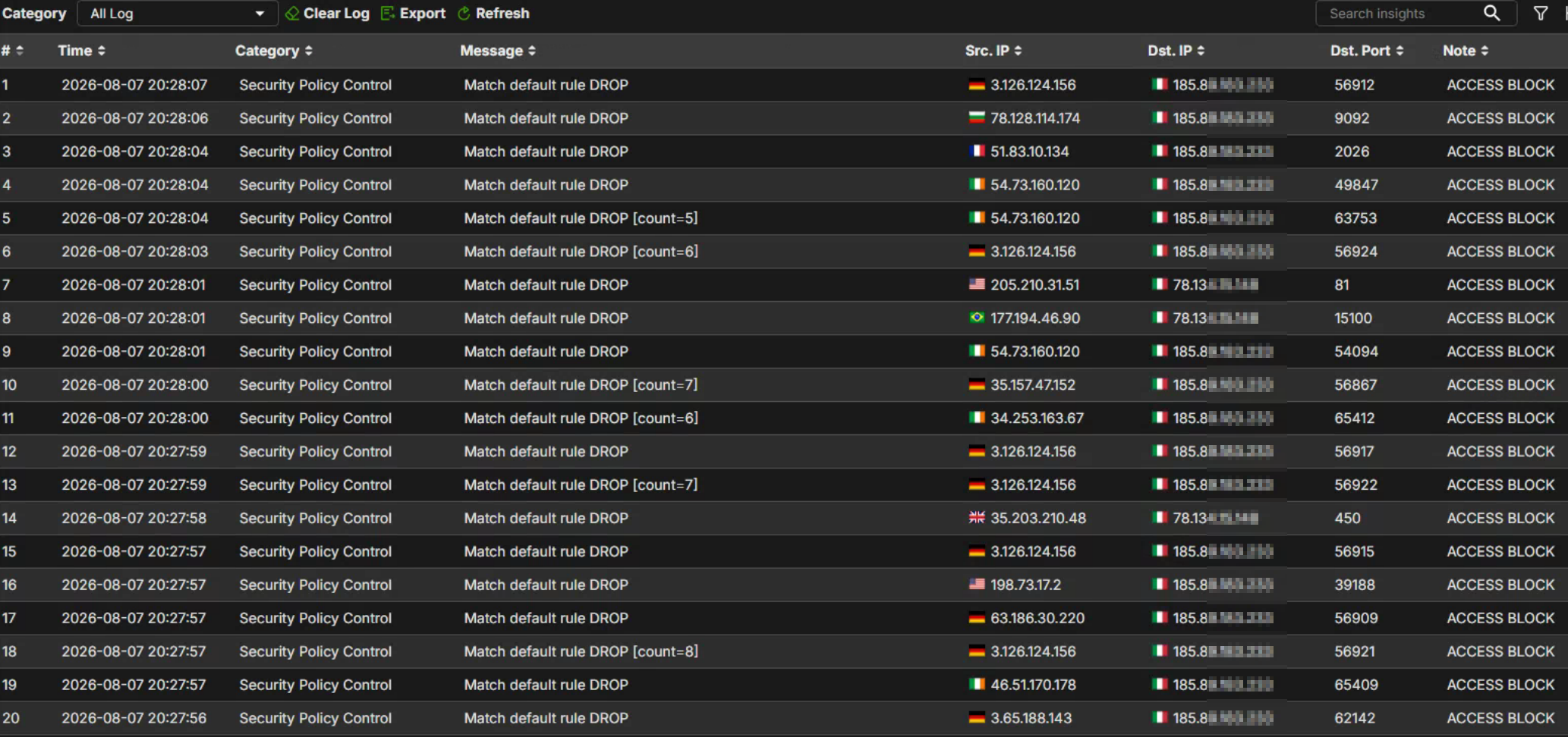

    Mmh, but in our cases it seems the TCP handshake completes successfully and the TLS Client Hello is transmitted. Subsequently, the client starts retransmitting packets while the server generates Duplicate ACKs and repeated FIN/ACK retransmissions. This suggests that packets belonging to an already established session are being lost or not correctly associated with the existing state entry after NAT translation. In that cases we can see in the packet capture a lot of TCP retrasmission and in the firewall logs like this (dest ip is WAN1 and WAN2)

    Think your seeing something different Mk88_it to Dylan96
    Your looks like background Radiation due to WAN IP being on the front line
    Unless the TCP happens because of that? just checked TCP seems fine
