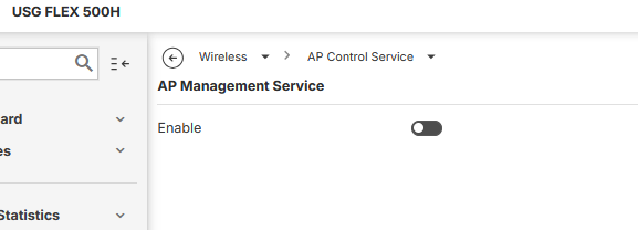

I went here to disable the AP management:
then I linked the AP is inside the primary network again and it was happily blinking green and yellow.

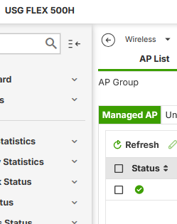

As soon as I tried to switch AP Management on, then the AP locked in solid red.
As you can see the green Status let you think everything is good but the AP is still red.

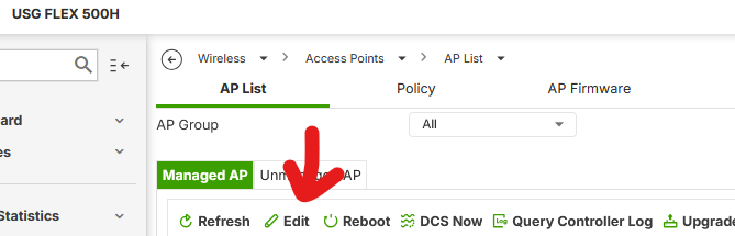

As soon as you select that AP and click Edit:
The page of the 500H turns blank and if you refresh it asks you again login credentials.

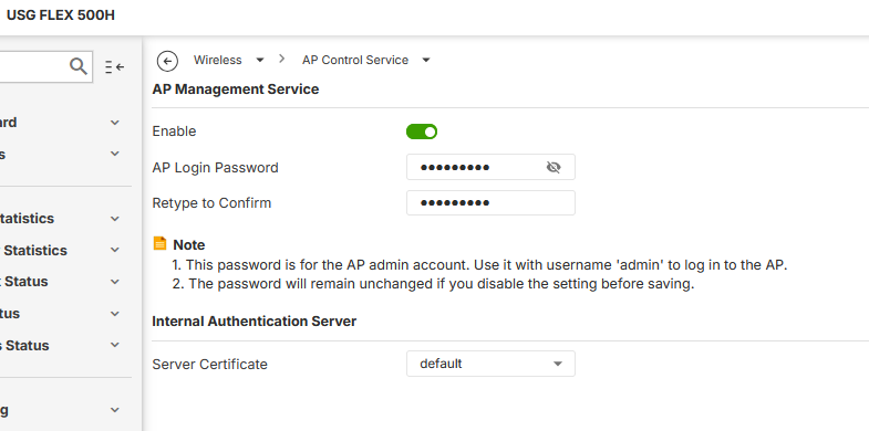

    EDIT: this issue occurs when I adopted it in "default" group. Now I created a "NewGroup" and 500H adopts it. There is another issue, the default password to enter adpted APs is set here:
    Now, when I open the webpage of the new adpted AP under "NewGroup" I can access it with admin/1234 instead of the custom password I put inside AP Control Service.

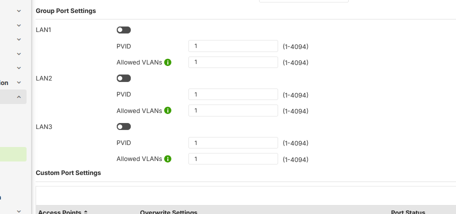

    I think there is an issue with LAN disabling in AP Settings:
    If you create a new group for "AP Group" and there you select disabling these:
    Then you reboot the 500H, you can see the AP going offline.
    Maybe a conflict between LAN1 disabling and uplink disabling too.
