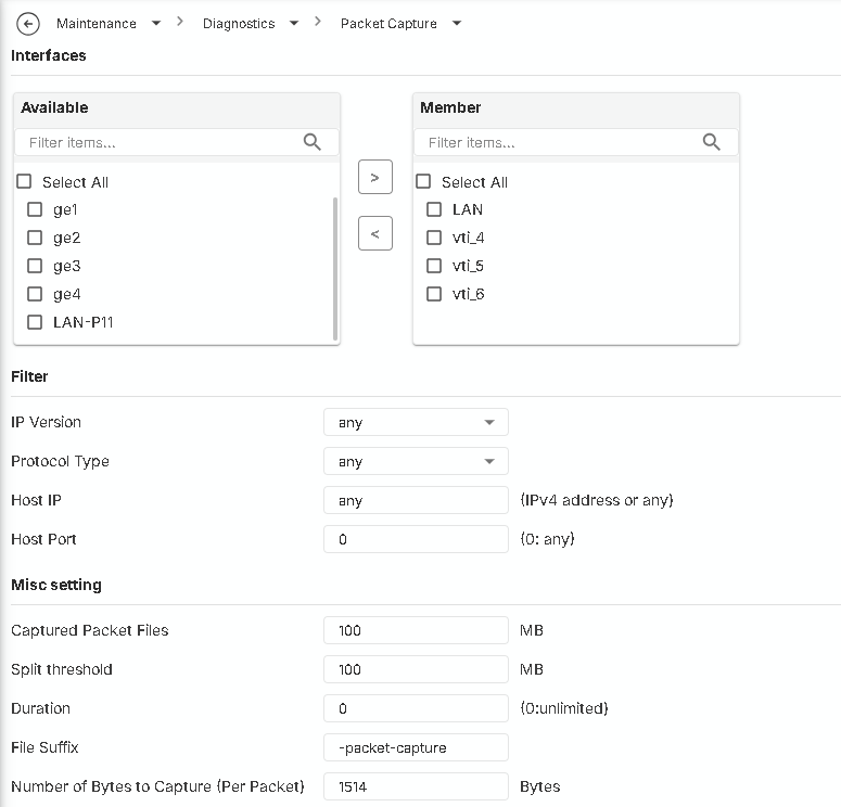

    Please help with us:
    1. Provide the packet file of the UDP traffic like "192.168.175.5:1000 <-> 192.168.90.21:1000". With the packet file, we can try to replicate this issue in our lab.
    2. Enable Zyxel support access and share the organization's name so we can access to check your firewall configuration and other details.
    Enable Zyxel support access can reference this FAQ:

    Hi @carb8111
    Please capture the packet from the working old VPN100/ZLD setup, where the expected RCO/UC communication works. I will try to send in USG FLEX H lab to check if the remote site can receive it first.
    Also, please enable Zyxel support access and share the organization's name so we can access to check your firewall configuration and other details.

    Yes, please put the RCO/R-CARD system behind the FLEX 500H again, and run the real RCO/R-CARD test.
    May you share the time with time zone you are able to run this test? If it match our engineer's working hour, I would like to ask our engineer to check when you run the test.
    If not, we will need you help to capture the packet.
    Please help to select the interface LAN and vti interface. I assume your VPN tunnels are both route based VPN tunnel, so we can capture packet on the vti interface to clarify this issue.
    Please help to share your available time with me, thanks!
