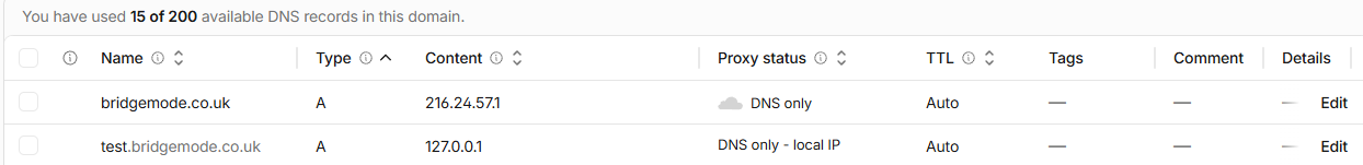

So here is the thing I make a subdomain test.bridgemode.co.uk with IP 127.0.0.1 knowing that this should be updated by this API token which I have setup and put into the FLEX H that shows Success and API token shows Last used by some seconds ago but the IP never updates.

    have you test this type of DDNS to be working correctly your end?

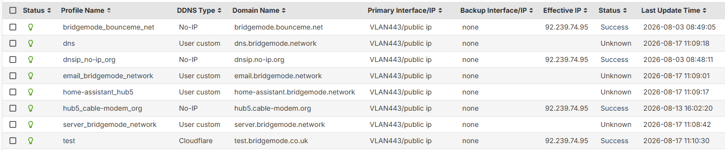

    The effective IP shown here its meant to change but does not at Cloudflare end
    Just so you know I test DDNS no-ip on the same interface VLAN443 and that updates fine
    it took me hours to find but I know it works if i do

    As the profile is currently in a disabled state. Could we kindly ask if you would allow us to enable it to test and check the logs?
    Zyxel Tina
  • PeterUK
    PeterUK Posts: 4,818
    image  Guru Member
    edited August 17
    Yes sorry I disabled it in case it causes too many fail attempts I have enabled it if needed I can make a new API token and give it to you for testing feel free to disable and enable this test subdomain.

    Now on V1.39(ABZI.0)ITS-26WK32-m12287
    Still seeing the same issue was wondering if you had checked over my setting for DDNS if I done something wrong for Cloudflare DDNS not working?
