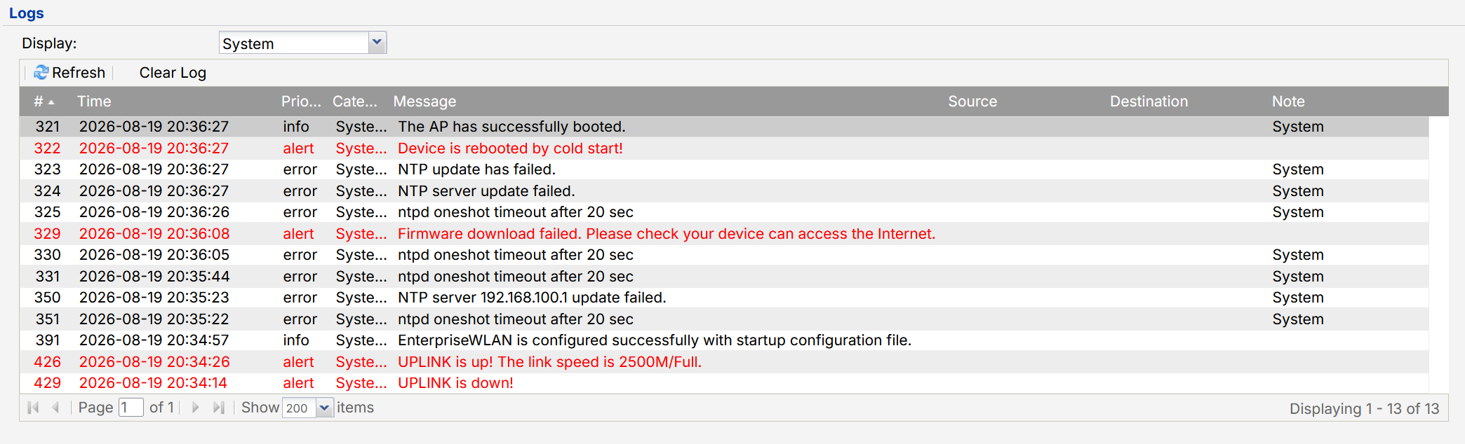

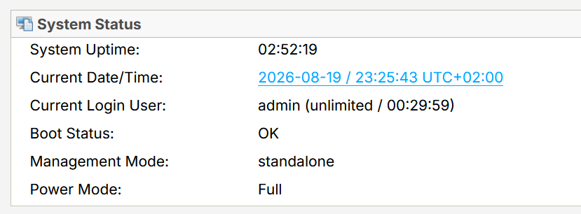

As per image, the current datetime is 20/08 @ 11:23AM instead the AP have 19/08 @ 23:23.
The uptime is more or less 3hrs
This is the System log after power up the AP:
My network goes down in the night, and wake up on morning.
The problem is that the AP finishes booting before 192.168.100.1 is available, so NTP effectively fails to sync. The problem is that there don't seem to be any retries for the next 3 hours.

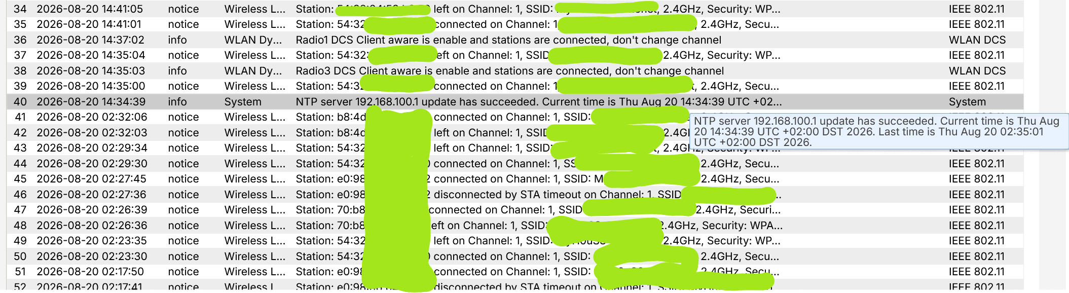

    This is when the AP start syncronization:
    As you can see the system as "started" at 19/08 20:36 (8:36PM) and the sync was successfully completed at 20/08 02:35AM, so 6 hours after the system start-up.
    So, if the NTP don't sync at first time, the system wait 6 hours to retry to sync.
    I've collected the logs, as before if you would the log, ask me :)

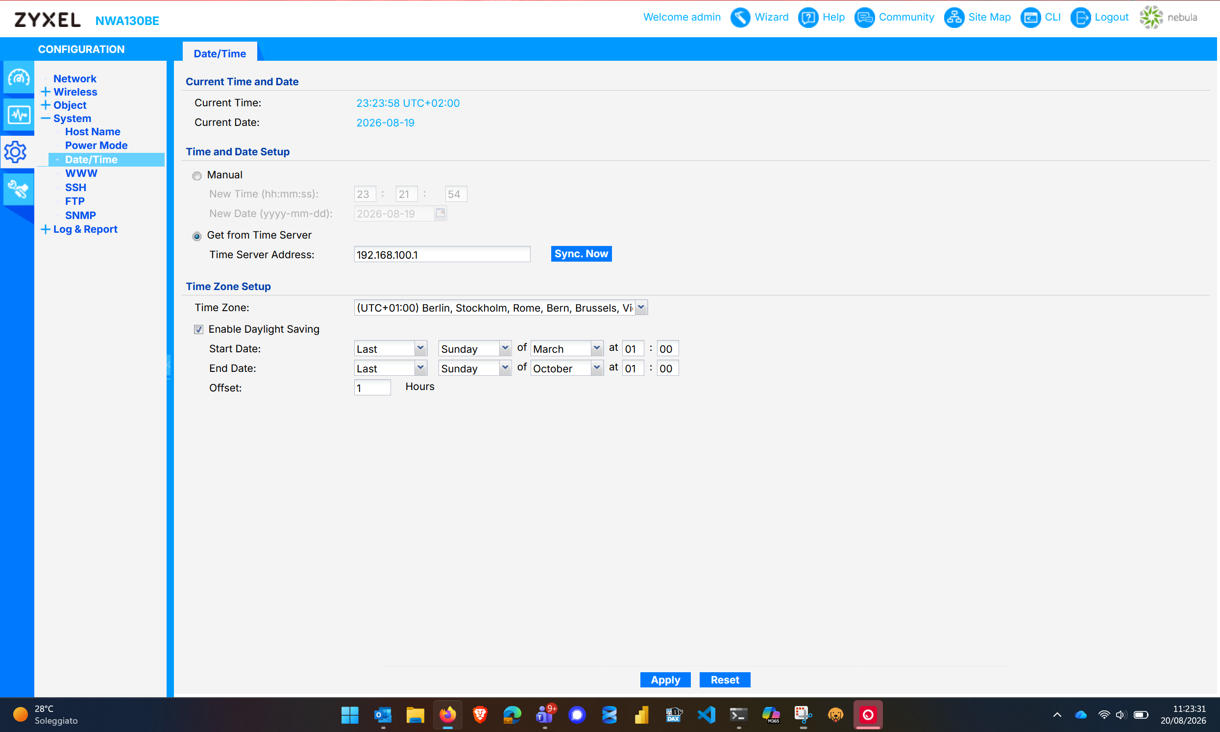

    In the meantime, if you'd prefer not to rely on a public NTP server, a workaround is to wait until the firewall has fully booted up, then go to the AP's GUI's CONFIGURATION > System > Date/Time and click the "Sync Now" button to manually trigger the time sync.
