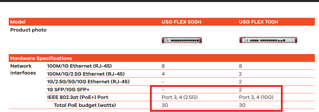

Hello,
As per datasheet, all the USG Flex H PoE models have max 30W as PoE budget.
I think is clear, but just to confirm, the max wattage (30W) is shared between ports (so between port P3 and P4, the PoE budget must be less than 30W) or is per port (so max 30W on port P2 and max 30W on port P3)?
Thank you

    Hi @Maverick87 ,
    Yes, that is correct. The maximum wattage (30W) stated in the datasheet is shared between the two ports (meaning the device will not deliver more than 30W of total power).
    Thank you for choosing Zyxel products and services. Please feel free to let us know if you have any further questions. Have a wonderful day!
