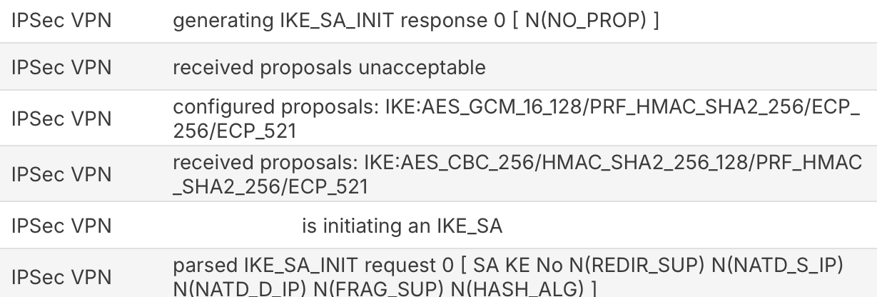

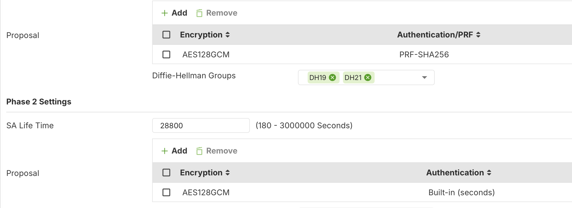

    Back to this topic, after a business trip.
    • VPN Config1 picture shows the VPN config
    • Log file1 shows the log file
    I deleted the VPN profile from iPhone and pushed the Download- button to have the config script. And installed that to my iPhone
    It looks like iPhone is not getting the right script or is overriding that with default AES256 settings.
    K
