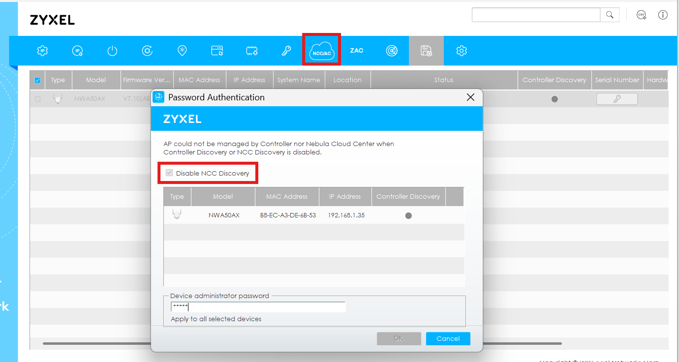

I have also tested the ZON utility to disable Disable Nebula Discovery, but that fails due wrong Device Administrator Password. So where is this password? Is it the same password as logging in to Nebula? Or the WiFi password?

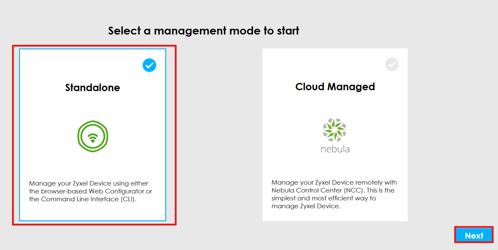

Please try logging in to the local Web GUI at https://{IP address} using the following credentials:
Username: admin
Password: 1234 or the default password printed on the device label
After logging in, select "Standalone" mode, then change the password and SSID settings.
In addition to continuously searching for the Nebula cloud due to standalone mode not being selected, the LED indicator will still blink green if the default password (1234) remains unchanged or the SSID is still set to factory defaults. Therefore, please ensure that both the administrator password and SSID have been updated.
If the LED is still slowly blinking green after completing the settings and waiting for 5 minutes, please go to ZON, click on [NCC/AC], and verify whether [Disable NCC Discovery] is checked.
Device dministrator password: Same as the Web GUI password above.
