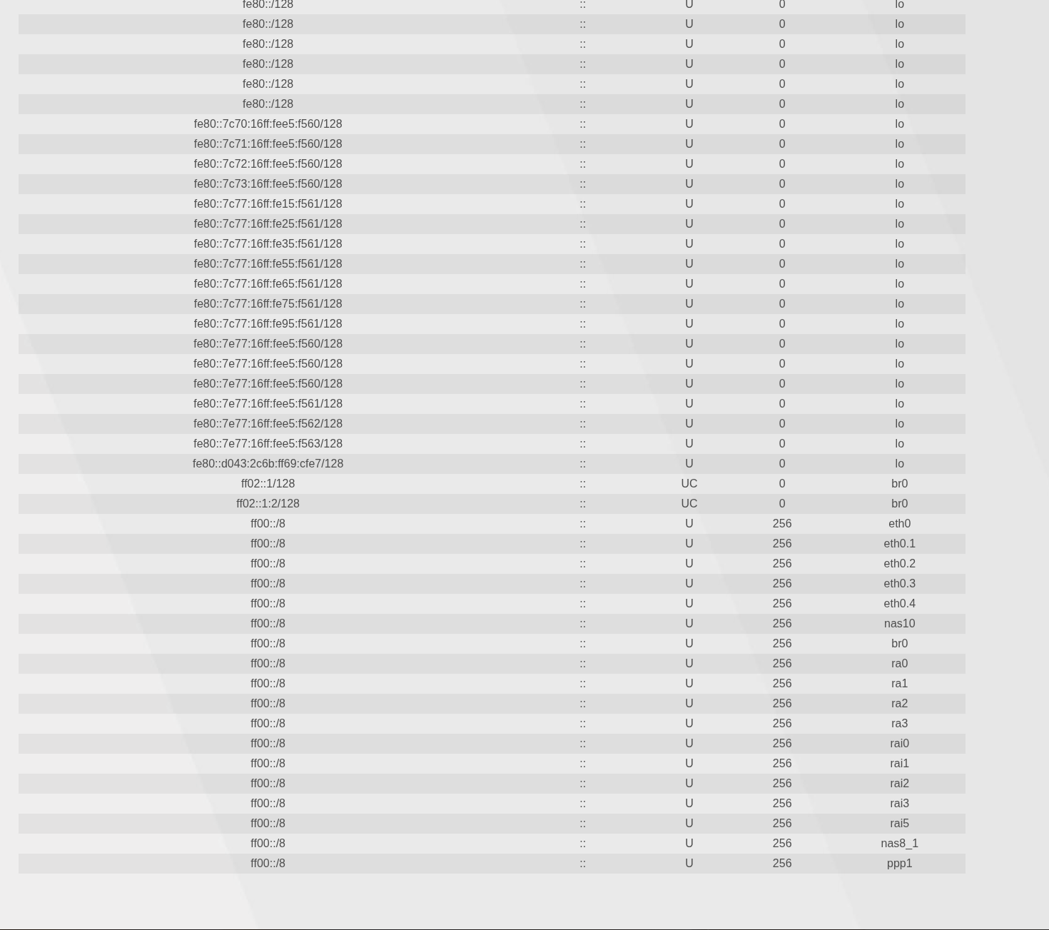

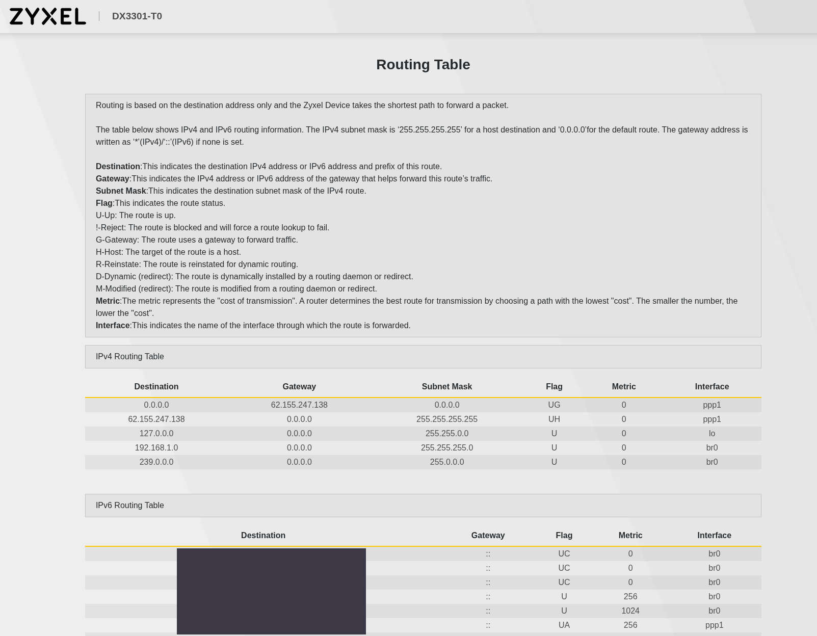

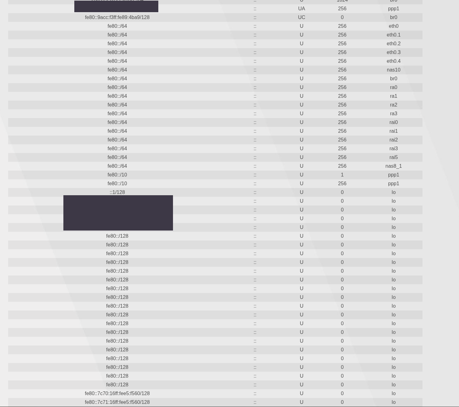

- However, the router's IPv6 routing table contains no default route (
::/0). - External IPv6 connections fail, and the router returns "Destination unreachable: No route".
- A router reboot and a Telekom line reset did not resolve the issue.
- The router's own Ping 6 and Trace Route 6 diagnostics also fail to produce successful external IPv6 results. Trace Route 6 returns "can't connect to remote host" for multiple destinations.
This suggests that the router is failing to establish or install the IPv6 default route over the PPPoE connection.
I've attached three screenshots showing the complete routing table. The IPv4 default route (0.0.0.0) is present through ppp1, whereas the IPv6 default route (::/0) is missing.
