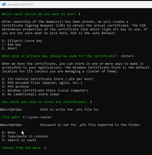

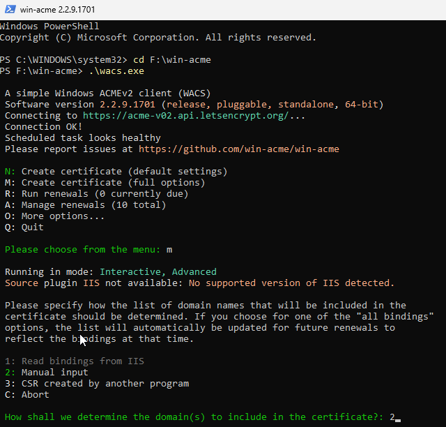

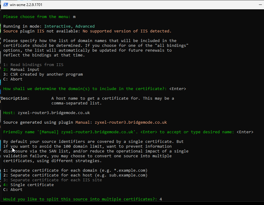

So run WinACME pick M

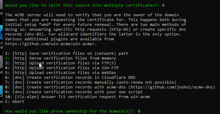

put in a domain single Certificate
pick verification in my case 6 if you have cloudflare
pick to save as pfx where to save it

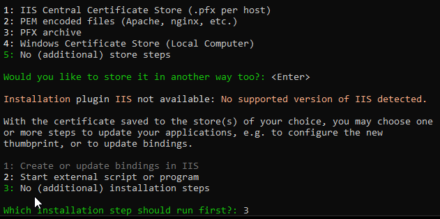

no more step and it will challenge you have that domain
