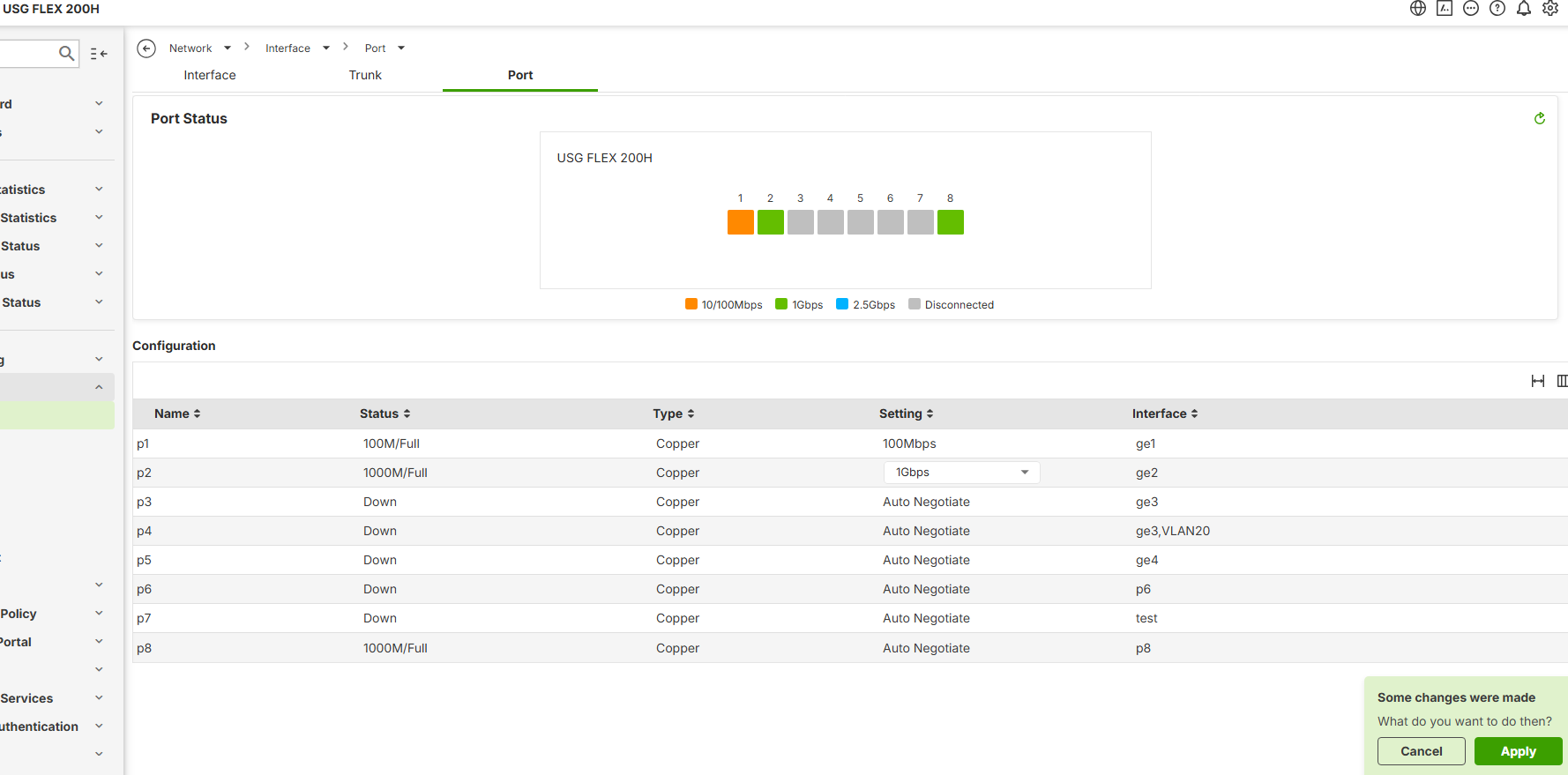

    2. Manually set the WAN port speed
    In some cases, auto-negotiation difficulties may occur between the modem and the firewall. On USG FLEX 200H, navigate to Network > Interface > Port and change the port speed to a fixed 1 Gbps instead of leaving it set to Auto Negotiate.
