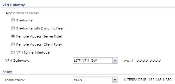

Hi everyone,
I'm trying to set up an L2TP/IPSEC VPN on a USG40, the basic network config is as follow :
  • WAN connected to a VSDL router, fixed IP 192.168.1.250
  • UDP ports 500, 1701 and 4500 redirected to 192.168.1.250
  • All LAN ports in LAN1 zone subnet 10.0.0.0/24
  • ZyWall IP 10.0.0.1

The VPN connection config is attached as images (screen caps).
It has been set up following another post found on this forum but it does not work.
I tried connecting using Android 10 client and Windows 10 integrated client.
Can you help me ?
Thanks a lot,
Sebastien

Accepted Solution
  • jasailafan
    jasailafan Posts: 193
    5 Answers First Comment Friend Collector Sixth Anniversary
    image  Master Member
    The USG40 is placed behind NAT.
    You should follow the guide to configure the wan IP of VSDL router as "Local Policy".

    Thanks for your reply.
    Yes it is behind a NAT and your article is interesting.
    If I read it correctly the local policy for phase 2 should be the WAN public IP, not the USG40 WAN IP.
    This is a problem for my scenario because the public IP is dynamic. To bypass this, I create a FQDN object pointing to my VSDL router but I can't select that type of object for phase 2 local policy (not shown in the list).
    Is there a way to do the same thing with a dynamic publicv address you think ?

  • Sébastien
    Sébastien Posts: 41
    First Comment Friend Collector Fourth Anniversary
    image  Freshman Member
    Yes it is ! I found the solution : I set up the local policy to an IP object, type HOST, value 0.0.0.0.
    My L2TP is now working for local network, but no access to Internet when VPN conencted despite the security rules allow traffic between the IP Sec zone and any other zones.
    So a ping to 10.0.0.0/24 subnet is OK but not to 8.8.8.8.
    Please note that I had to configure the IP pool to the subnet 10.0.2.0/24 but as ping works to 10.0.0.1 I suppose it is not a routing issue.
    Nothing in the logs saying that ping from 10.0.2.1 to 8.8.8.8 packets are blocked.
    Thanks for your help.
