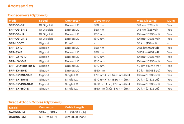

Additionally, the supported transceiver/DAC modules are in the below list.
Zyxel Melen0
