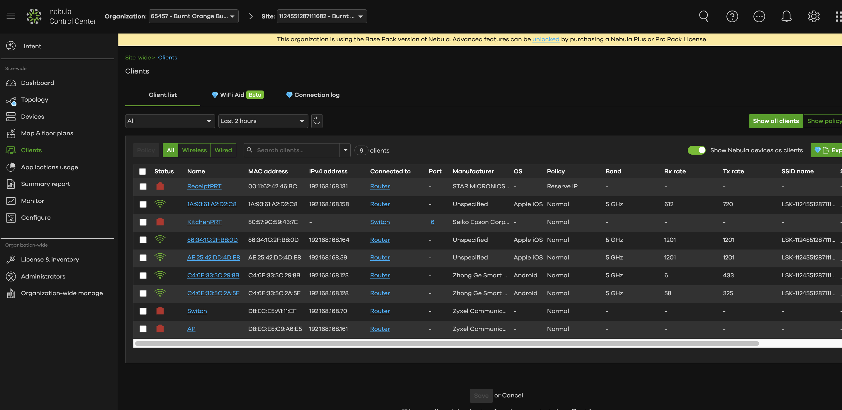

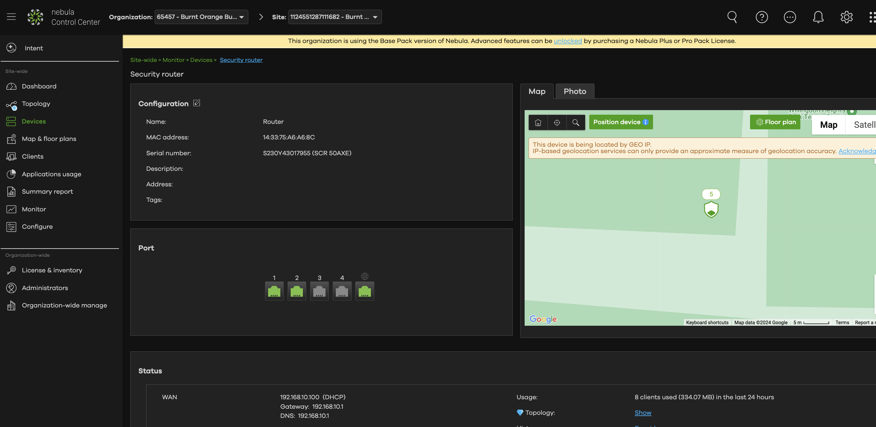

Hello ZyXEL team,
We would like to inquire about a behavior that we are noticing on a site that we are managing that is connected to our ZyXEL SCR-50AXE. Every day, we are getting disconnected from the WIRED devices connected to the router. However, as you can see in the image, the router is detecting those devices but in reality, we can't ping or communicate with them. The workaround that we do is to reboot the router which reconnects all the devices to NCC.
Connection plan:
Router:
a. LAN 1: going to ZyXEL switch where we have a printer on LAN 6 and AP on LAN 8
b. LAN 2: going to a network printer
As you see in the sample image of the router, LAN1 (Switch) and LAN2 (printer) are occupied.
We also noticed that a somehow trend that it happens during dead times or no activity. I wonder if anyone has seen this before?
  • For example on the 10th of September, the SWITCH was online from 10:06 (after reboot of the router) to 5:45 PM then went off after that. But the ROUTER keeps detecting the LAN that the SWITCH is still detected.
  • On the 11th of September, the SWITCH went offline around 4:40 PM local but the ROUTER kept detecting LAN 1
Screenshot 2024-09-12 at 5.04.31 PM.png Screenshot 2024-09-12 at 5.06.13 PM.png Screenshot 2024-09-12 at 5.06.41 PM.png

  • LSK_Support
    LSK_Support Posts: 9 image  Freshman Member
    Hello @Zyxel_Nami,
    Thank you for looking into this. Access is granted and you may refer to the following:
    • Org: 65457 - Burnt Orange Burnaby
    • Site: 1124551287111682 - Burnt Orange Burnaby
  • LSK_Support
    Adding timestamp on this inquiry. Before the reboot of the router at 8:23, switch (LAN1) and printer(LAN2) is down, but, both LAN ports on the router is detected.
    After the reboot, wired connection got reinstated and can be pinged.
  • LSK_Support
    Hello Nami,
    Another sample would be today wherein the switch when down offline but the router is detecting it on LAN1. That also includes a printer on LAN 2 that it went down as well.
    Switch Status:
    Router:
