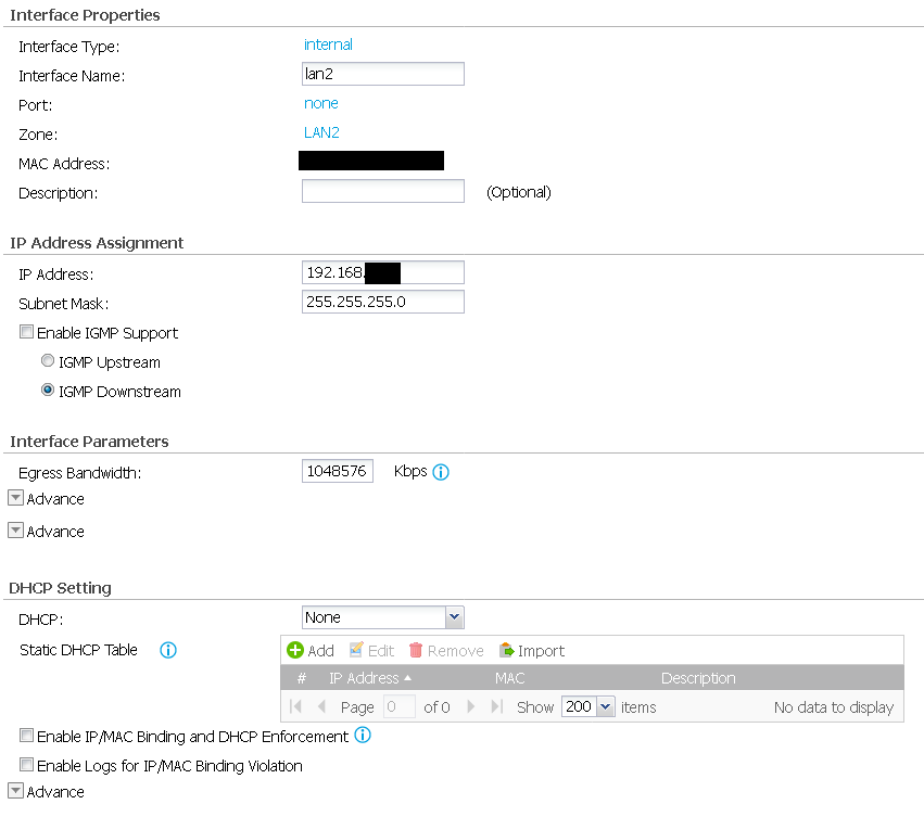

    Hi
    Sorry for the late replay I try to ex plane it again.
    Here is how the SFP Port config: It is "just" the DHCP Server actived.
    Here on Picture 2 is the Lan2 who I can config to be on the Physical Lan Ports.
    Do I need to set "DHCP Relay" that for example when I put LAN 2 on Port 7 that a Pc who is pluged into Port 7 get a IP Adress from the "SFP" DHCP Server Pool?
    Thanks

    The SFP can not port role with LAN2
    LAN2 can only port role with other ethernets
    To expand the SFP network you will need a switch to it

    Hi @Username_is_reserved,
    Does "DHCP Relay" not work in that case?
    Yes, USG FLEX doesn't support receiving DHCP relay packets, therefore, you will need a switch for your scenario. SFP port and other ethernet ports can't combine together or the LAN interface set DHCP relay to SFP port as DHCP server. One is because it does not support receiving DHCP relay packets, another is because the IP subnet overlaps on different interfaces.
    Create an internal type bridge interface and add both lan2 & sfp interface as member.
    This can group ports of two interfaces like a virtual software switch.
    The only drawback is the traffic between ports is not wire speed as a hardware switch.
