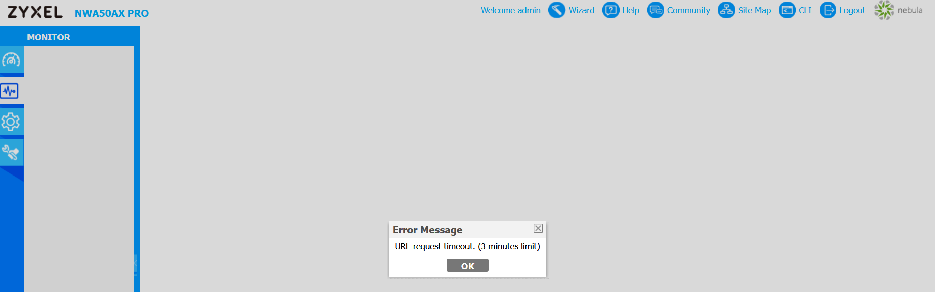

During my tests, I observed that after certain configuration changes, it is no longer possible to log in. The access point loses its connection, and the issue can only be resolved by performing a factory reset on the device. This behavior does not appear to be normal and should be investigated further.

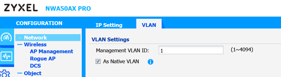

A specific example: The issue occurred immediately after deactivating the VLAN function under the "VLAN Settings".
The access point is connected via the Zyxel switch

With VLAN 1 as native checked this means the AP is on a untagged network I have (on my NWA50AX PRO) changed this so my AP is on VLAN 4091 and native unchecked this means the AP must be on a the VLAN 4091 tag network.

Hi @Montland,
"As Native VLAN" is checked, that means the packet will be untagged.
Please reference these FAQs for more details:
Understanding VLAN Settings on Zyxel AP — Zyxel Community
What is the option "As Native VLAN" on the AP's VLAN setting? — Zyxel Community
