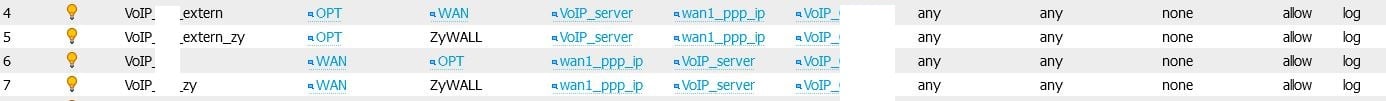

Hi
I set a rule in my ATP200 to allow VoIP Traffic from WAN to the IP Pbx.
When I look into the Logfile I see → Wan IP Phone to WAN IP Router : 5060 ACCESS BLOCK.
I dont know why? I the rule say I allow the traffic?!
Thanks

    Hi @Username_is_reserved
    What rule did you set? If the message said "match default rule, drop", this means you don't have any rule to allow this traffic.
    Back to your scenario. Due to the VoIP application, we recommend enabling SIP ALG function.
    Please reference our Handbook P.811, topic How to Manage Voice Traffic.

    It seem to work now partly. The only "problem" is I can not select as "Source" the Fix Wan IP.
    When it come from the other IP the should ignore the Data.
    Now I limit the Source only to my Country who is good for now.
    It seem the NAT was a GOOD IDEA and was not mention in the Zyxel PDF. 🤦
