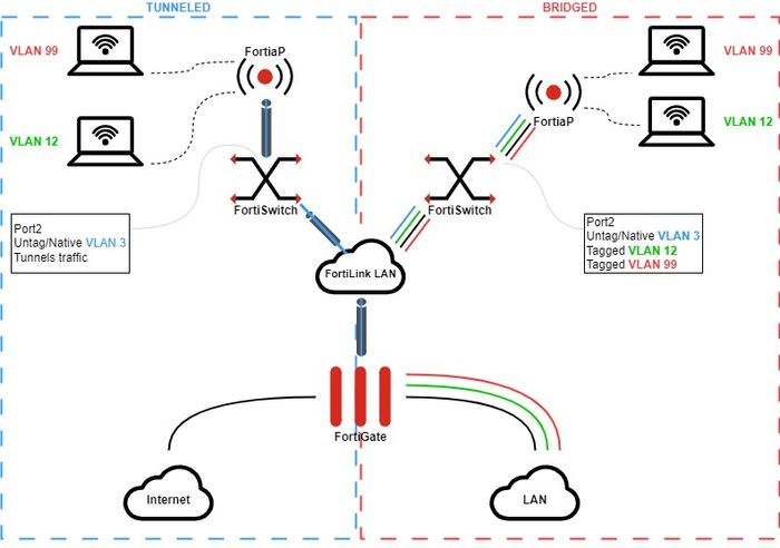

    3. I suspect the reason is due to SSID configuration on the Fortinet AP. Fortinet AP allows SSID to be configured in either Tunnel or Bridge Mode (see attached picture). As of now, I have all my SSIDs configured in Tunneled mode and all works fine as long as I do not pass the VLAN ID for each.

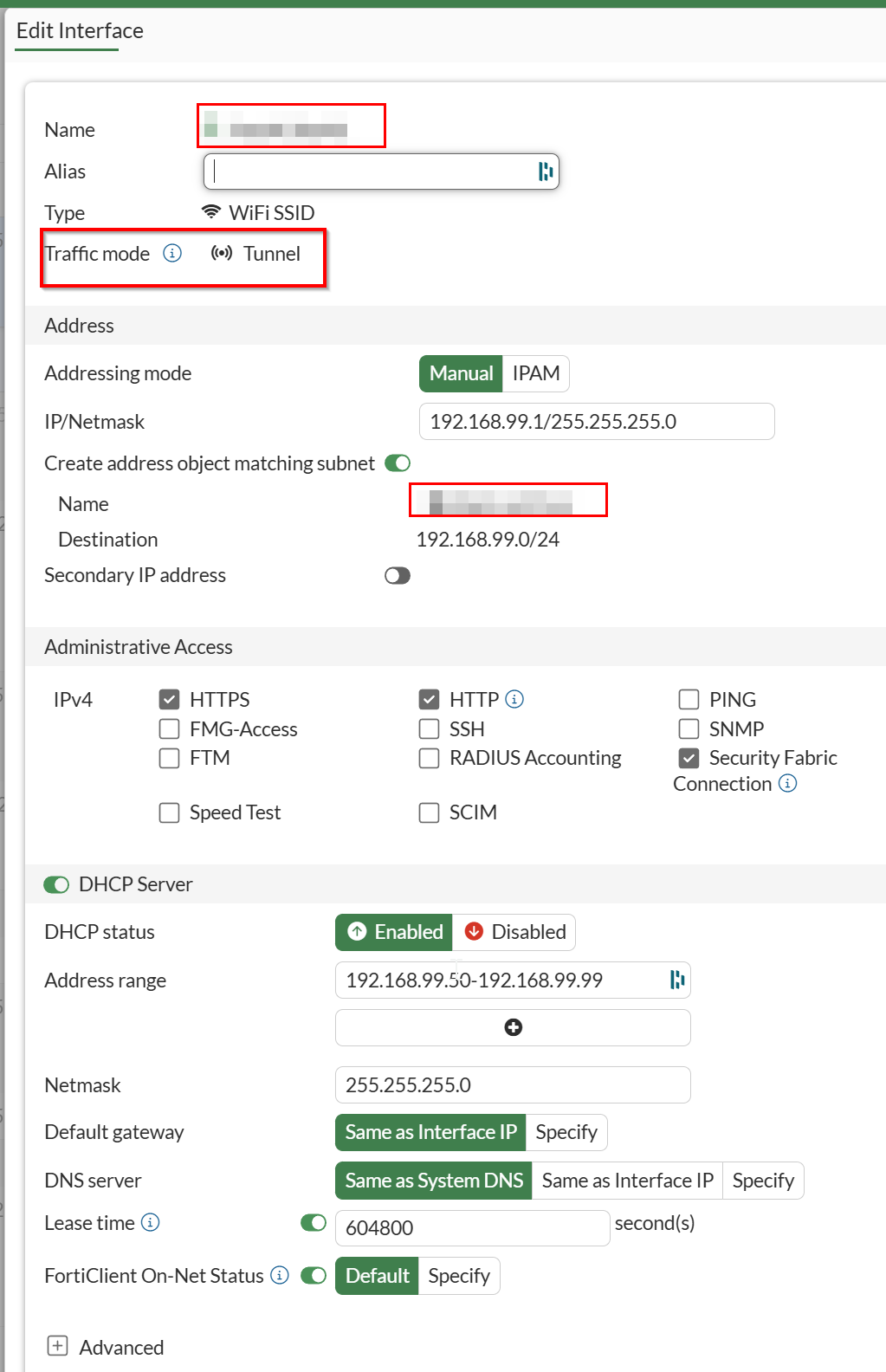

    I have attached snippets of the router interface settings. On the second picture, I show the configuration where I set the VLAN 99.

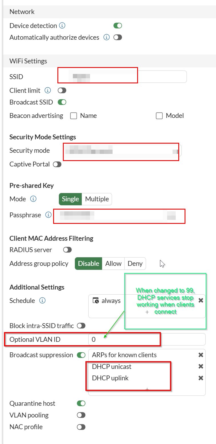

    I also noticed a Broadcast Suppression box where currently enabled suppression of DHCP uplink. I wonder if this has to do with it (this was default setting).

    So after my last post, I did a few more tests.
    1. I disabled Broadcast Suppression with VLAN ID 99 set on the interface. End device does not receive DHCP.
    2) I disabled Broadcast Suppression with VLAN ID 99 set on the interface. I set a static IP on the device. Connectivity works.
    3) I re-enabled Broadcast Suppression with VLAN ID 99 set on the interface. I set a static IP on the device. Connectivity works.
    This would rule out the broadcast suppression.

    Never seem a Fortigate UI seem odd how they lay it out I don't seem to see the VLAN option for the given interface as a VLAN maybe show how you add a VLAN interface and options?

    All, thank you for your input on my issue. The issue was with the FortiAP configuration.
    I reconfigured the WiFi Traffic as a bridge and the VLANs appear to be working properly. I'll let it run for a few days and retry the Firewalla.
