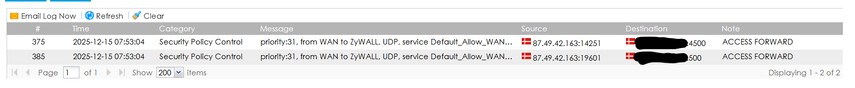

    2. Please see below screenshot from the VPN100 log
