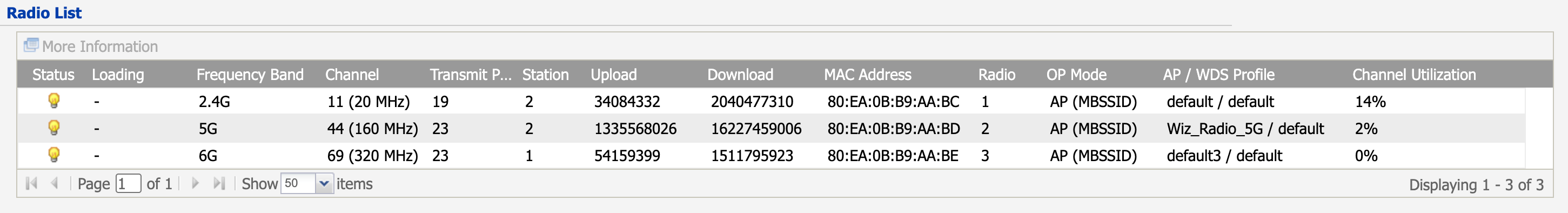

    Thanks for your response. Imho the channel utilization seems to be good:
    What else do you mean with DCS?

    Thanks for the info and the diagnostic file. Channel utilization is good, so these bands are not experiencing signal interference; we will need to check the other parts.
