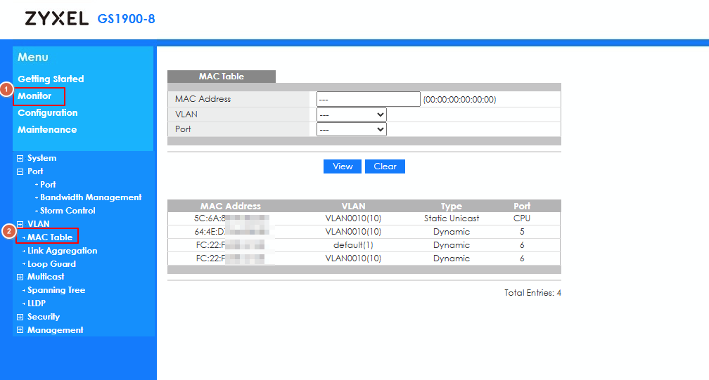

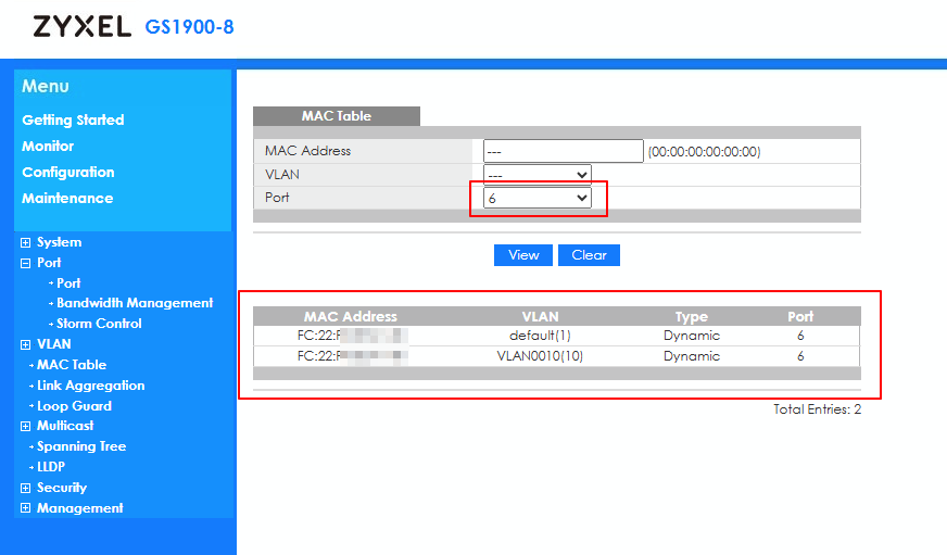

    Hi @IronKalli
    I check my GS1900 with latest firmware version, and I can check the MAC table by all and specific port. Path: Menu > Monitor > Mac table.
    Could you share how did you filter? If possible, please record a video. Also, what's your device's firmware version?

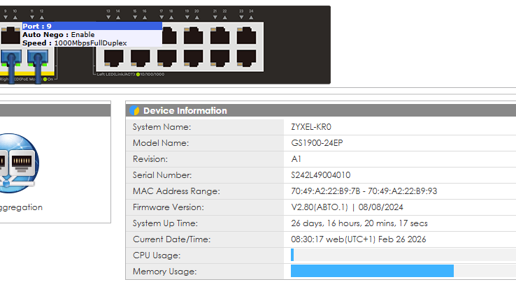

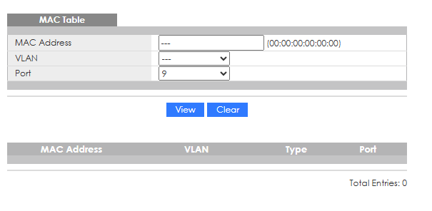

    But with some (a bit special) devices the MAC is not shown, even though the port is up
    Here is the firmware and port 9 shown
    But the MAC filter definitely does not show any entry
    I don't know what's happening here, but it is a phenomen which only shows with my special devices
    Do you think there is a firmware update I should try?
    Thanks and regards
    Kalli
