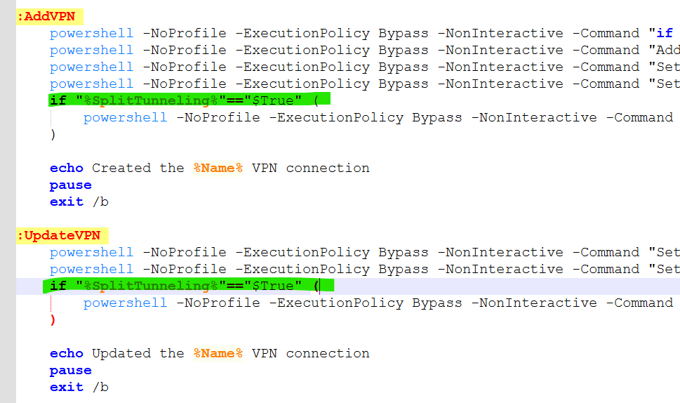

After updating to v1.38, the IPsec VPN auto‑configuration script does not correctly set split tunneling.
Based on a quick review of the script, the "true" variable does not appear to be set correctly in this section:

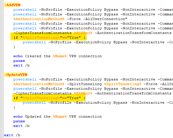

    Hi @Dylan96 ,
    The attached result was obtained by downloading the VPN Configuration Script from a USG FLEX 200H running firmware version 1.38, and the script displays the correct information.
    Could you please confirm whether your device has been successfully updated to version 1.38? The issue you reported appears to be related to version 1.37P1.
    Additionally, you may try using a different browser to log in to the firewall and download the script.
    If the issue persists on version 1.38 and across multiple browsers, please provide your Nebula organization and site details, and enable Zyxel Support access so we can investigate further.

    @Zyxel_Judy It seems that the issue only occurs when I download the script from Nebula, from the section Site-wide > Configure Firewall > Remote Access VPN

    I can confirm, we have the same Problem with a USG Flex 700H. Even when we download the Script directly from the WebGUI of the Firewall. Adding the $ in the batch files solves the Problem. Thanks Dylan96 for your research. Saved me a lot of time!
