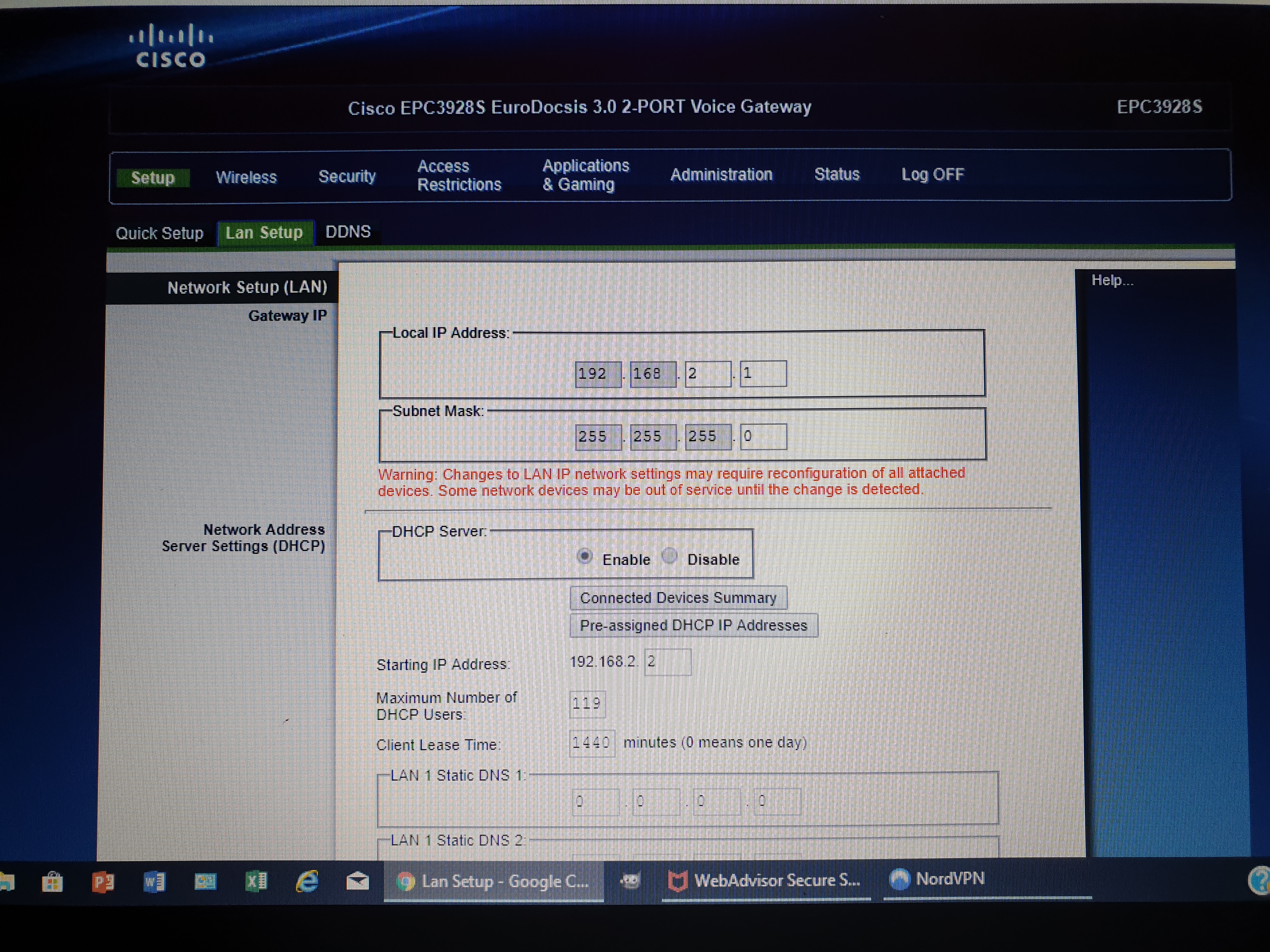

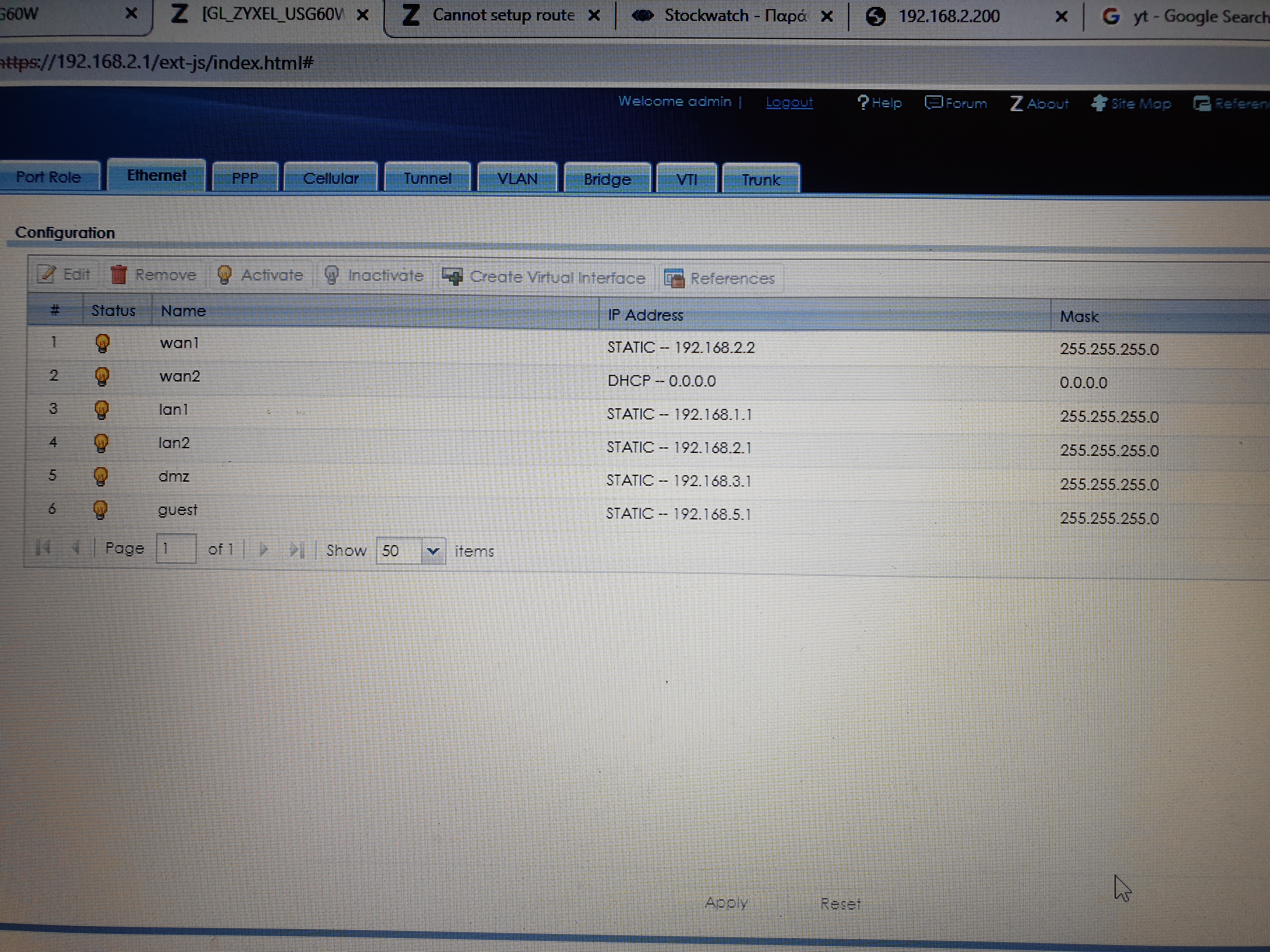

As your scenario, USG is behind a cisco device and it offer 192.168.2.x IP to USG.
Since USG default LAN2 IP address is 192.168.2.1/24. WAN and LAN IP has overlapped.
You can change default LAN2 IP address to other IP subnet then will able to access to internet without problem. (e.g. 192.168.20.1/24)

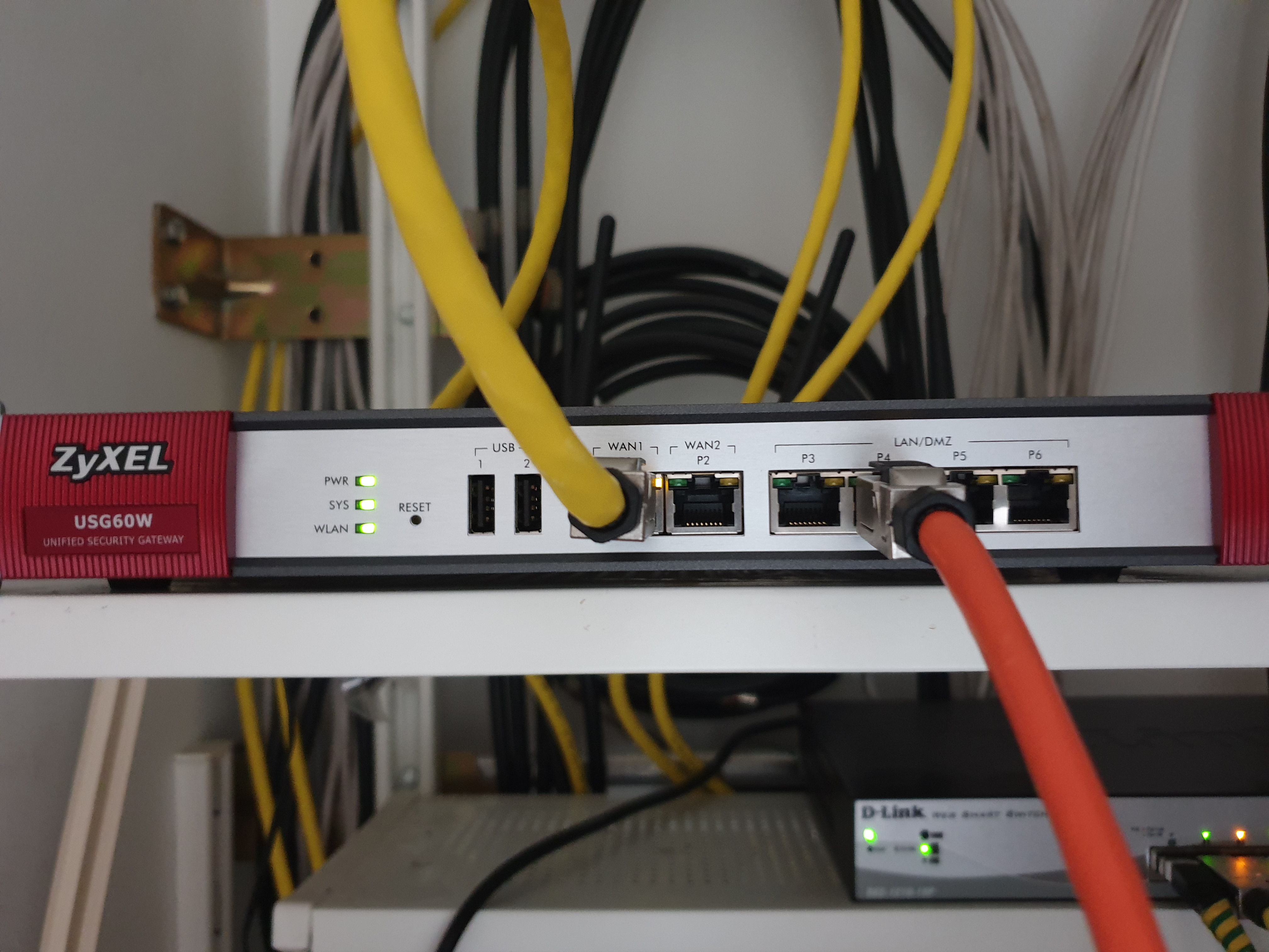

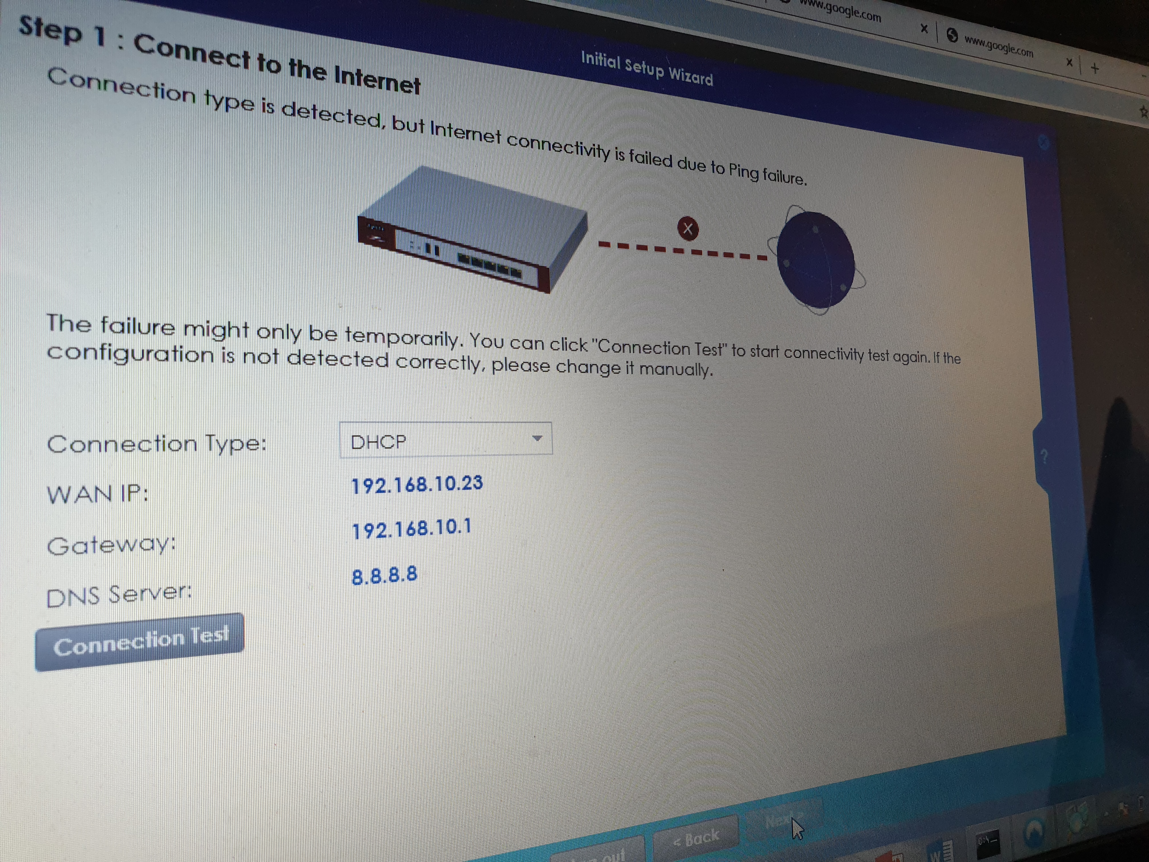

Guys thank you but nothing seems to work. I have connected pc with zylex in lan4 and internet router in wan1.
I have also changed ip to avoid conflict.
My pc gets connected with internet but zyxel does not connect in internet and setup does not continue.

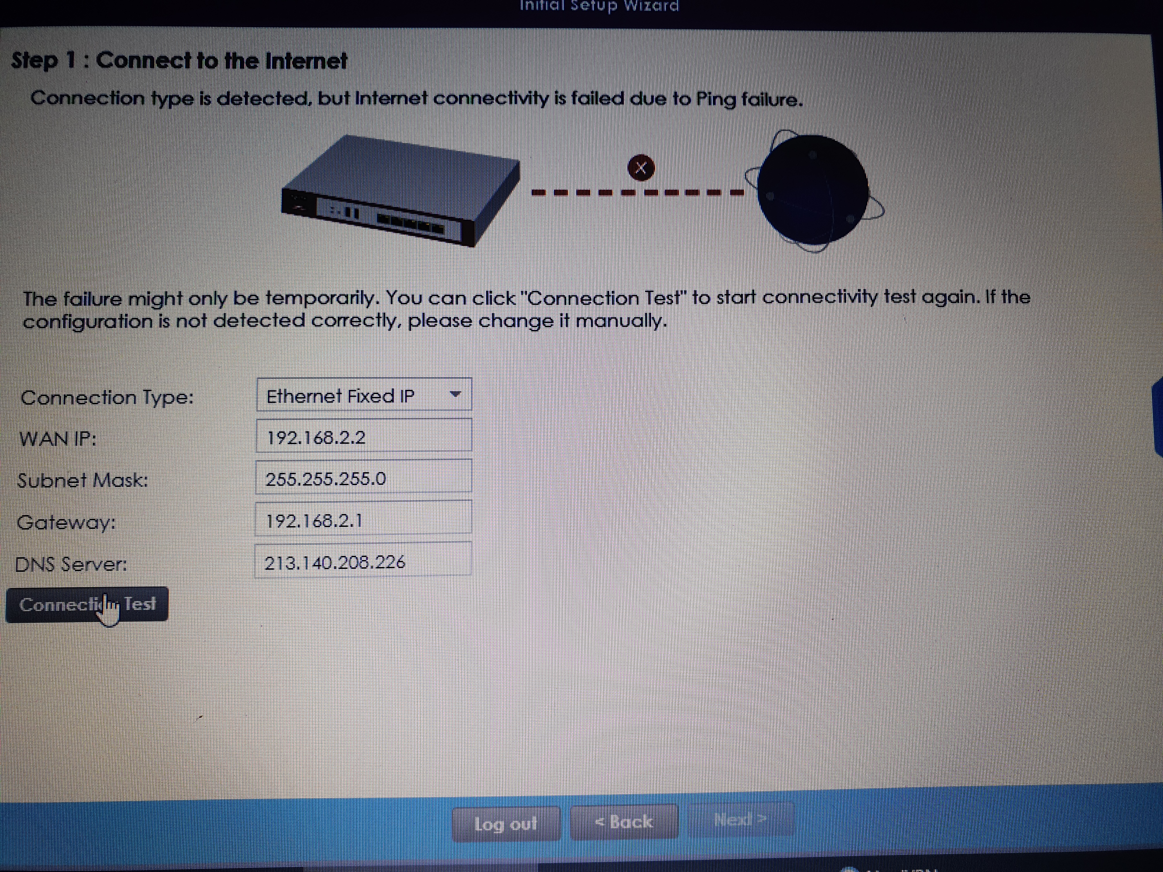

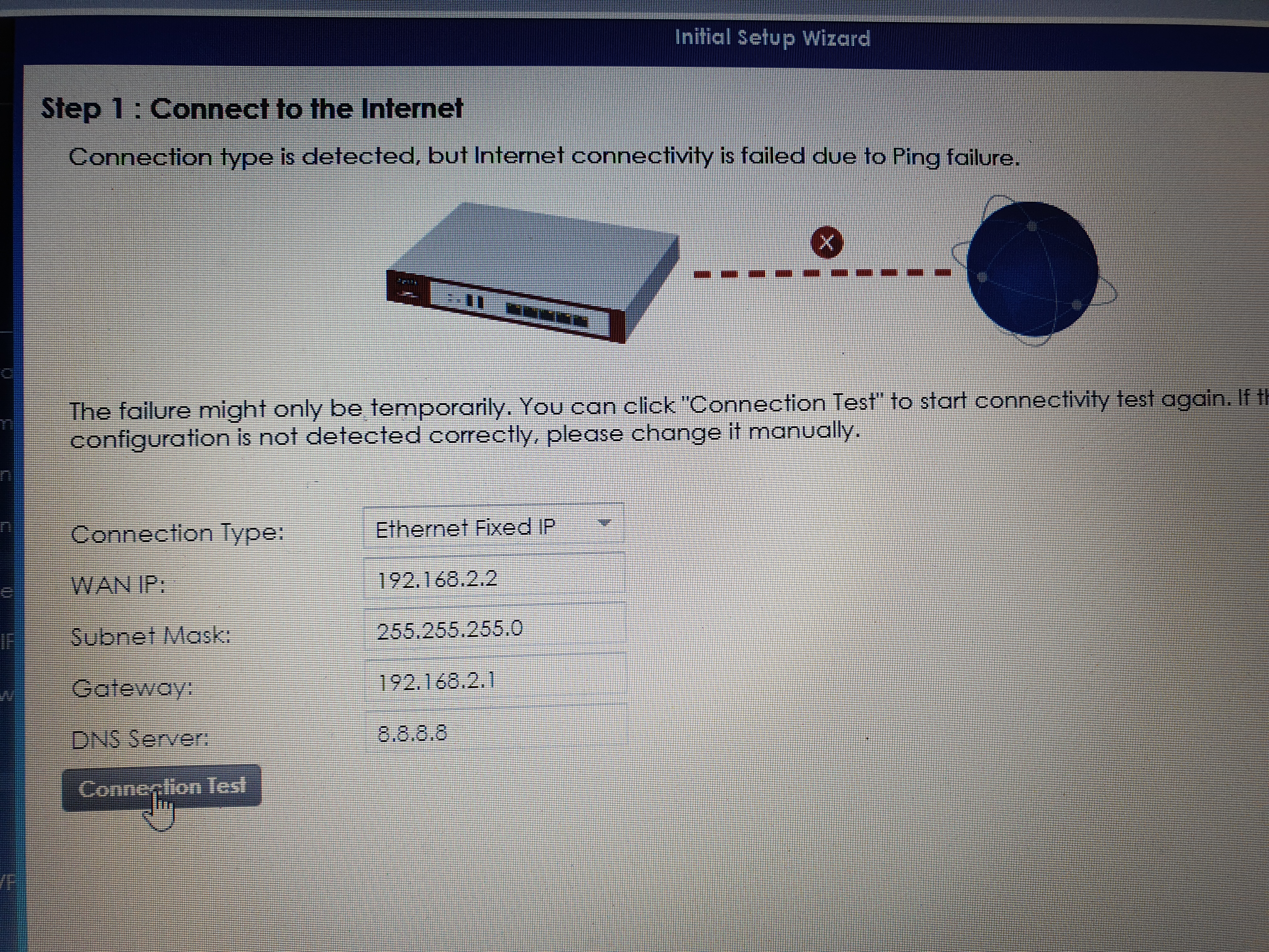

Hi @GLou
The initial setup wizard will send ICMP to 8.8.8.8 to check internet connection status.
If there is no any reply, then status will show fail.
Can you make sure if Cisco gateway is able access to internet and allow ICMP packet to Internet?

I have taken ZYLEX to office where I was able to continue setup. I have brought it back home however when I try testing 'test internet, it fails again.
My PC is connected to LAN1 port 2 and internet is fine.
But when i try running wizard seup or test internet in dashboard, it fails!!!
I ping internet router and replies 4ms?
What is going on?

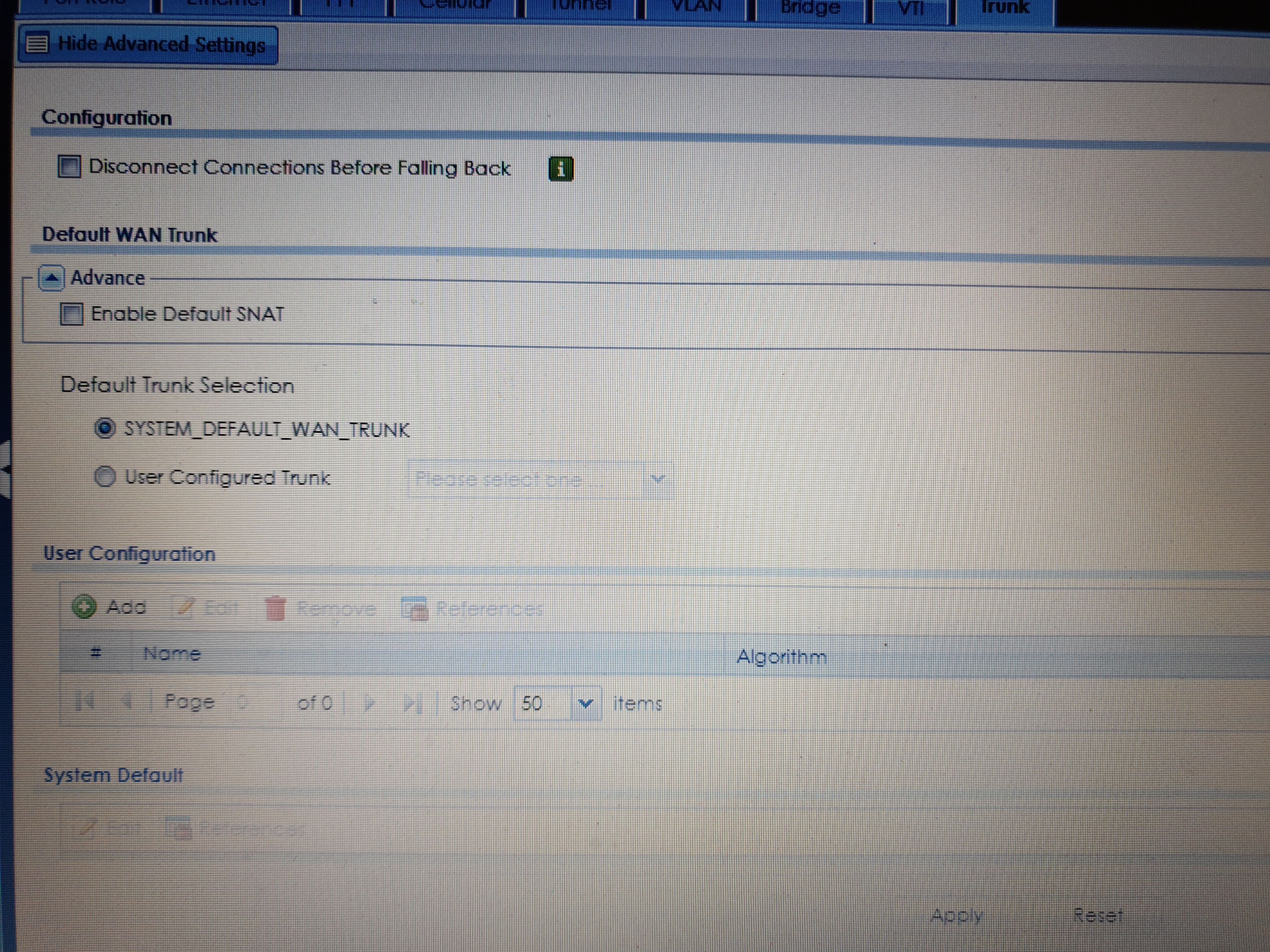

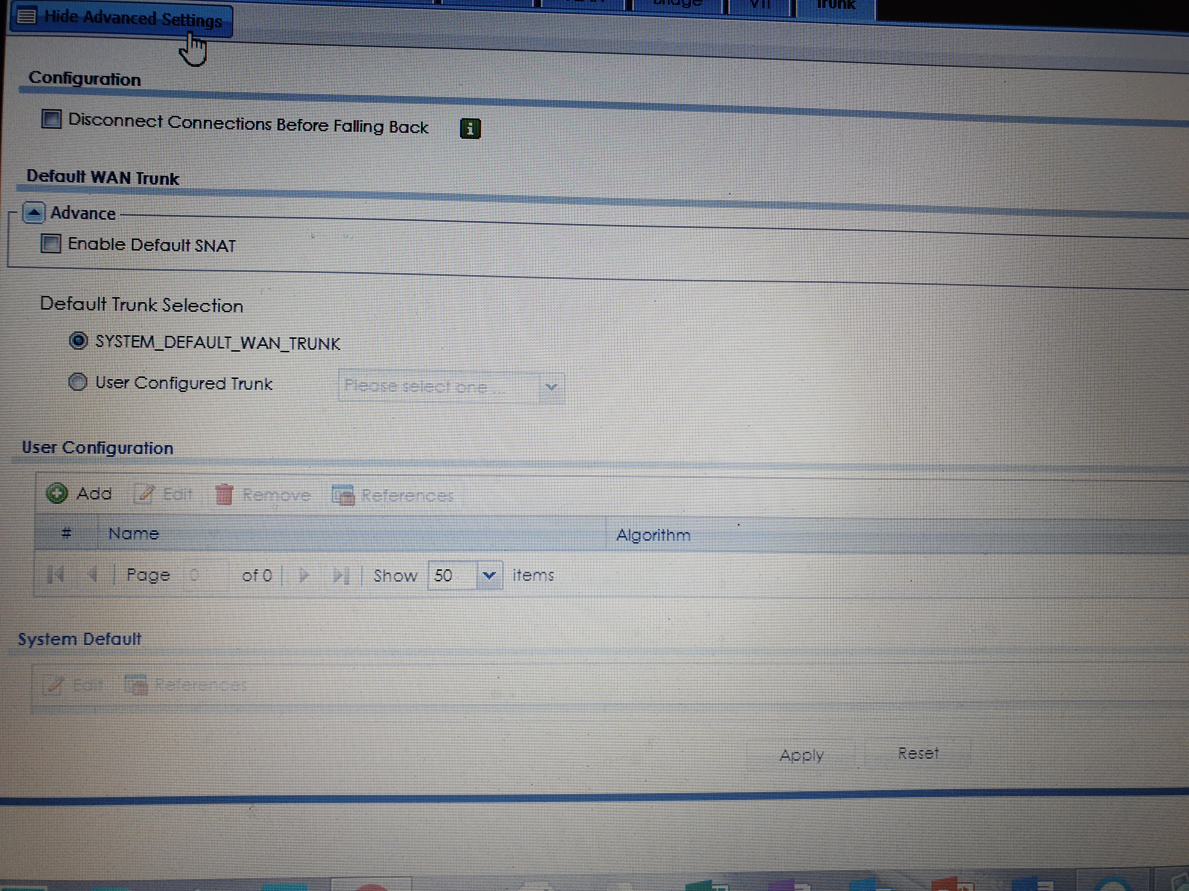

Have you disabled the NAT on the WAN Interface of the USG to avoid double s-NAT ?
if not sure, check the option on the USG
go to Configure icon, Network, Interface (TRUNK at the top)
- show advanced settings
- disable the option "Enable Default SNAT"
- save

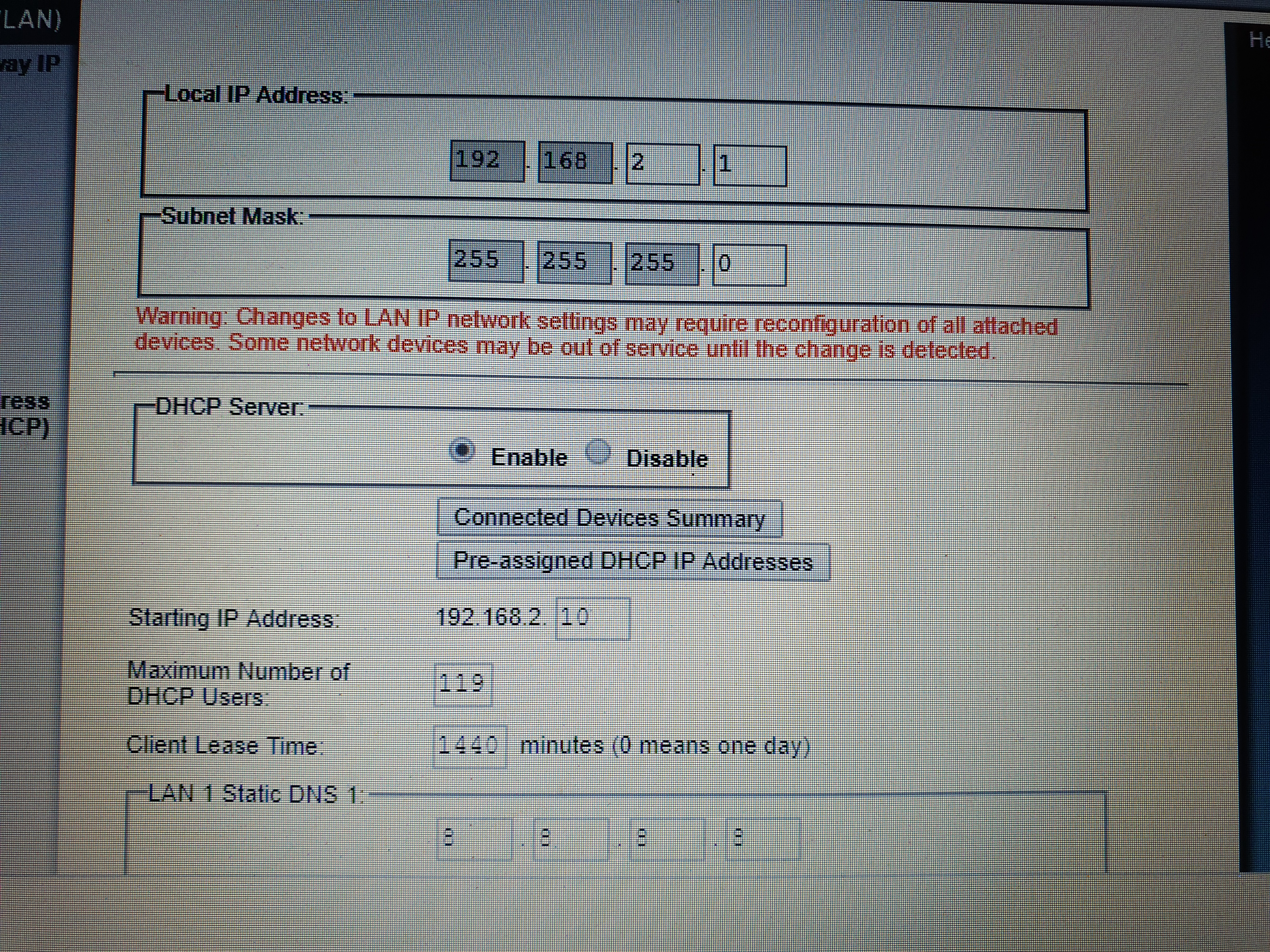

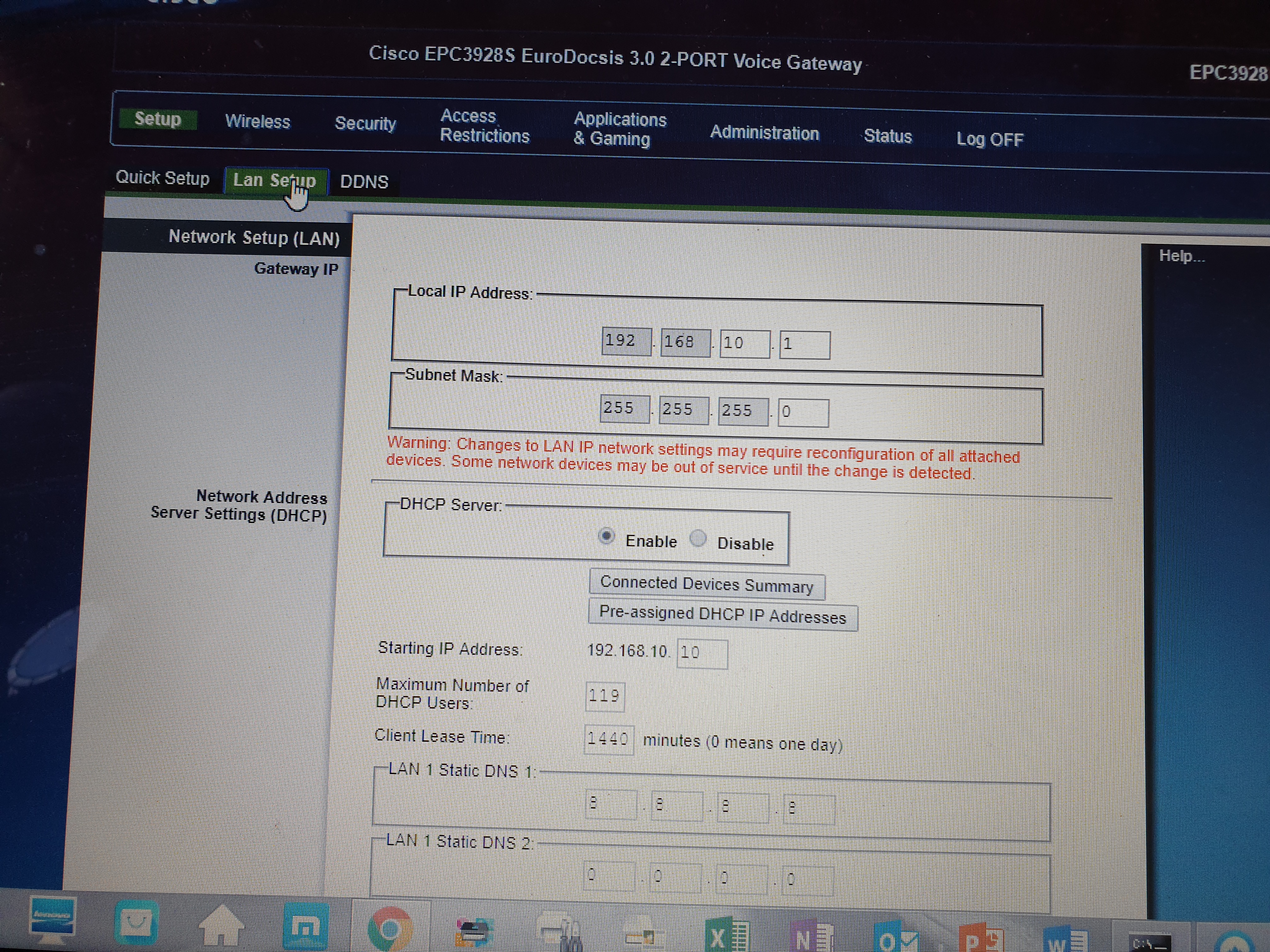

Thanks Christian for your time. Please note that i have disable NAT and have a static IP. Curtently i have only two cables connected. One in wan drom internet router and one in lan4 which goes ro my laptop.
I attach latest internet router setup and zylex setup.
My laptop has internet through zylex but the zylex wyzard gets my an error when i press 'connect test'
Does it have to do with the ips used? Please advice as it seems everything will go to waste...
I attach pictures for ease
