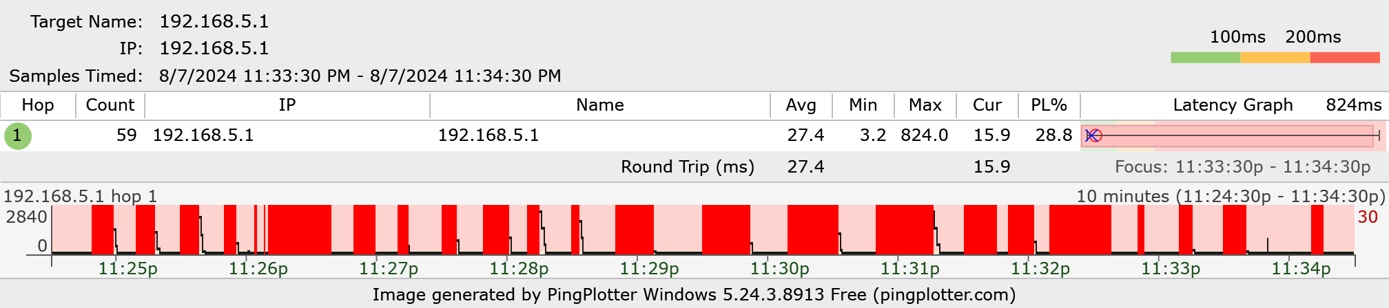

    I can't can 't seem to resolve this issue. I've Ivtr8ed every setting. All devices either has micro disconnections or it just won't pass data but stay connected. My 2.4 utilization is very high as well. It's not about my neighbors.
    maybe I have a devices on the 2.4 band causing this. That will be a tough find.
  • jpblanch75
    jpblanch75 Posts: 185 image  Master Member
    First Comment Friend Collector Fourth Anniversary Community MVP
    It appears that I may have fixed my issue. So far I believe I had a device causing the failure. Been running Ping Plotter for an hour now and not dropped packets.

    Well, it appears I spoke too soon. Its funny because right after I unplugged it, I
  • jpblanch75
    disconnected because of reason 8.
    this happens even when it's the only device on the access point. Roaming is disabled. Multiple devices doing this
  • Zyxel_Judy
    Zyxel_Judy Posts: 2,673 image  Zyxel Employee
    Hi users,
    The reason 8 is "Disassociated because sending STA is leaving (or has left) BSS". This reason is sending by a client when leaving the AP, and then AP will show this log.
    You can refer more reason code definition as below link:
    Zyxel_Judy
