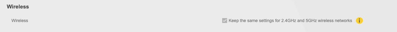

2. these networks wouldnt penetrate the whole house, so i switched back to mesh networking, and then installed some wifi extenders (tp link decos) but had to create a different SSID network for their mesh as they're incompatible with Zyxel's mesh.3. So the zyxel is now back on MPro Mesh with 2.4ghz and 5ghz under one SSID. However my ISP reports via the API that Band Steering is turned off. This setting doesn't appear anywhere on the GUI though.
4. The ISP told me the API documentation says that the tick box under 'Home → Network Setting → Wireless → General → Wireless' that says enable same setting for 2.4ghz and 5ghz is band steering. This was enabled and greyed out because MPro Mesh can't be turned on without the networks being the same (SSID and password).
5. The ISP remotely enabled it via the API, despite it being ticked and greyed out. Perhaps this is where a bug in the firmware is located.0 -
