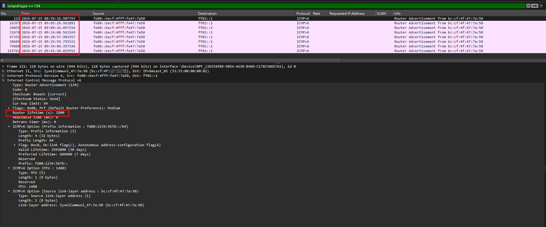

Hi all,
i just ran into the same wall. Or better was able to identify that I ran into THIS wall. After months of problems with my phone in my wifi after aquiring a new Zyxel AP and constant Half-Dropouts I found out it's
multicast-to-unicast(DMO) that causes IPv6 ICMPv6 Router Advertisements sent to the all-nodes multicast addressff02::1to not be delivered to wireless clients. The reason why the captured packets still sees them, is that DMO runs AFTER the trace.The following is written by Claude, I hope it helps someone or even gets Zyxel to FIX THIS!

DMO ENABLED (default): a client went >2 hours with zero RAs received — verified on the client (Android APF:
RA … Last seen 7061s ago;ip -6 route: IPv6 default route absent on Wi-Fi) — even though the LAN's IPv6 router was sending multicast RAs toff02::1every ~46 seconds the entire time (verified by packet capture on the router's LAN, on the AP's wired interface, and on the AP's BSS interface).AP
packet-traceon the client's 5 GHz BSS: the RA is present onwlan-2-1as multicast (fe80::… > ff02::1: router advertisement, router lifetime 1800s) — i.e. the frame reaches the AP and is dropped/not-delivered in the DMO/TX path, not upstream.DMO DISABLED via CLI:

Hi @forfrossen ,
Following your description, we conducted a local test using a Windows laptop. When the Multicast t0 Unicast is enable as default, over a 30-minute period, the laptop continued to receive RA packets.
Could you please help verify whether this issue is specific to phones only?
