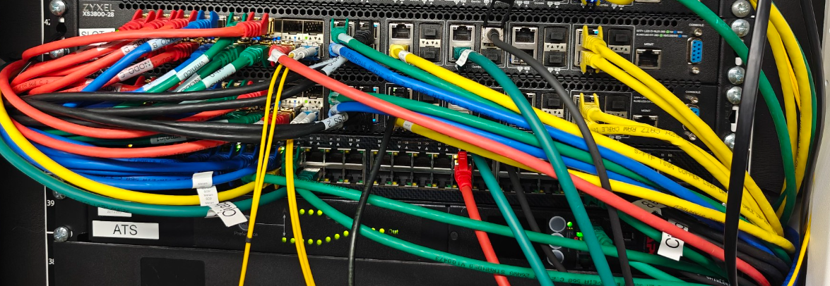

    Hi @Zyxel_Tina ,
    we have all sfp port full… i cannot move… sorry.. The switch are in a datacenter (18 °).

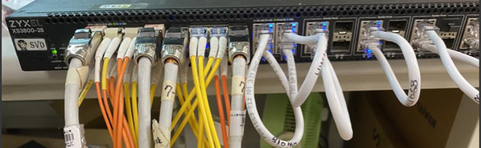

    Hi @Omnia,
    Sorry for the late reply!
    Based on the images you provided, we can see that all SFP ports are fully populated with 10G base-T modules in consecutive ports. We generally do not recommend this setup as it tends to generate heat accumulation. It is usually advisable to alternate connections between 10G base-T and fiber SFP modules to prevent overheating issues.
    We understand that you are currently unable to change the port arrangement. Therefore, as you mentioned before, separating the stacking switches by at least one rack unit is a good practice to improve airflow. Please try this method and see if it helps alleviate the overheating issue.
