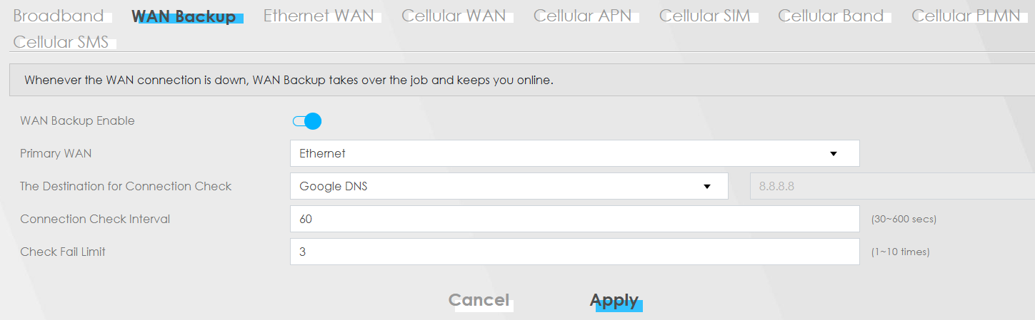

You need to enable this
However there is a problem with it it seems due to the way it check ping out Ethernet which I will post about but I have another way of doing failover.
So heres what happens ping to 8.8.8.8 is fine you go out Ethernet then ping fails and you go out Cellular then when ping is successful again you go out ethernet all seems good right? well no
So in short what the connection check is set too forces all traffic that was going out Cellular to test Ethernet and will check for the number of check fail limit then if on reply to ping goes back to Cellular meaning their is a interruption as ping checks out ethernet so the only bad workaround is set connection check high and check fail limit low.

0 -
Thanks PeterUK.
I do have the WAN Backup enabled, but will check your suggestion with a high interval and low fail limit.

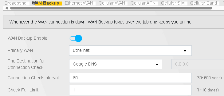

0 -
Awesome PeterUK. Your suggestion with interval 60 and fail limit 1 did solve my issue. Can go back and forth between ethernet and cellular now. Many thanks!

I posted a case with support to see about the problem I found.
What I found that happens is every interval check (60 secs) by fail limit (1 sec) there is a 5 secs move from Cellular to Ethernet even if Ethernet is down by my checking which is Ethernet up and ARP is up but ping fails.
But if Ethernet is up and ping ok all is fine its just the fail over of ethernet that's the problem
