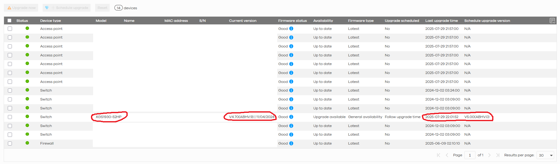

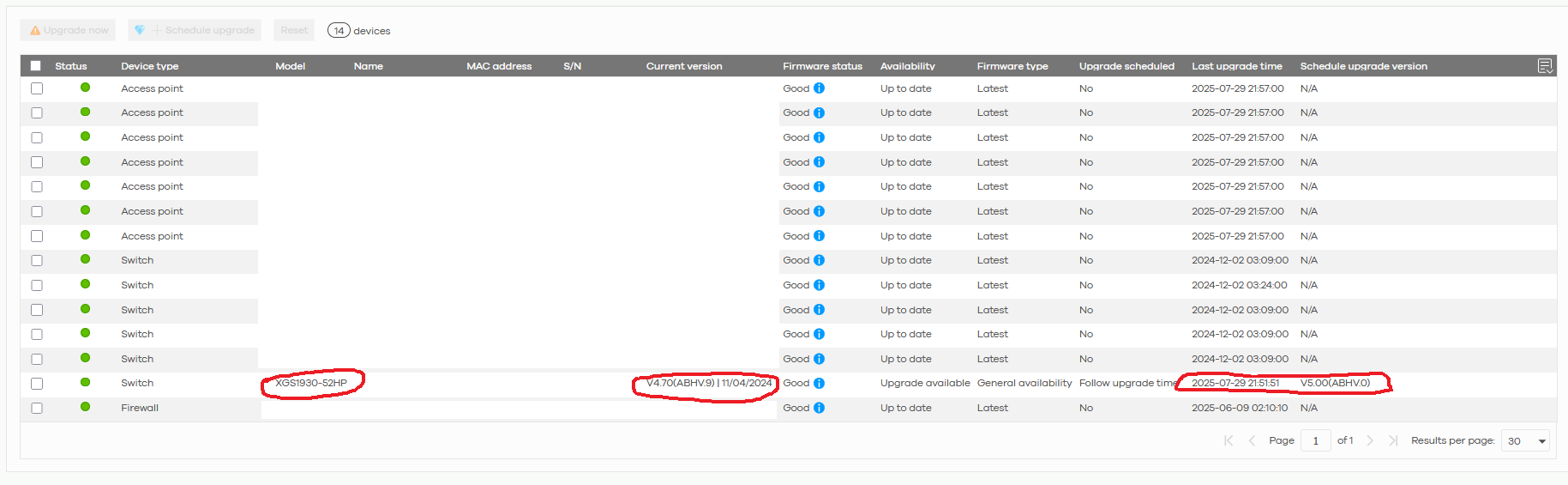

I tested the firmware upgrade option from Nebula 19.10 to newest hardwares' firmwares.
I tested APs, switches and firewalls.
Everything seems smooth, except with XGS1930-52HP: I tested it twice.
As you can see here:
And here
The "last upgrade time" is updated but no firmware update was completed successfully.
How can I solve this issue?
  • Zyxel_Melen
    Zyxel_Melen Posts: 4,895 image  Zyxel Employee
    edited July 2025
    Hi @GiuseppeR
    Please help to check:
    1. Check if this switch is online.
    2. Check if the uplink firewall allows "*.nebula.zyxel.com" and "port 443."
    Also, could you help enable zyxel support access and this org's name so I can help to check what caused this failure?

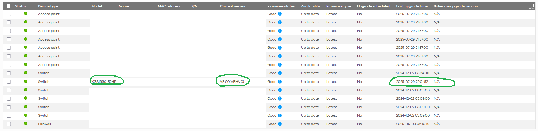

    Hello @Zyxel_Melen
    right now, so after 12 hours from those errors I see it online and updated:
    Do you still need to access it to check something?
