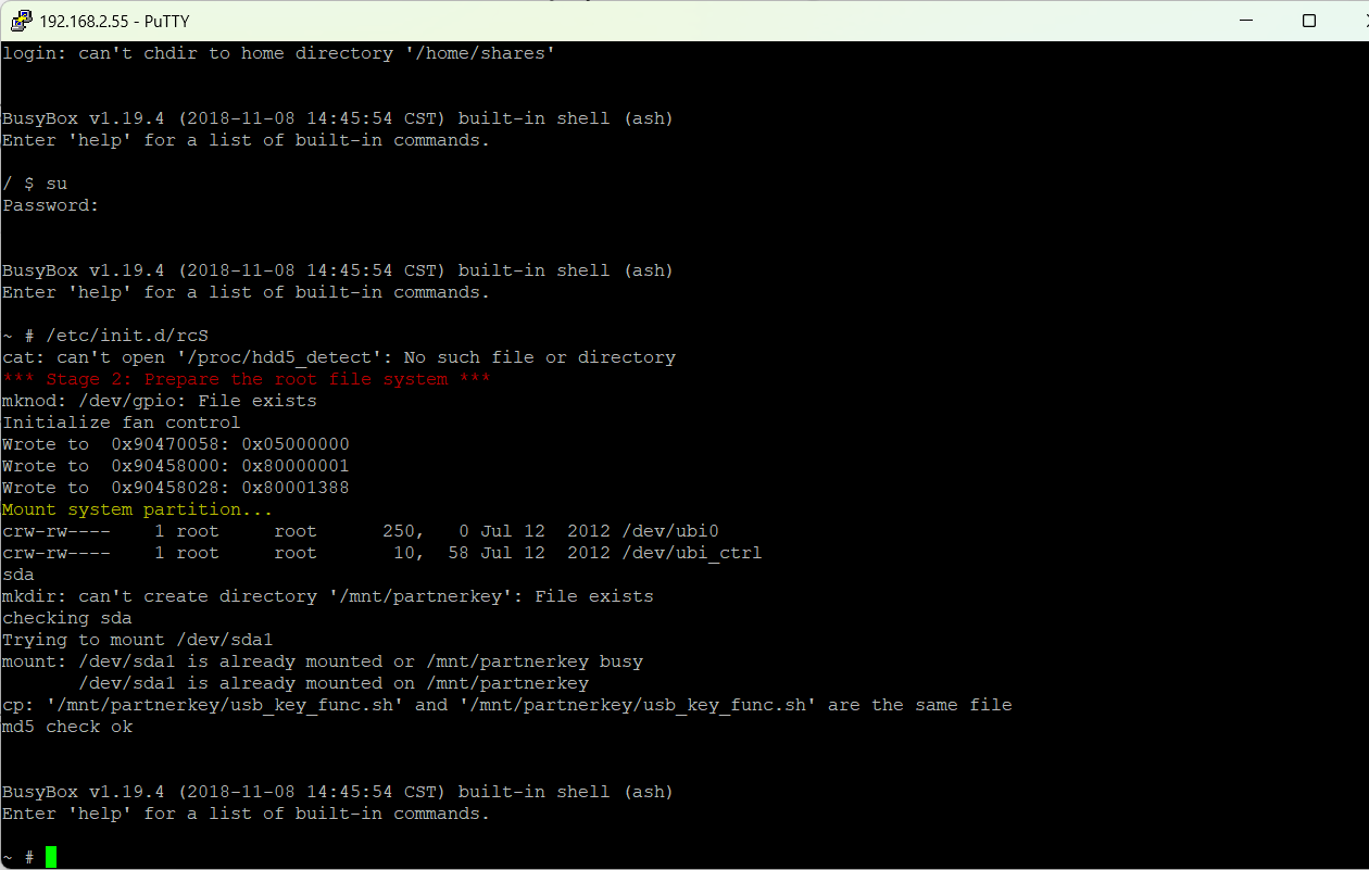

    This comes out:
    / $ /firmware/sbin/info_printenv
    envfs: wrong magic on /dev/mtd2
    If you go to /etc/init.d/rcS it is displayed as in the screenshot.
