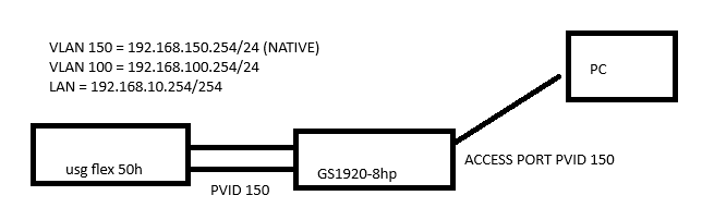

Hello,
we want to change the native vlan in our network.
Example config:
I have an LAN interface, let say 192.168.5.254/24
further 2 vlans. one 192.168.150.254/24 vlanid 150 and 192.168.100.254/24 vlandid 100
i want to use the 150 as my native vlan.
so i create an access interface on my switch with pvid 150
and set on the trunk interface between my switch and flex 50h the pvid also on 150.
so when i connect my laptop to the access port on the 150 network, i would expect that i get an ip in the 150 range. but that isn't the case, i get an ip in the 5 range.
can someone explane why this is? off course i can set an other pvid on my trunk lines, but then i have to create again an other vlan with the same purpose. (at the moment i have dhcp etc enabled for testing, at the end i want to make it an dead end.). (no ip adres dhcp etc.)

    Hi @Dpj
    I assume the switch is running Nebula mode.
    Please do not use the PVID 150 on the link that connecting the switch and 50H. Nebula will untagged this VLAN for this port. Once you set access port PVID 150, VLAN 150 is created on this switch. The trunk ports will forward VLAN 150 packets with VLAN tagged.

    I mean this situation. I would expect the pc get's an ip from vlan 150. But (At least yesterday) wasn't the case, i got an ip from the LAN. So how to handle this. What happens is the untagged package from the pc, is tagged in the switchport with an vlan150 label. Then the switch sends it over the trunk line, (which accepts all vlans (in my case), and there is something going wrong.
    when i change the pvid on the trunk line, it's working well. So? must i create multiple dead vlans? 1 for the access ports, and 1 for the trunk lines? I would expect i can use 1 native vlan for both isn't it?

    image  Master Member
    different ip ranges as the first one, but just for the idea
