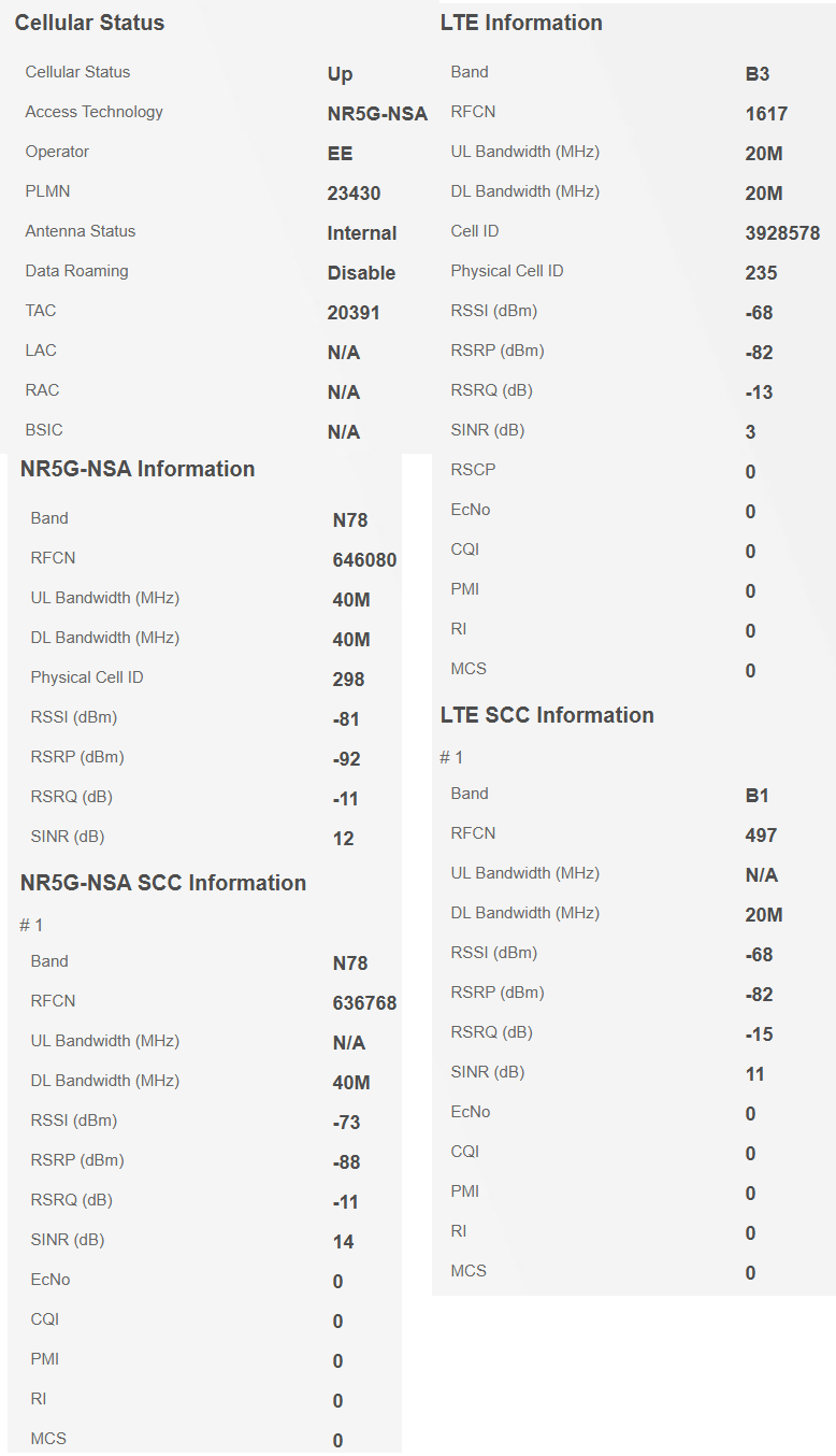

this is what the Cellular Info looks like so far
was testing by speedtest.net
0 -

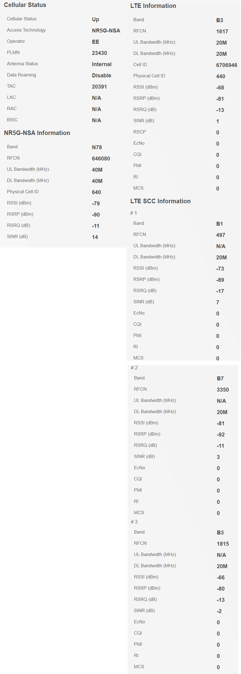

So with a uptime of 1 day 8 hours the Cellular Info has changed with no NR5G-NSA SCC but speed is still fine at this time.

Hi @PeterUK
Although screenshot 2's 5G CA misses secondary 5G CA N78 than screenshot 1, the primary 5G CA N78 (ul/dl bandwidth=40) is still in the NSA combination. Therefore, the download and upload speeds for the cellular band combinations in these two screenshots should not differ significantly.
We speculate that when download and upload performance is not ideal, it's related to the band combination and UL/DL bandwidth. Please observe the cellular info when the problem occurs again to see if there are any missing band combinations and UL and DL bandwidth in the cellular info.

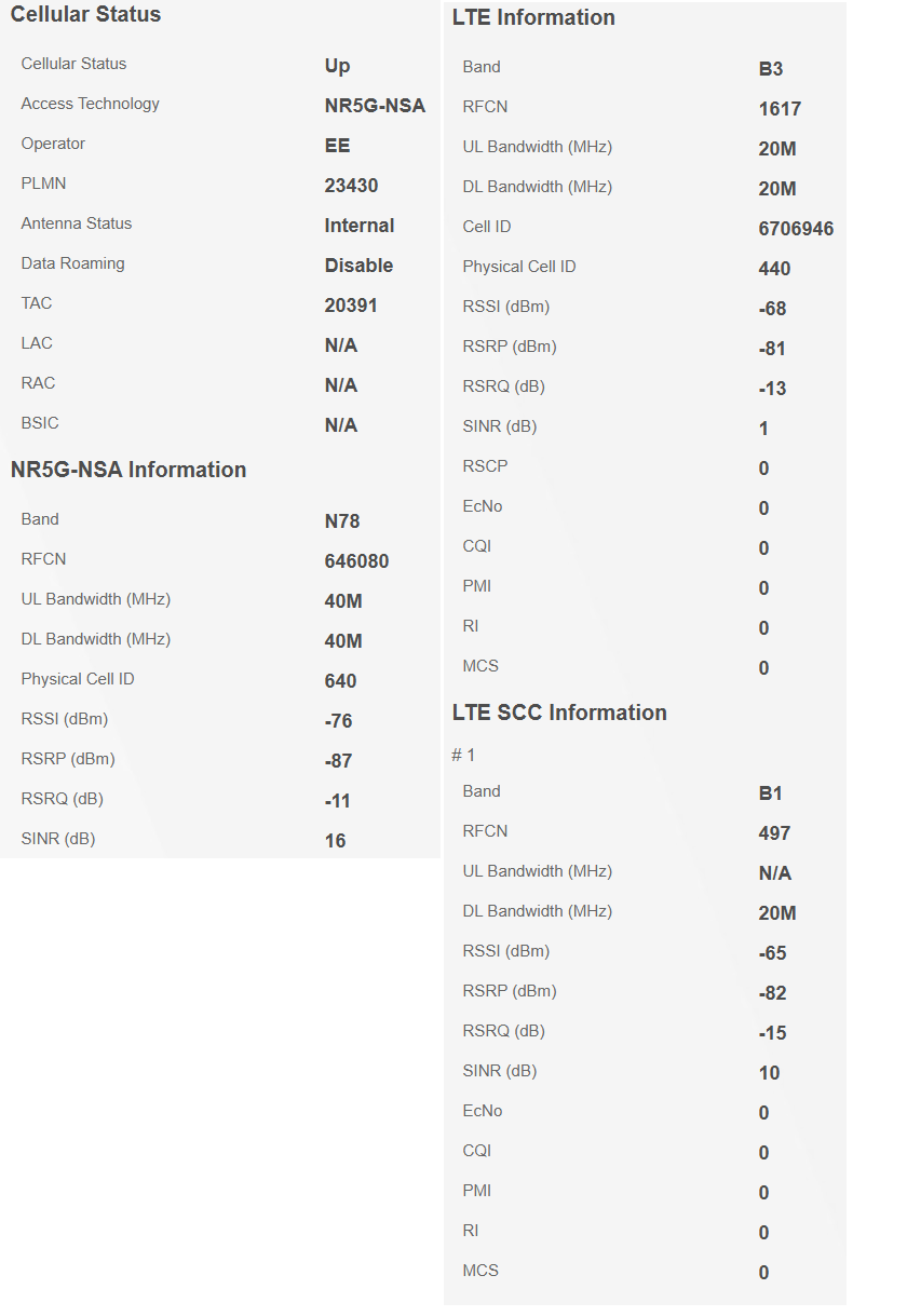

It seems the NR5G-NSA SCC comes back when at load doing a speed test then this happens at idle
speed still seems fine so far
