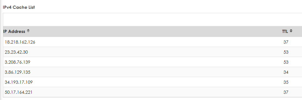

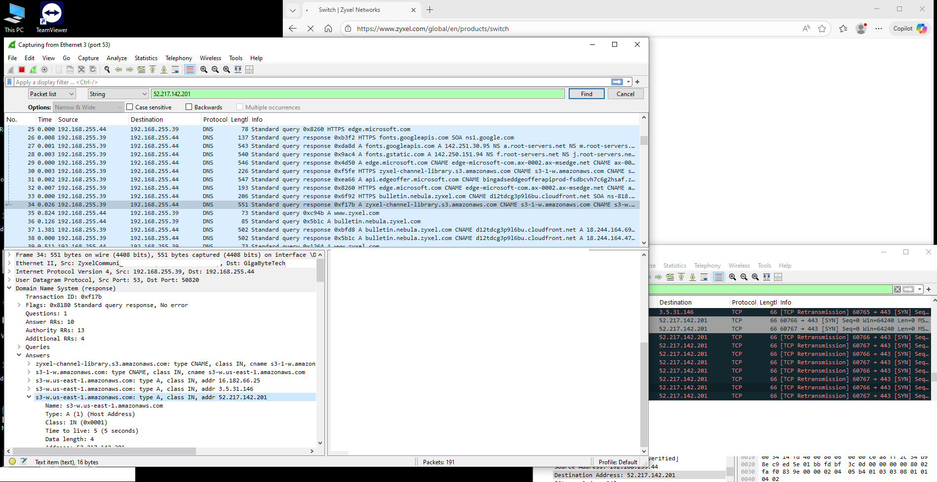

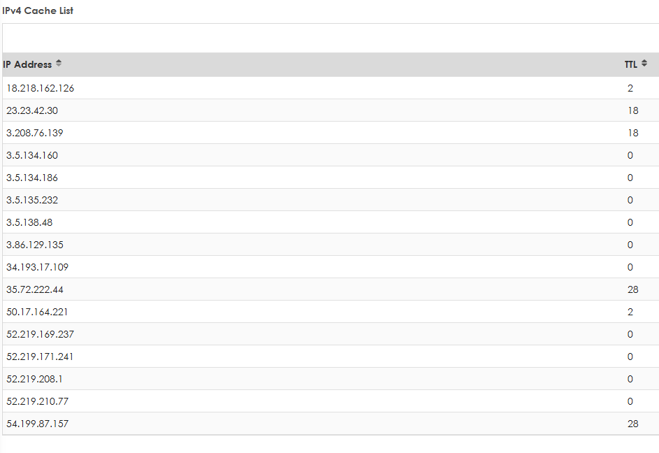

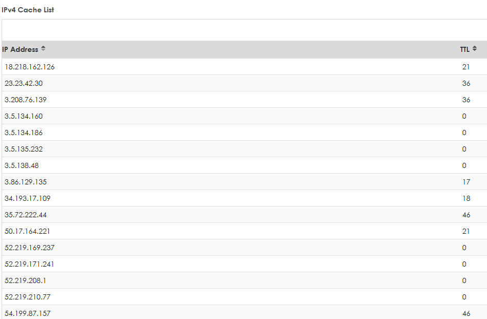

    So I try to capture the FQDN cache for *.amazonaws.com the site uses with Expire cache by TTL enabled and it changes a lot
    Screenshot 2025-09-15 130719.png Screenshot 2025-09-15 130736.png Screenshot 2025-09-15 130759.png
    Then the problem happens
    Yet I never see this IP in the FQDN cache 52.217.142.201 that I could see but its TTL is super low of 5 seconds so I'm wondering if it even gets cached? where as disable Expire cache by TTL does cache it?

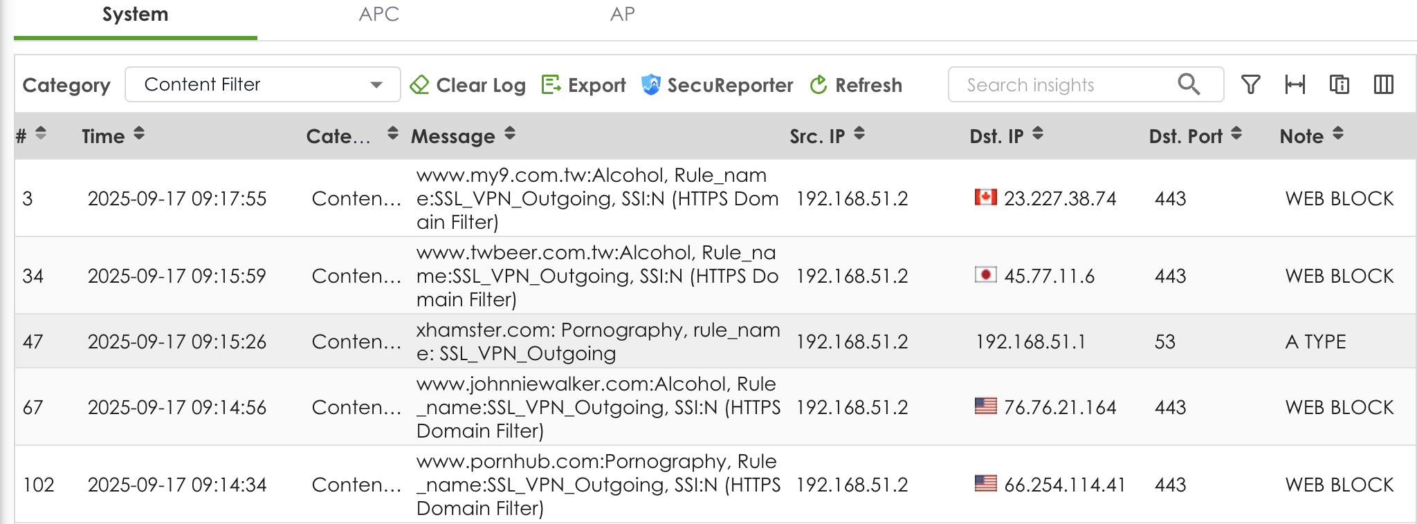

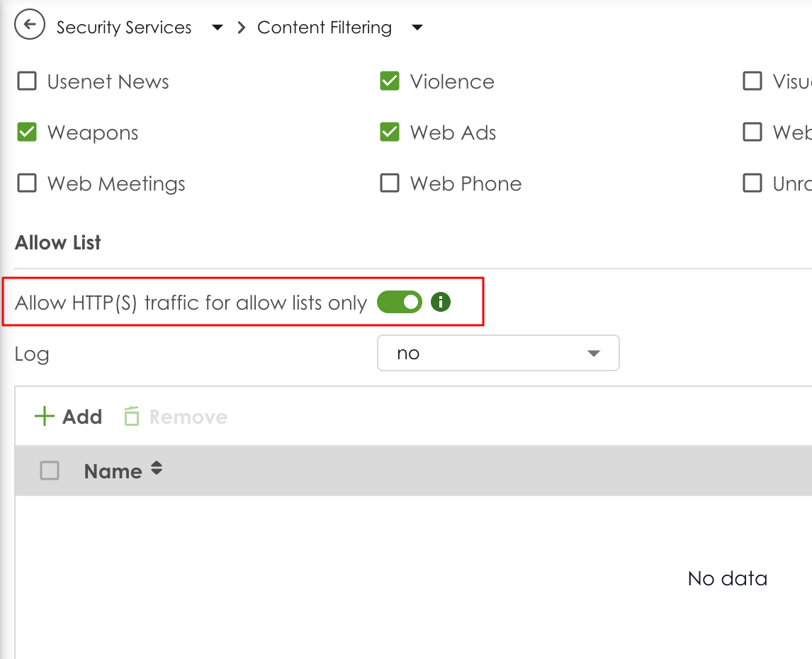

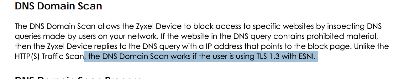

    • Differences between DNS and Content Filtering
      • Content Filtering does not block traffic through DNS, but rather checks the SNI in the TCP Client Hello. I'd like to clarify whether FLEX H truly has a "DNS-based content filter."
      • ->Yes, the DNS filter enhances blocking effectiveness, for example, in the case of Encrypted SNI. image.png As shown in the image below (Our lab test result), some are blocked by the web block (content filter) and DNS scanned because they use ESNI. Simply put, web CF is prioritized unless ESNI is used. image.png
        Please refer to Page 331 of the User's Guide for more details of information on rule exclusions. link

    • Behavior after "disabling Expire cache by TTL" is as follows:
      • After disabling Expire cache by TTL, cached IP addresses will be "retained as much as possible" regardless of TTL. If all cached IP addresses have expired and the fqdn object does not have a wildcard, by default, the DUT will trigger a query every two minutes to collect new IP addresses. If the number of new IP addresses exceeds 512, the oldest will be removed first.
      • With wildcards, the DUT cannot actively query the domain. It relies on client query results to collect cached IP addresses and retaining as much as possible. Similarly, if the number exceeds 512, old IP addresses will be removed.
