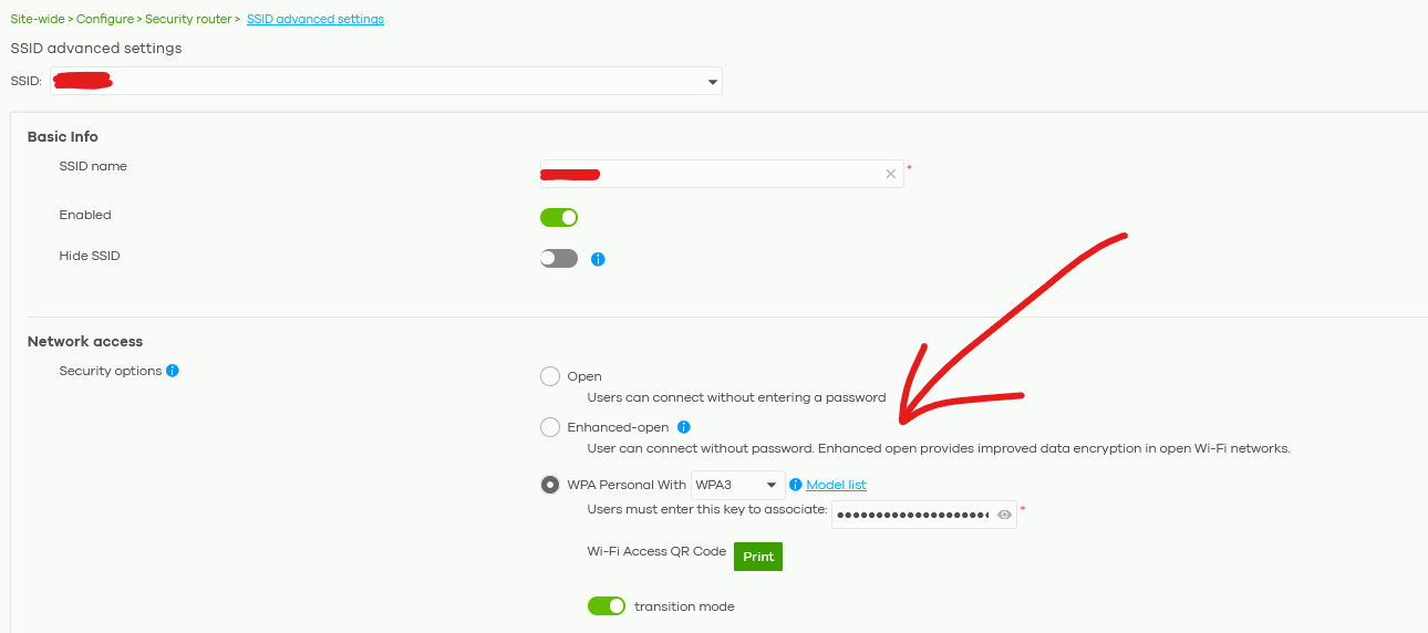

Anyway I have to use WPA3 with these settings:
Changing WPA2 to WPA3 gives me the chance to connect also old laptops.
As you can see above I just modified "WPA2-Personal" to "WPA3-Personal"
This is a bug.

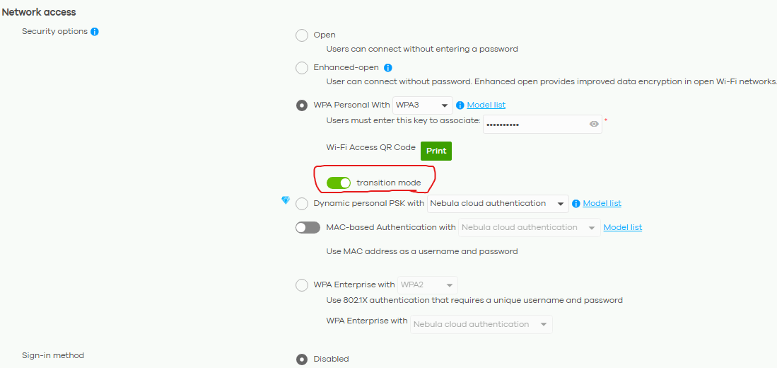

    As soon as I set the WPA3:

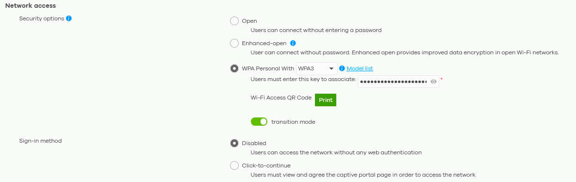

    inside that SCR50AXE's Nebula config:
    they went online.
    Please consider that WPA3 setting inside SCR50AXE settings… should show "Transition mode" button like you can see inside 60 LITE:
    I'm at your disposal, see you soon

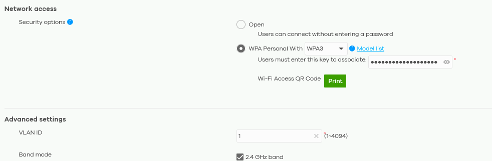

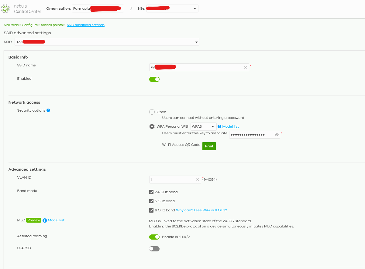

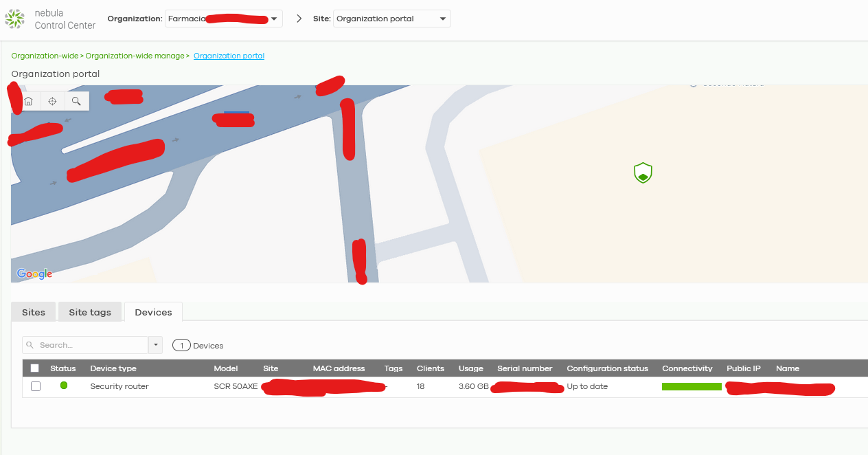

    In this site I have a SCR50AXE:
    But I cannot see WPA3 Transition Mode like you told me, I have ONLY a possible choice of WPA3:

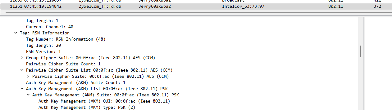

    1. About the SSID visibility and WPA2 vs. WPA3 Transition Mode
    We’ve analyzed the behavior and compared the wireless beacon frames under WPA2 and WPA3 Transition Mode.

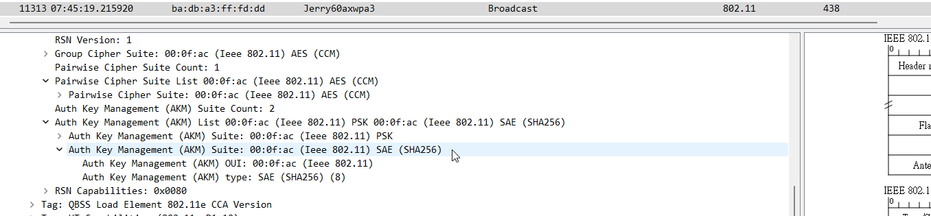

    • Under WPA3 Transition Mode, it advertises both PSK and SAE authentication methods. image.png
    In other words, both WPA2 and WPA3 Transition Mode SSIDs are broadcasted as expected.
    2. About the missing WPA3 Transition Mode option on SCR 50AXE
    We’ve confirmed that what you observed is expected behavior.
    When a site contains only an SCR device (without any Nebula-managed APs), the option for WPA3 Transition Mode and some other settings (such as Sign-in method) will not appear.
    These options are designed for AP management, so they become available only when at least one Nebula AP is present in the same site.
    Hope this clarifies the difference and explains why your site behaves differently from the one I have mentioned and shown in the image previously.😉
