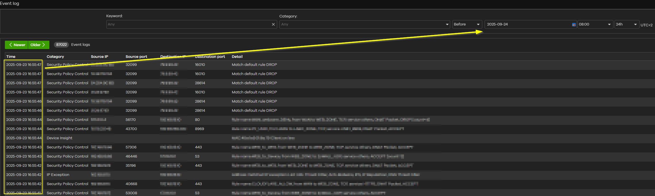

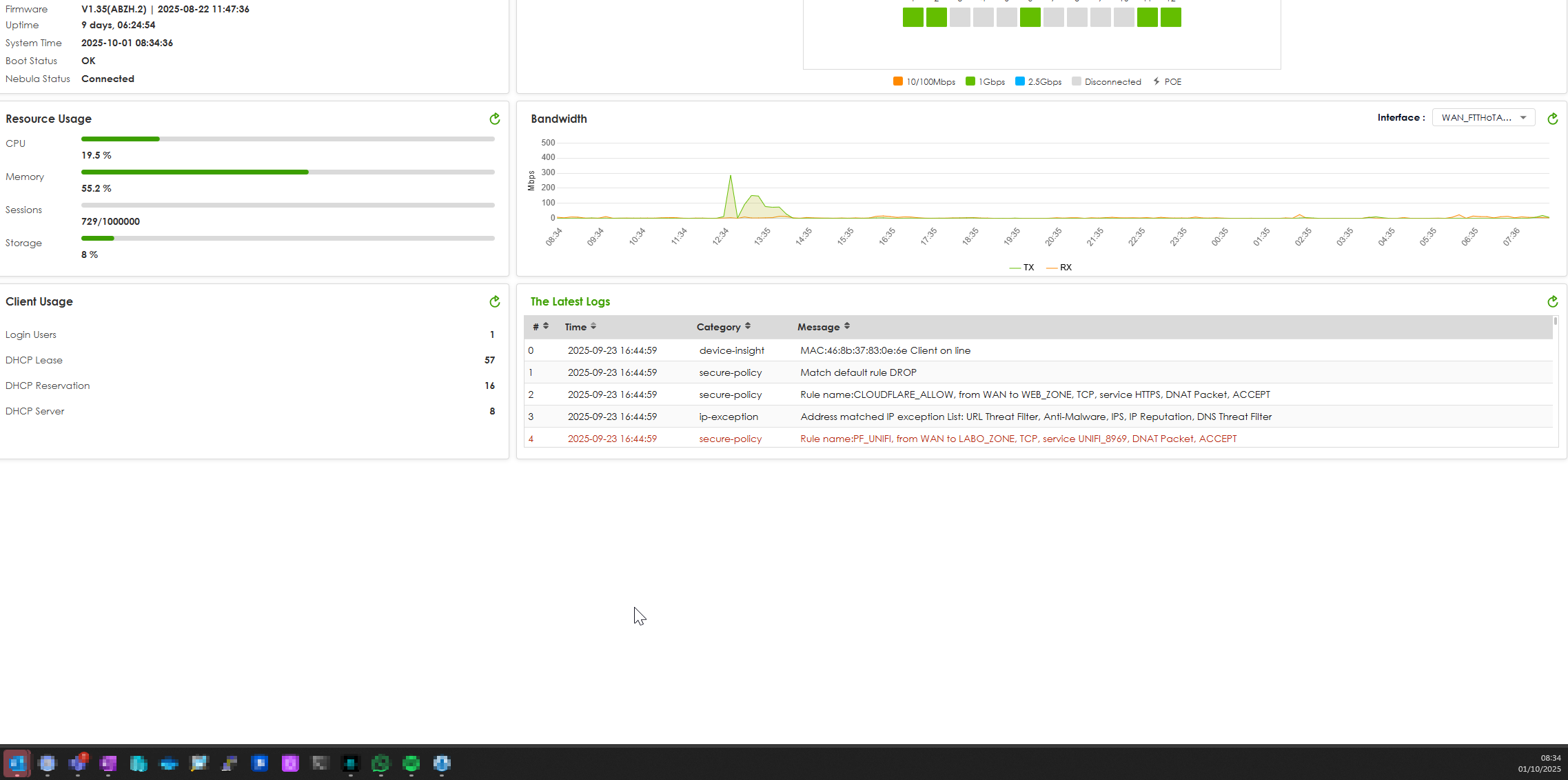

Hello, the logs on our 500H are broken again, even with the latest firmware 1.35(ABZH.2) as you can see in the following picture

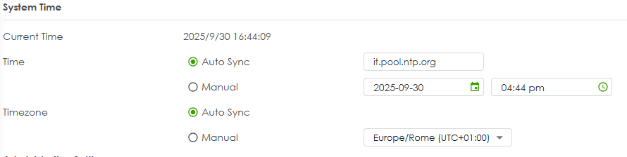

    Logs and time seems fine here can you check in USG system > settings the time is correct to windows?
    I also use windows as a time server for my USG
    ConfigureNTP Server in Windows Server 2019/2022 | ComputingForGeeks
    You will also need this set on the USG by SSH
    edit running
    vrf main ntp maxdistance 16
    commit
    copy running startup

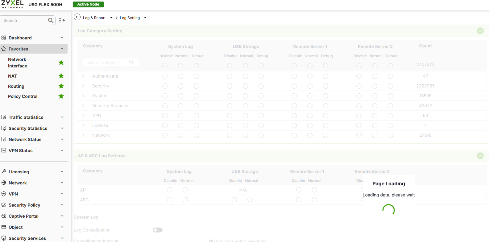

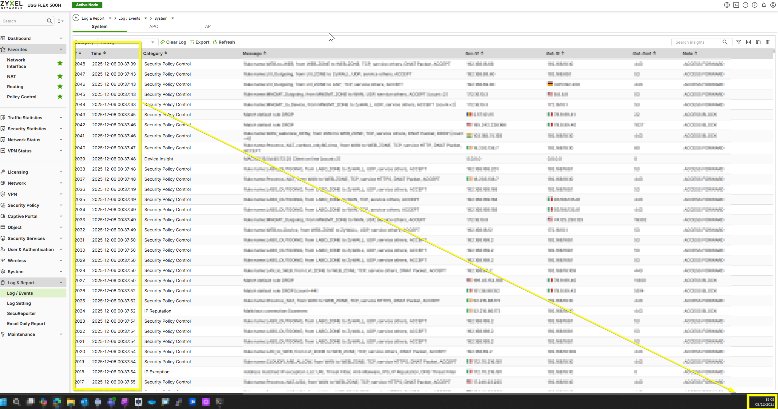

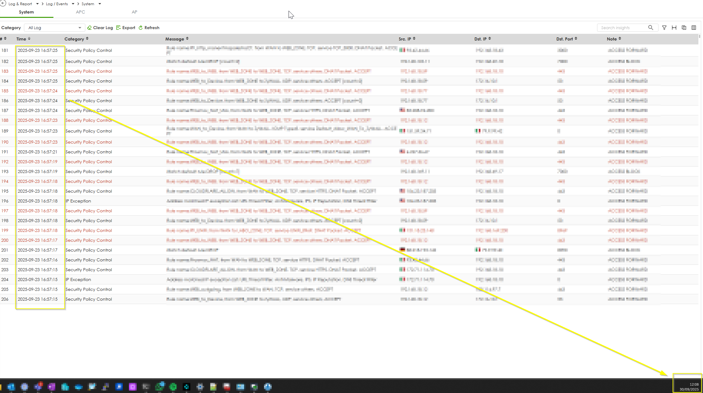

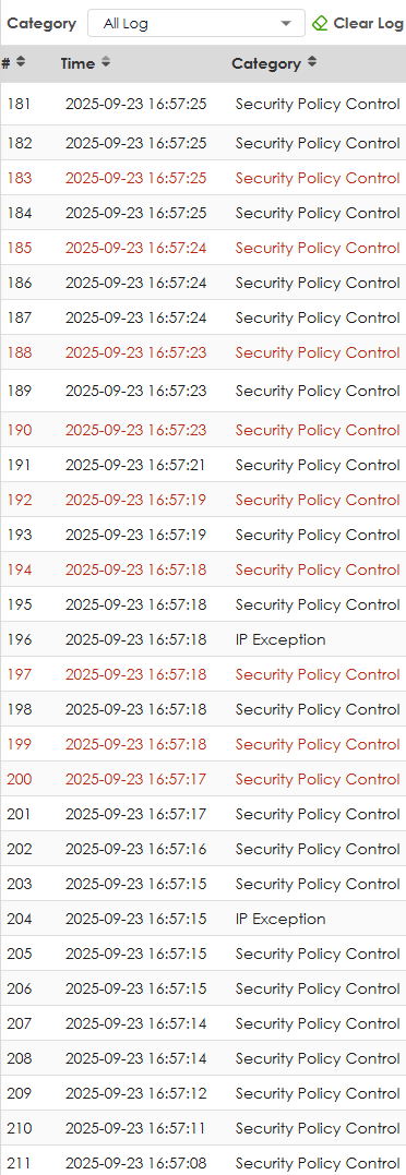

    @PeterUK The logs and time aren't fine unfortunately…. The logs are stopped since one day after the last boot of the device
    We had the same issue with firmware version 1.32 too

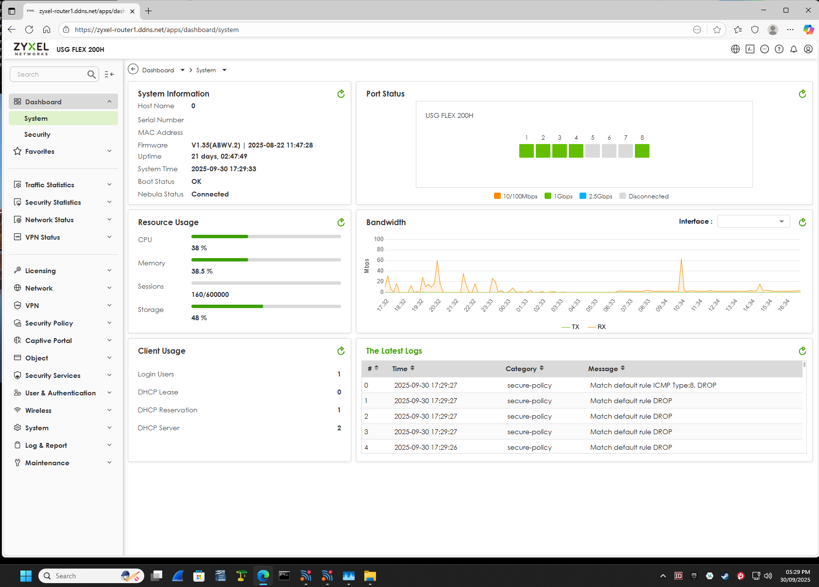

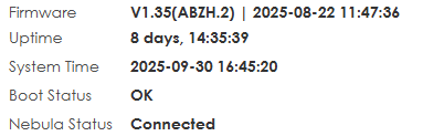

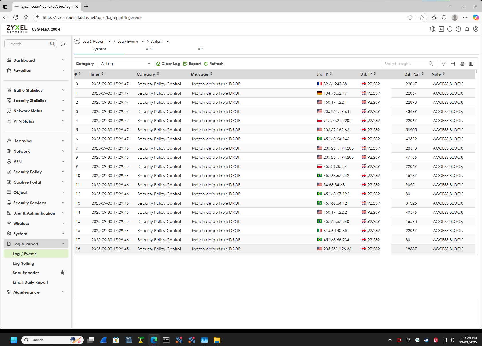

    Seems fine here like I said time matches in real time
    I suggest you test setting up windows as a NTP server and see if that makes difference?
    I know that with these FLEX H they send logs to nebula maybe your not linking to the servers correctly and its causing a problem? I know that I'm in a case where the USG fail to connect to server sometimes.
    Do you have many WAN IP uplinks?
