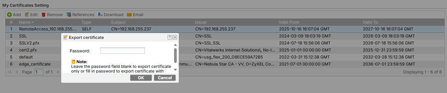

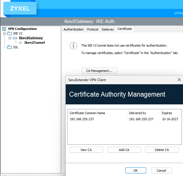

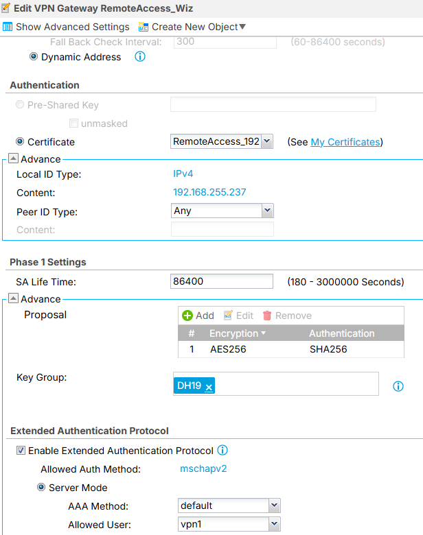

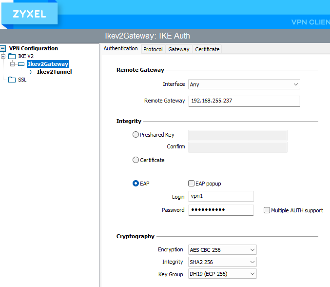

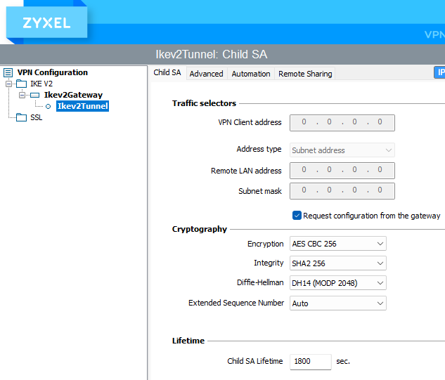

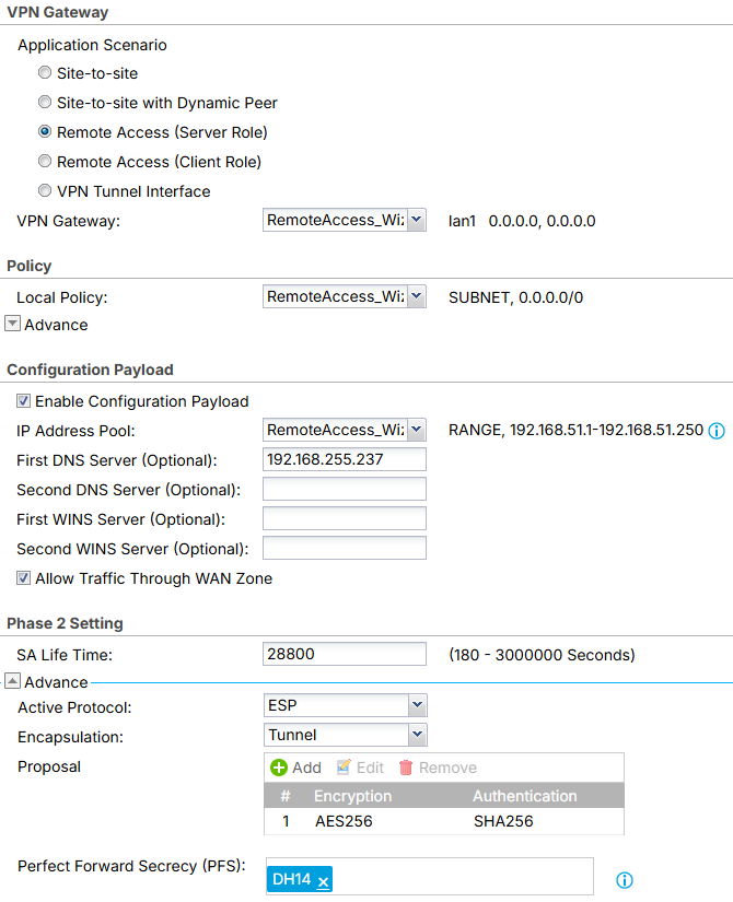

    In which case you need to download the certificate USG made to the SecuExtender
    copy gateway setting to SecuExtender
    download certificate without a password
    added to certificate SecuExtender
    copy VPN tunnel setting to SecuExtender
    For the VPN to work by WAN as you are behind NAT you need to make a certificate with that WAN IP and set it to be used in VPN gateway setttings and SecuExtender.
