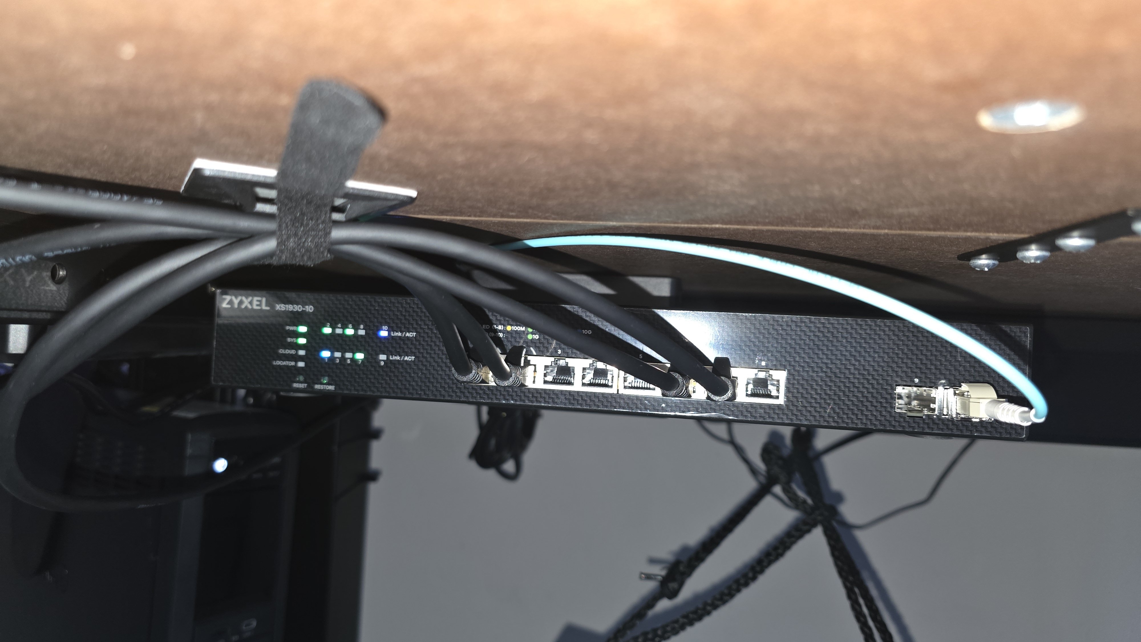

    Hello,
    1. The switch is mounted underneath my desk, and has ventilation on all sides.
    2. The room temperature is always 24C/76F.
    3. Photo is attached. There is x1-2.5Gbps link, x3-1Gbps link, x1-10Gbps link
    4. No copper SFP, but I do use a MM/SR SFP. The SFP itself isn't very hot.
    This switch connects to an upstream 1930-12 and that switch doesn't run hot at all. On the 1930-10, I can feel the fan blowing on the left side and the air it's exhausting isn't hot. It's only a particular area on the underside that is hot, the rest of the bottom (and the rest of the chassis) is fine. My guess is that something inside is using the chassis as a heat sink….or some component is working too hard.

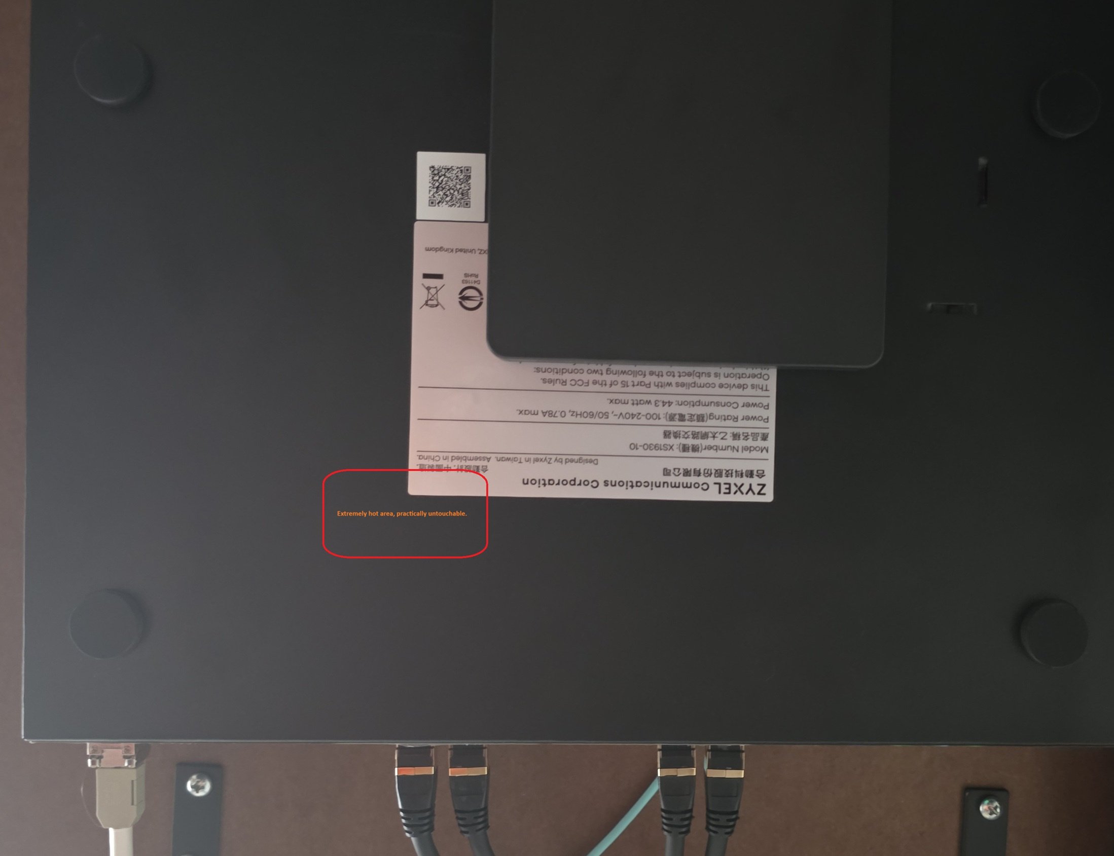

    This is the general area where it's excessively hot and only this area along the bottom of the label. The rest of the bottom feels normal.

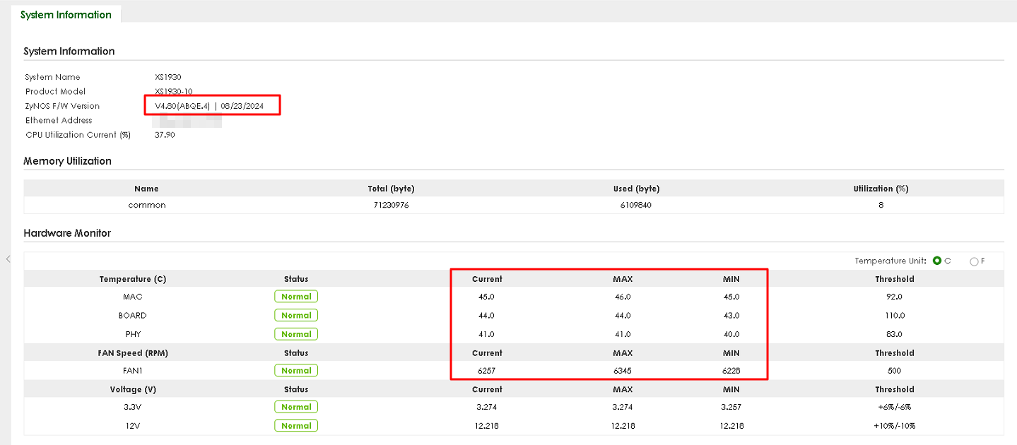

    First, the device's temperature is still normal since it doesn't go over the threshold. However, the fan speed seems lower than expect. Could you help to upgrade your firmware to the latest version? Because my lab XS1930 with 4.80 patch 4 have higher FAN speed (around 6200 RPM) and the lower temperature.

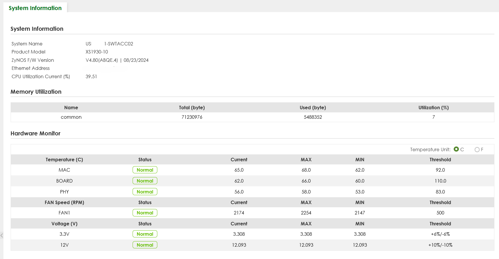

    I did upgrade, but the fan speed is still ~2000 RPM. In your lab switch, does it get very hot on the underside near the corner the label (closest to the SFP)? Mine is so hot, you cannot touch it for more than a second. However, mine is also ~20C hotter than yours.

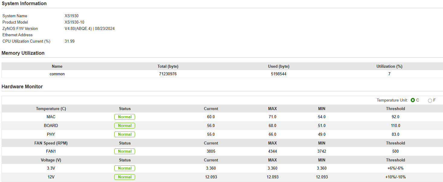

    Fan speed seems to be auto my XS1930-10 runs hot but then the way its in my rack is FLEX200 then XS1930-10 no space and above that patch panel
    Here is just coming up to 400 days uptime
