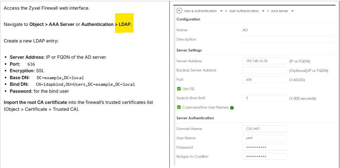

    Tried to follow that guide too, but something is missing here for me:

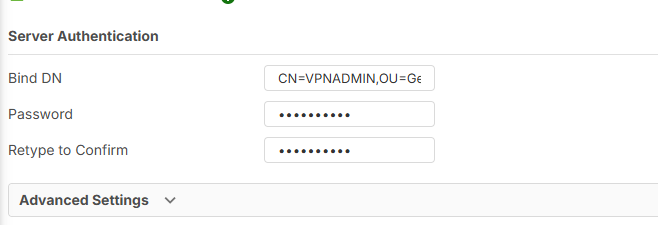

    I don't have the possibility to enter my username, so tried just the Bind DN, but that's not working.
  • zyman2008
    zyman2008 Posts: 251
    50 Answers First Comment Friend Collector Ninth Anniversary
    image  Master Member

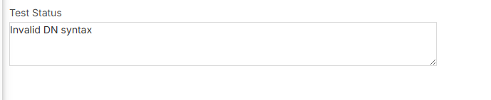

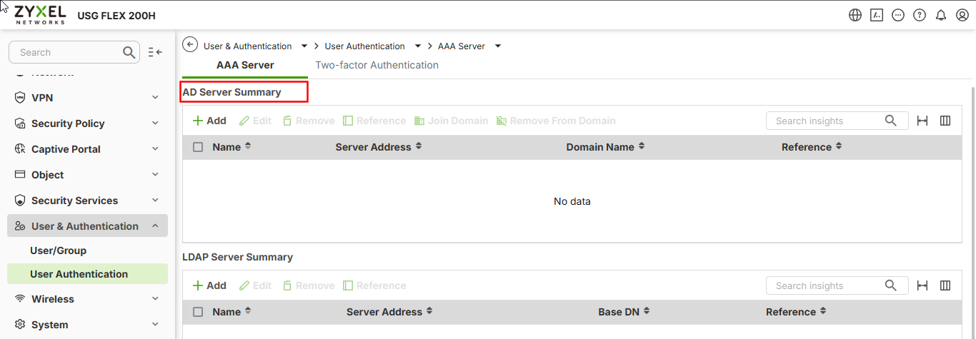

    That's weird… In the manual it clearly says, go to LDAP
    But ok, Tried now through AD and tested my account and I get Invalid DN Syntax.
    I Think it has something to do with my certificate. I've exported it in computer certificates with default settings and imported it in Trusted Certificates.
    The Bind user I created in AD I delegated control on OU where my VPN Users group is in.
