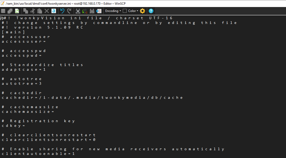

The timestap is 02.jan.2024 dunno if it is relevant. Editing the files shows what it this files should contain like as attached.
That looks like an valid wide-character text file shown in a viewer without wide-byte capability.
